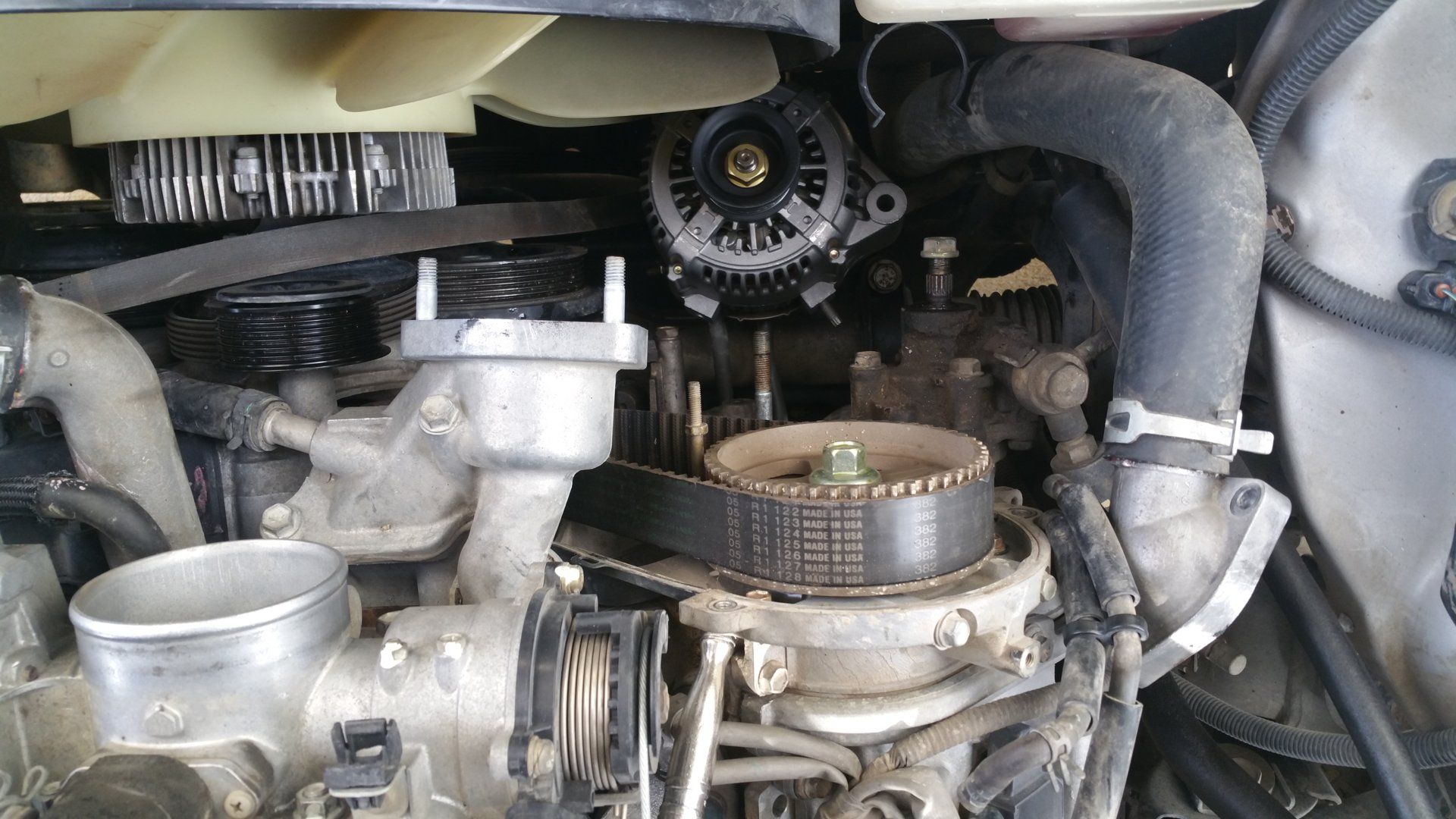

Doing alternator is easy from the top, no need to get under. Here's my summary.
I took my chances and i did it on the super cheap...
Sequoia 150A from a crashed truck = $60
Came with the square connector and everything..
The installation is cramp (I was not Able to lift the front end a foot or so what will had helped a lot) But is not a difficult job even with big clumsy hands..
