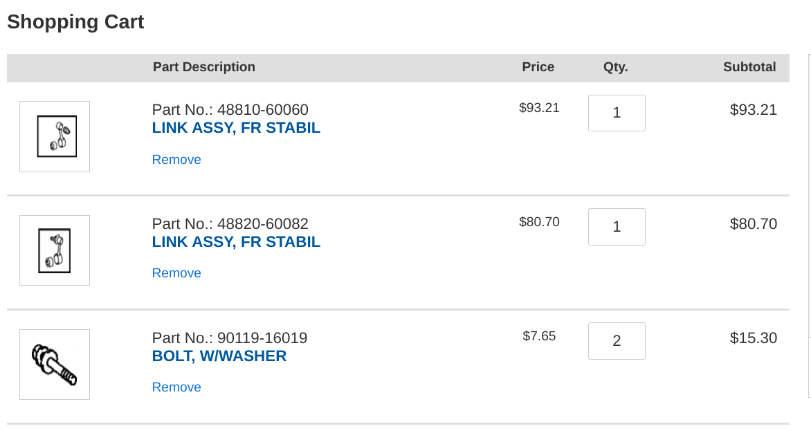

I need to replace my front end stabilizer bar links on my 2015 and could use some help identifying the needed parts. As of now, I have the following in my cart, but I think I also need an additional nut and bolt for the upper connection to the stabilizer bar on the driver's side. Does anyone know the part number or description for that? I cannot seem to find it. I'm also taking a guess that the bolt listed below is the same needed for the driver and passenger sides.

Unless you are heavily corroded the upper driver’s side hardware is usually reusable.
OK - that's good to know. Generally I like to go ahead and replace bolts and whatnot whenever and wherever I can - but I can't find that part anywhere.
The bolt is 90119-14134
Nut 94151-21401
The nut is the same part number as the upper on the passenger side, so you could get two if you want all-new hardware for your sway bar end links.
Oh man - thanks! I've been looking for that forever. Huge help.
