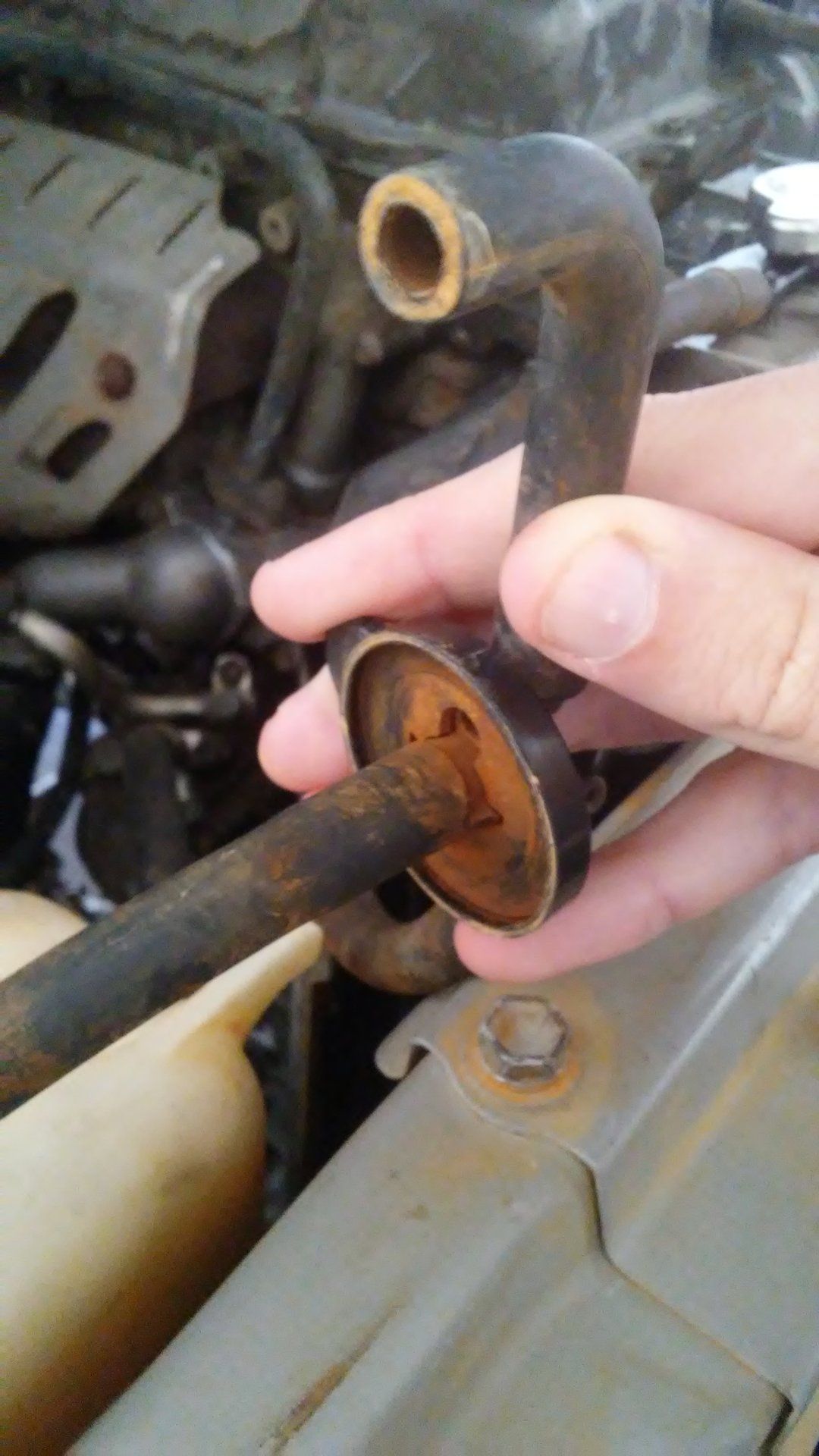

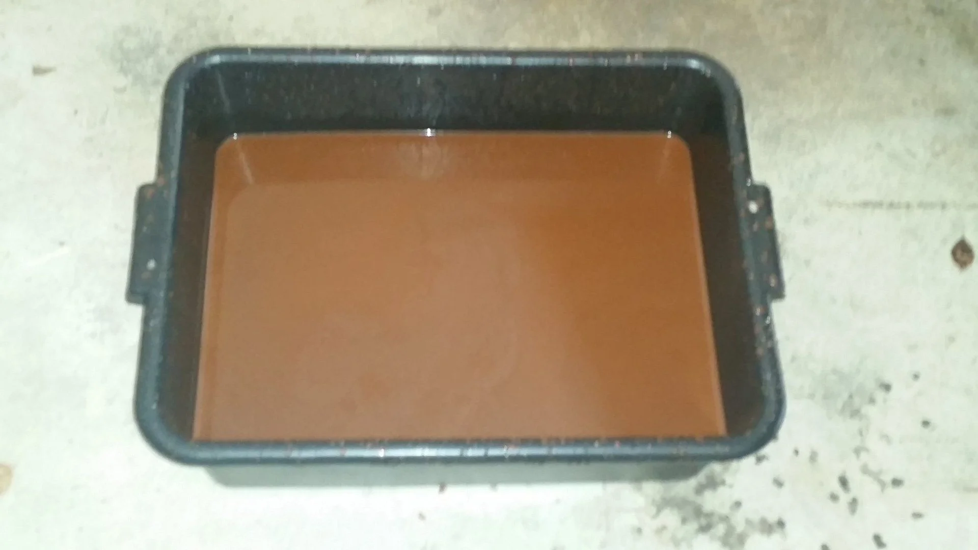

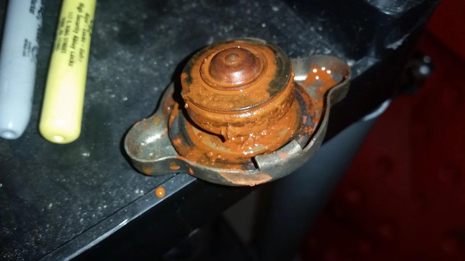

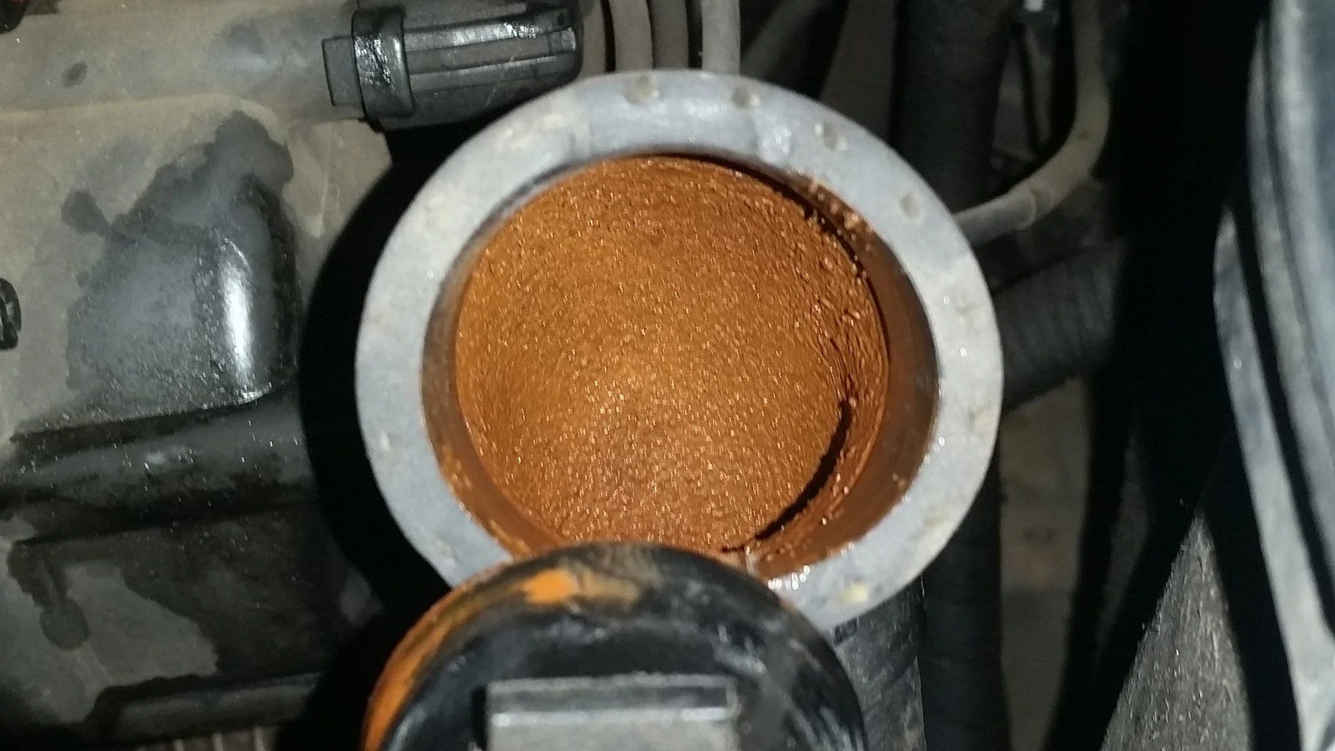

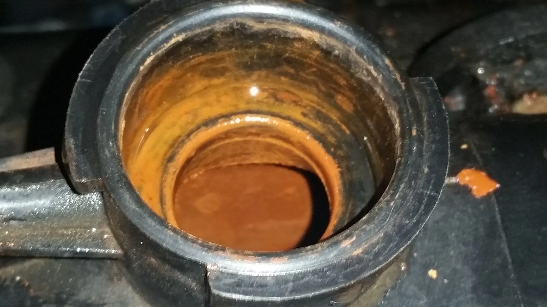

I had a similar or same issue. Have you had any of the radiator hoses off? Check the aluminum piping to see if there is residue there as well. I ended up having to get all new hoses, new radiator, new aluminum elbows and a new overflow tank as well. I still get some residual brown from the heater core I assume, but I'm not digging that out atm.
I assumed mine was from some type of stop leak put in the system by the PO, but the system was close to dry when I picked the truck up. Here are a few pics of what mine looked like.
My overflow cap looked exactly like yours does. I'm not saying you need to run out and get all new parts. My truck ran just fine with the old parts, the coolant was just always brown.
Flush ASAP
Wow that is WAY worse than mine. My coolant is still green, there is just a small thin layer of gunky stuff scattered on like 50% of the walls of the overflow tank, above the coolant level. And the cap was never gunked up like that, even before the radiator swap (I noticed the red, but since coolant was red, I figured it was that, and was also naive about it I think).
