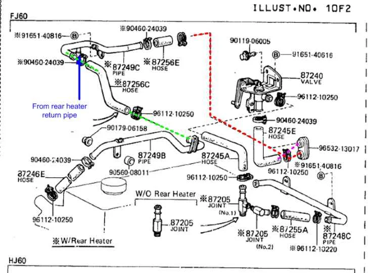

Hose 87245E is the hose giving me the problems. Does that hose run into the cab or attach right at the firewall?

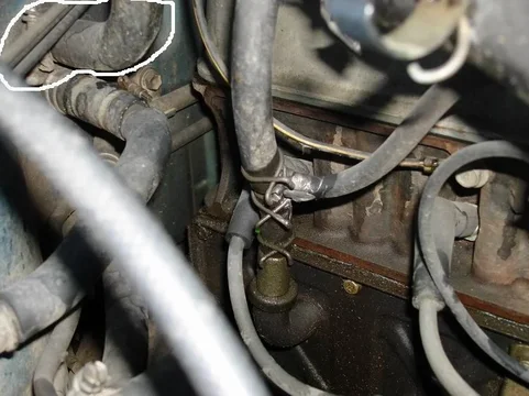

Here is another pic (not the best) of the bottom of the hose running into the firewall.Resize of Albino Rhino 003.webp

hey 2mbb thanks. And also thank you for letting me "borrow" the schematic from a post you had back in 05. I will try and replace the hose and hopefully that will fix it, otherwise I need to find one from someone parting out. These things are like $80 on SOR. Everyone was freaking me out with talk of having to get into the dash..... which I am sure will have to be done eventually since this is an 81.

even if the hoses look good from the outside, they may not be as they rot from the inside out. bite the bullet and swap them out with OEM or equivalent. won't be that bad a job, maybe two bananas, just have a little patience. use new clamps as well.

I found when I started removing heater hoses that the metal tube that it's attached to is hopelessly corroded and partly disintegrated when I removed the rubber hose from it. Be ready to order/repair the hardpipes in the system the same time you change the hoses.
For instance, I totally removed the route to my EFI throttle body because (a) it was totally plugged and (b) it doesn't get cold enough here to need it.
Note the short bypass on the left side of the thermostat housing:
Well I changed the bottom hose and it wasnt that bad. Hopefully that is all I will have to do, but might have to replace the top hose as well. If that doesnt do the job, then I am not sure where to go from there.
