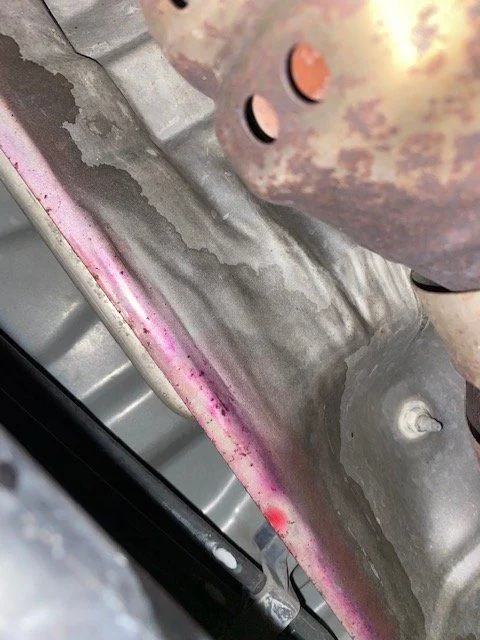

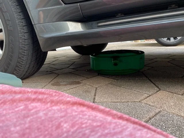

Recently did timing belt/water pump/power steering pump/radiator change. I think finally everything under the engine is dry but I'm now getting a coolant leak now right under the driver side door which is really strange unless is running down some channel from some mystery leak that I can't see. Water pump seal seems dry and all hoses and thermostat is dry top and bottom.
Any thoughts and ideas are welcome. She runs great.
Heater Ts or their hoses. There are also two coolant hoses above the driver side cat converter that go to the rear heater. Plus the oil cooler hoses on driver side of engine block.
That looks like its coming from the heater T area. It can flow all the way down to the catalytic converter potentially ruining it or cause premature failure (by throwing a CEL on your dash).
