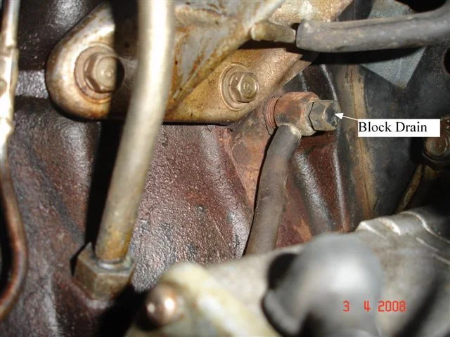

Any tips/ tricks? Im heading to Colorado in 2 weeks and am going to do a thermostat change and figured I might as well drain and replace the coolant while I am at it. I dont have any temp problems but the coolant looks old and I have no idea how old the thermostat is. Seeing how I am going to be pushing big passes that its not used to, I am airing on the side of caution and making sure that everything is tip top. Its an 83 BJ60, no a/c and no rear heat BUT it does have the lines and everything that runs under the truck to where it would be and then loops back to the engine compartment.

Drain the block via the drain cock there (and you may need to work something into the outlet to free the crud).
Flush the system with a hose till clear water exits (from both the radiator drain cock and the block drain cock).
