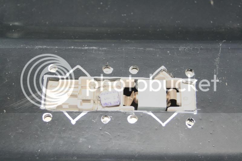

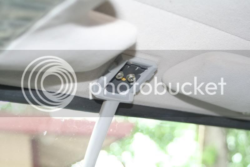

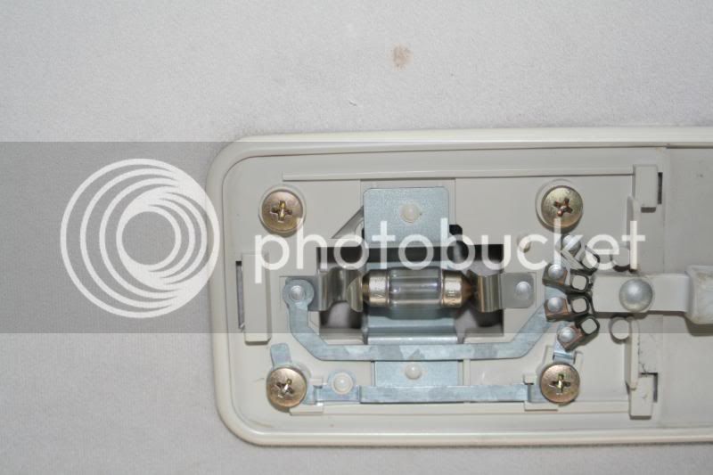

First remove the covers to the rear view mirror and door light:
After removing those match up the light to the console and decide what holes need to be drilled. There is a nice set of markings noting where the holes should go. The center needs to be cut out so the light fits flush:

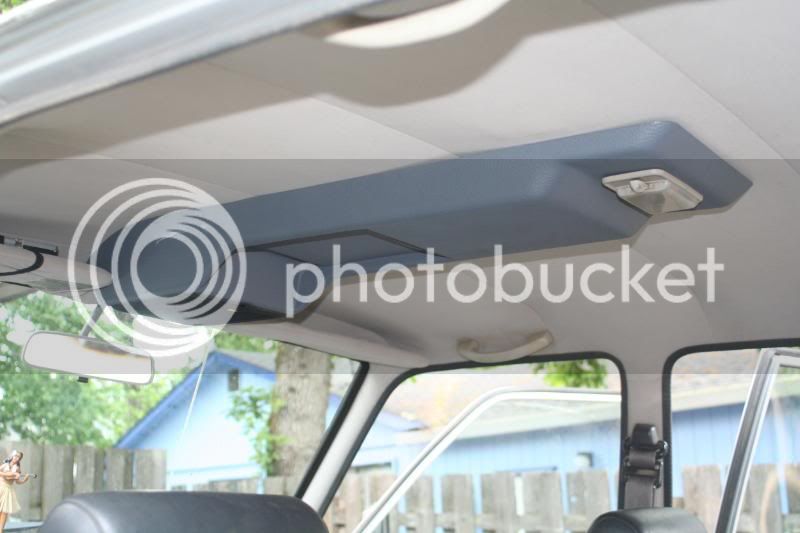

The dremel works well here. Sorry I don't have pics but will update later of the wood peice but I will try to explain it. The wood peice has similar markings and needs to be cut out for the light as well. Here is the tricky part. The console is actually about 2" longer than the stock mount will allow. The wood is there to mount to the roof then the console secures to the wood block. It doesn't seem to be the best set up but does seem to be a fairly solid mount. The front of the console screws into the rear view mirror mounts and the cover slides right in place.
I have only the courtesy light hooked up now but plan on adding a mag light mount, PIAA reading light, CB radio and overhead DVD for the boys. Those will be updated as they evolve. Here are the finished install pics. It fits well with just a small gap that will snug up when I secure the wood block to the roof a bit better.
