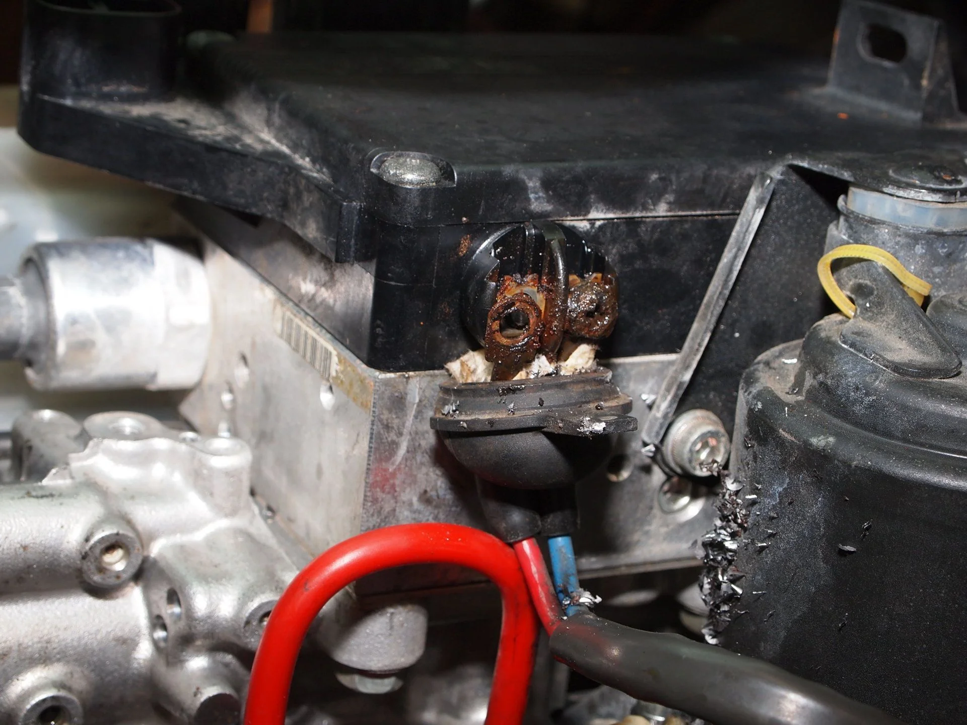

IF it passes this test....then you know the system is 'capable' of supplying enough fluid pressure for your brakes to work properly. BUT it doesn't yet mean it will do it every time. As these systems age....it is common for the brushes in the booster motor to wear. Also look under the rubber caps of both wire harness leads (one at the motor, one at the ABS unit) and look for corrosion.

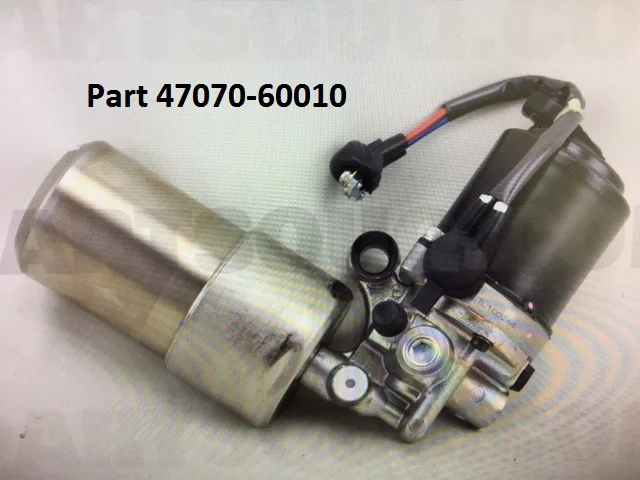

There is a person/company that sells just the motor. However....it is better to replace the motor and accumulator as a pair...since the accumulator is the second most common thing to fail.
