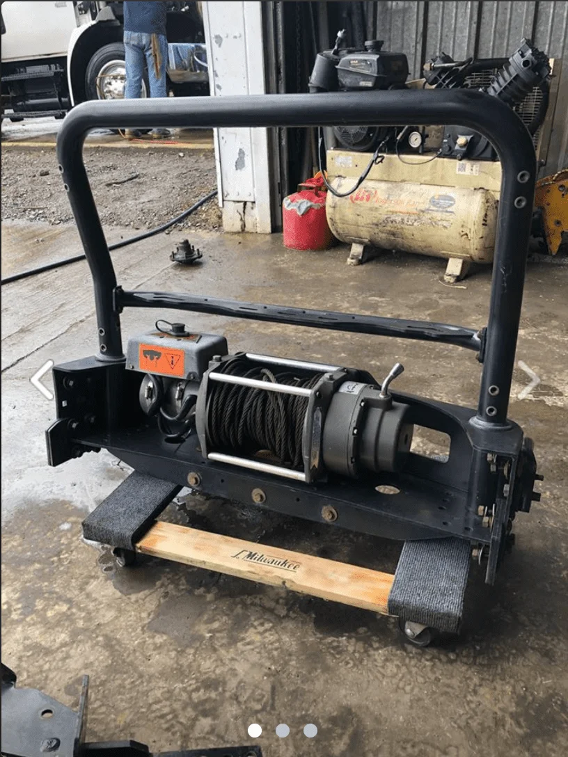

Here it is.
I hate to post a "should I buy this" thread, but my winch knowledge is zero, and the seller takes a long time to respond to questions and doesn't have a lot of info. I'll be in their neck of the woods on Sunday (bout 1.5 hrs from my house) and thought I'd take cash with me and pick it up if it looks like a good deal. Price seems ok considering I could sell the bumper it's attached to and recoup some $$$. It's going in my ARB bull bar on my FZJ80. Any thoughts, concerns or red flags would be very much appreciated from the more knowledgeable folks.

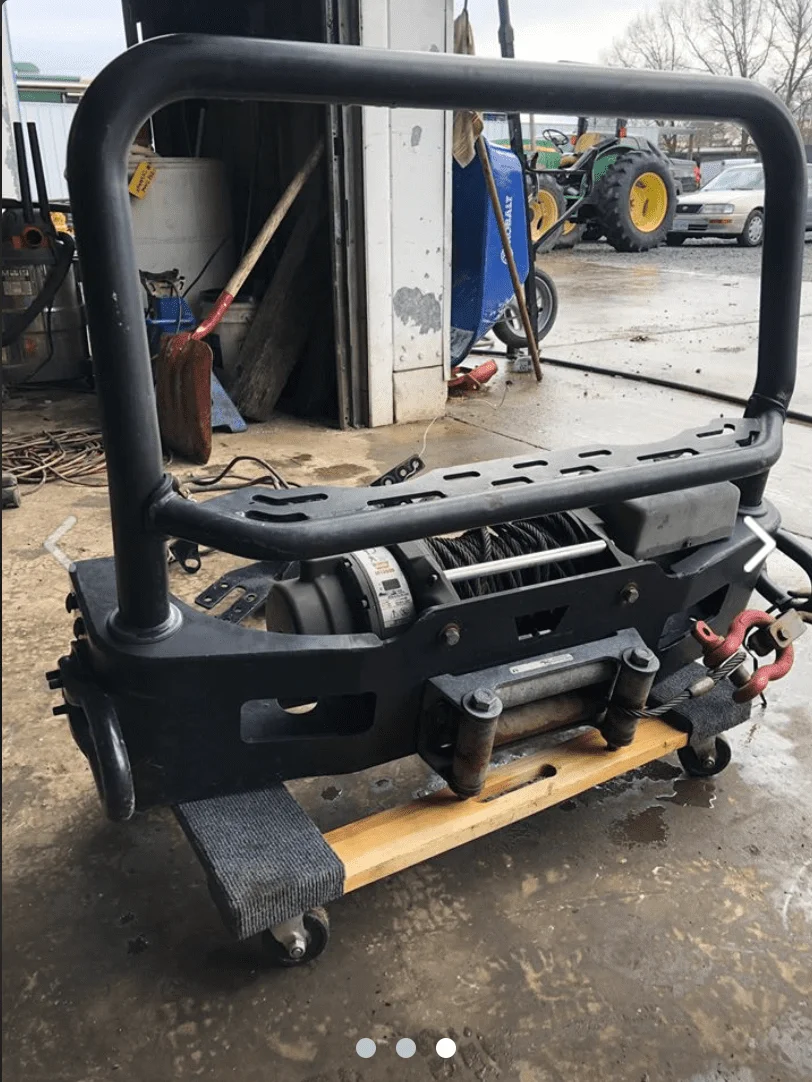

heads up, that looks ALOT like an industrial series winch on a Warn Transformer winch tray. The industrial series winches DO NOT have the same bolt pattern as a M12000. Note that they have bolt holes for both forward and down. 6 holes in total. They have a different brake system and are made for tow trucks. the fairlead may also be a nonstandard pattern. I say this because it likely will not work on your existing bumper.
that doesn’t look like an M12000. I have both and M15000 and an industrial series 15. That looks like the latter.

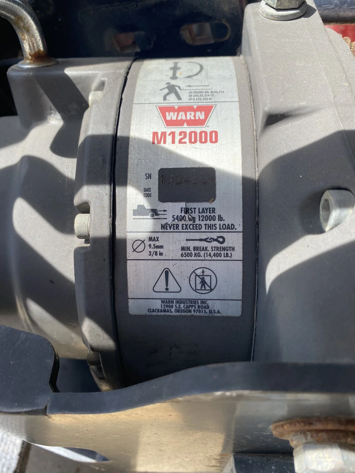

Thanks for the info and the heads up. I looked a little closer at it and it looks like the label would indicate its an M12000. If you zoom into the FB marketplace photos you can barely make out the all red letters of M12000. Whereas it looks to me (via warns website) that the Series 12 label would be in black letters and non bolded. Now, depending on age, this could be wrong and admittedly I know nothing about the history of warn winches. I will ask to confirm just o be sure. Its being listed by a woman for a man, so everytime I ask a question she has to get ahold of him and a day later I get a "he said he wasnt sure" type answer. I may just bypass this and buy a new one to be sure.

FWIW, that is definitely a Warn Trans4mer tray, and those can be expensive. You could sell that separately. You just need the brackets that match to the specific truck. The large hoop and the light mounting bar are also sold separately by Warn.
Thanks for the pics. Dang, so hard to tell. They changed the labels and covers so often over the years that its almost impossible to match it up. I see what you're saying though. I'm leaning a little more towards M12000 if for no other reason than the owner said "he doesnt know what year it is but said its an M12000." Tough to tell without driving out there and measuring the bolt holes.

Ask for a pic of the entire label , mine says series 12 where it would say m12 if that's what it is.

Was able to speak with the seller and asked for a pic of the label. Definitely an M12000. The owner says it works well. It might not be the best deal on the planet, but it seems like it's not the worst. And if I could recoup some costs with the bumper then I think it's worth it. Still saves 700 over buying new.
