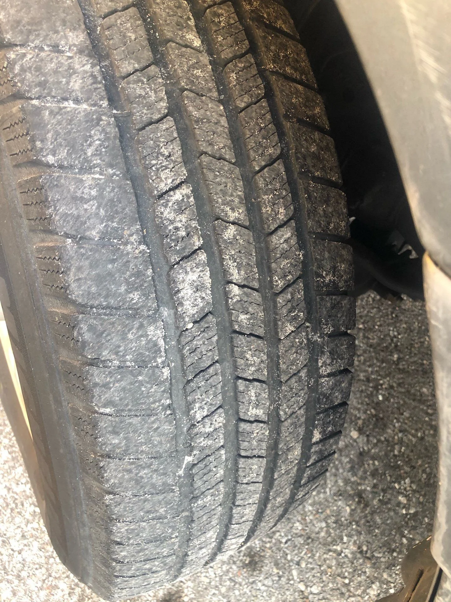

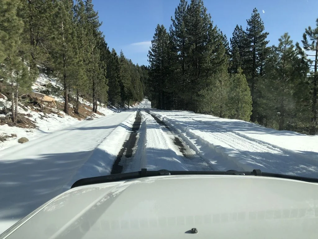

2. Here's where I am (11/2020). Traded the 17s for 18s and they came with new (little) tires! 275/60/18 (30.9", 37 lbs). Fine for family fire roads. Not so fine when the snow got deep (no pics almost stuck).

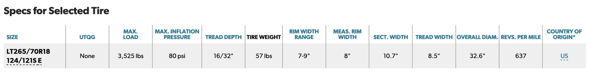

I went with 265 70/18 BFG (P-rated) rugged terrain - after blowing out 2 in 4000 miles, I was given warranty/replacement credit on Michelin LT 265 70/18. I have about 115k on these and need replacement soon. One thing I noticed is that moving from the P rated to LT(E) rated tires, the truck became a little more sluggish - must be the weight difference the diameter is the same. Ride is harsher on rough pavement too.
Looking for replacements now, might go back to P rated 265’s or 275’s (not many offered). Do not want to decrease mileage so have to stay away from heavier, wider, tires. Nitto TG’s come in P rated 265/70/18 at 42.3 lbs (Ridge Grapplers/LT are 55.4 lbs). Falken Wildpeaks P-rated - 46.7 lbs LT rated (same size) are 59 lbs.

Update: Nitto Terra Grapplers in LT 265’s are only 44 lbs. LT275’s are 52.2 lbs and half inch taller. Leaning towards the LT 265’s, worried about popping P tires!

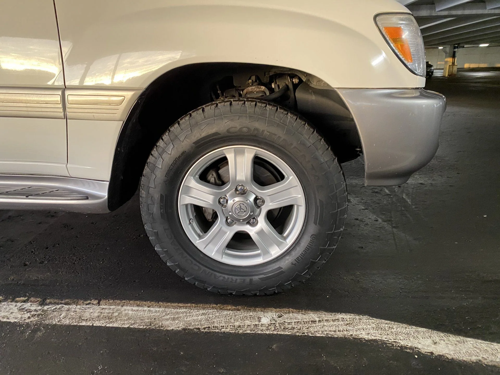

I am running 265/70-18 Continental TerrainContact and prefer the near 33 height with the slightly less width to protect from stone issues and such. The Continentals do get very good reviews from the OJ folks on their G-wagon and I’d have to agree.
That is a good looking setup. Did the spare fit underneath (assuming full size spare and stock hitch)? They're the same diameter as the KO2 for the size which is super helpful to see. Much obliged.
