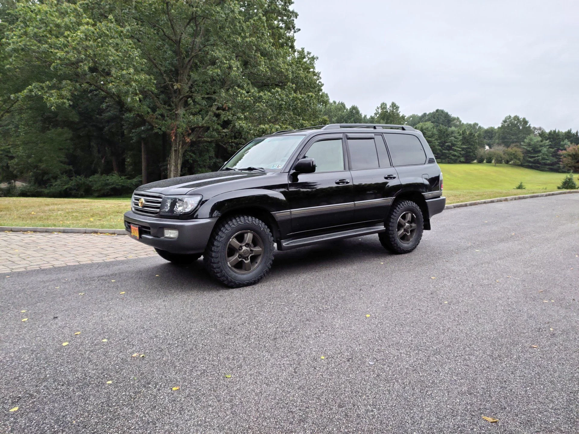

Got the car back this morning -- tires look mean. 275/70/R18 is a noticeable change. No Ragrets not getting 295/70/R18
Looks good!
Sighhhhhh....running boards.:) I’m totally kidding I actually miss my running boards. Your cruiser is fire!
That side wall looks great. Is your truck lifted or this is sitting on stock suspension?
Only lift is 1.5" medium duty OME rear coil springs. Bilstein 4600s

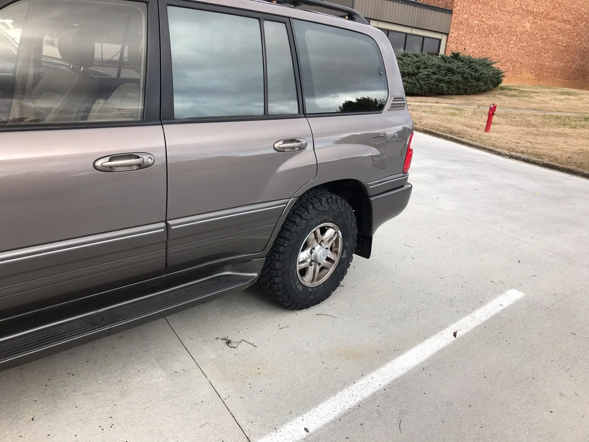

Thanks for all of the input. Well I ended up going with a 265/75 R16 BF Goodrich KO2. I didn't go 285/75 R16 because my height control is wonky and sometimes runs on the low setting up front and I didn't want to jam too much in there. Kind of wish that I would have but was worried about spending more money than the $1250 for the (5) tires. I have about 150 miles on them now and am relatively happy with their on road performance (not as good as the Michelin M/S 2 for noise). Anxious to get off road. Pictures are with the height control set on normal.

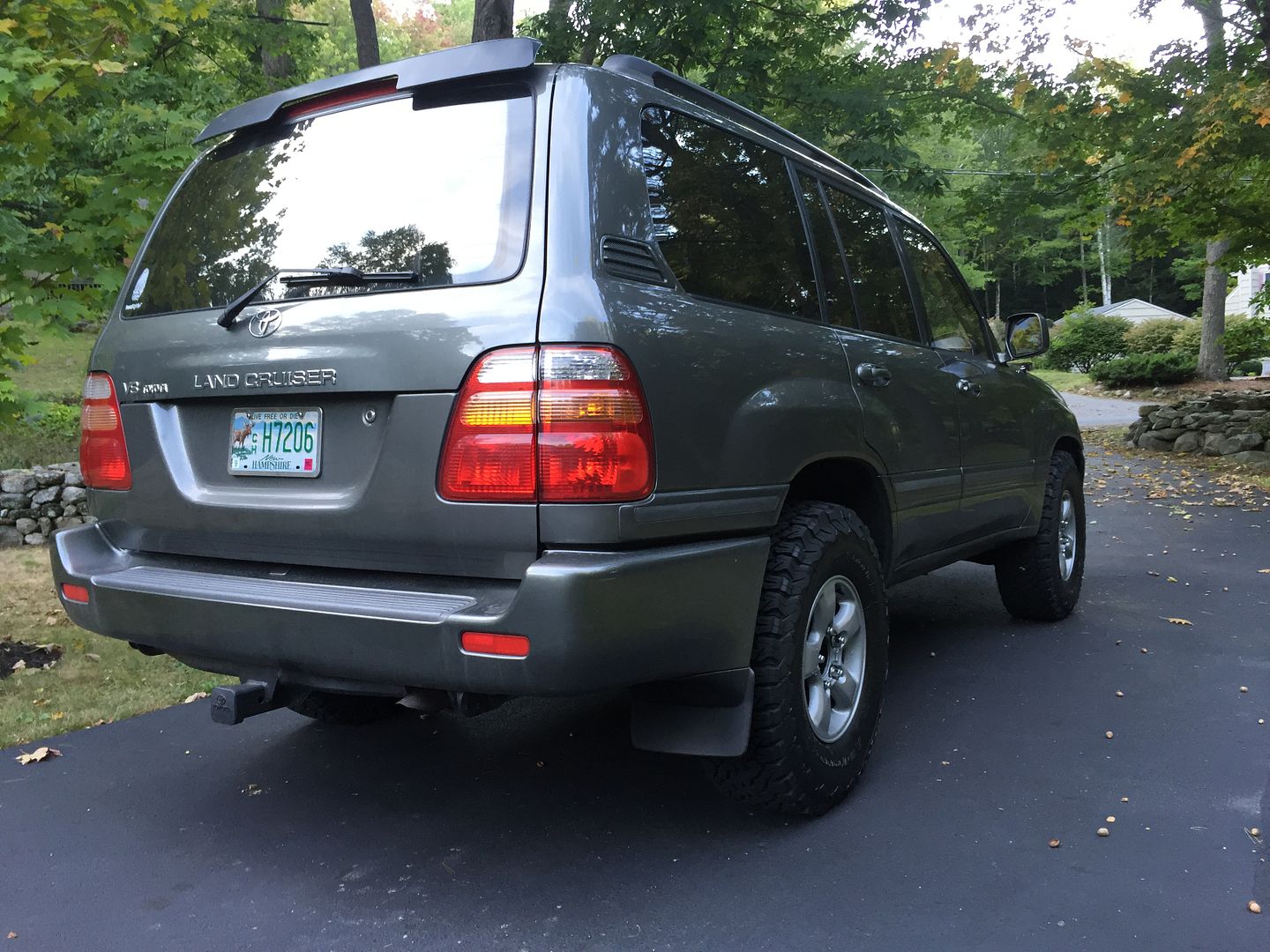

Discount also said I'd have to remove front mud flaps to fit 295 Toyos. I said, no they will fit stock un-lifted. 295s are the ticket for non spacer and unlifted.

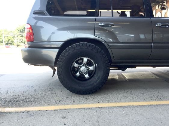

I'm running 275/70/18 Michelins...only a very slight AHC lift
No problems at all.

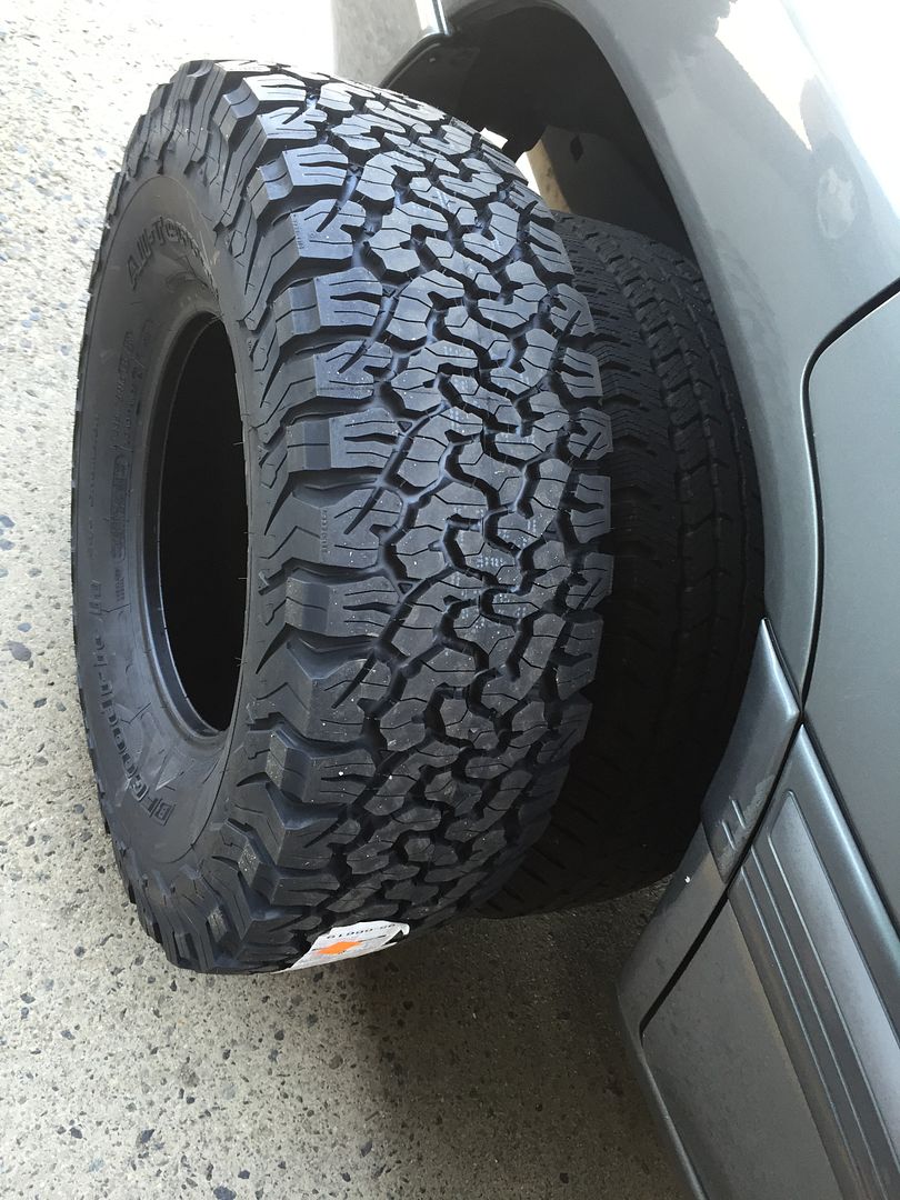

From a couple years back, but if anyone still wants to see a 100% stock (no lift) tire size upgrade to a 285. 2001 Land Cruiser
BEFORE:
DURING:
AFTER:
Only issue was a small interference on the lower spash guard at the outside edge. A gently heatgun application softened the plastic enough to flatten in out slightly and that's all that was required. Full lock-to-lock steering with no rubbing.
