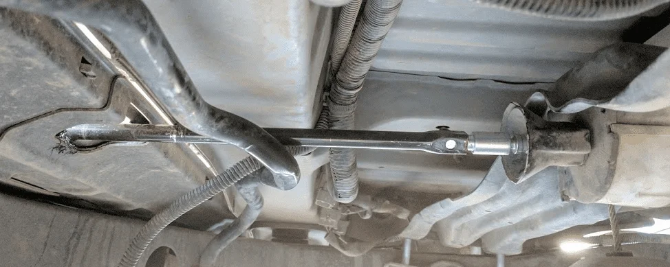

4. Here's where I went rogue. Instead of lowering the winch, which I didn't feel as good about from a stability perspective (plus I didn't have longer bolts and spacers handy), I angled it forward with 3 washers to point it down to where the lowering rod wanted it. Installing the washers was a PITA because of the limited space, but worked perfect. That wasn't enough though as now the lowering rod was jammed tight against the bumper, so, solution, trim the bumper! Used a rotozip on my drill and was 5sec job:
I cleaned up the cut after this pic, but almost looks factory, and MUCH easier to thread the u-joint in and out now.
Final angles are perfect:
And now I have my 285/75/16 sitting nice and high!
