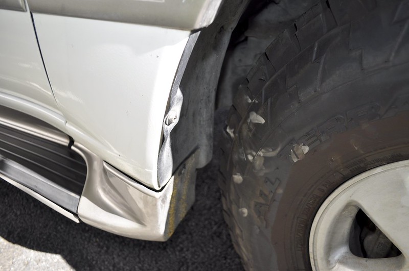

From a couple years back, but if anyone still wants to see a 100% stock (no lift) tire size upgrade to a 285. 2001 Land Cruiser
BEFORE:
DURING:
AFTER:
Only issue was a small interference on the lower spash guard at the outside edge. A gently heatgun application softened the plastic enough to flatten in out slightly and that's all that was required. Full lock-to-lock steering with no rubbing.
