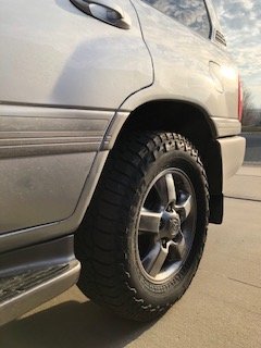

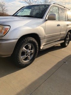

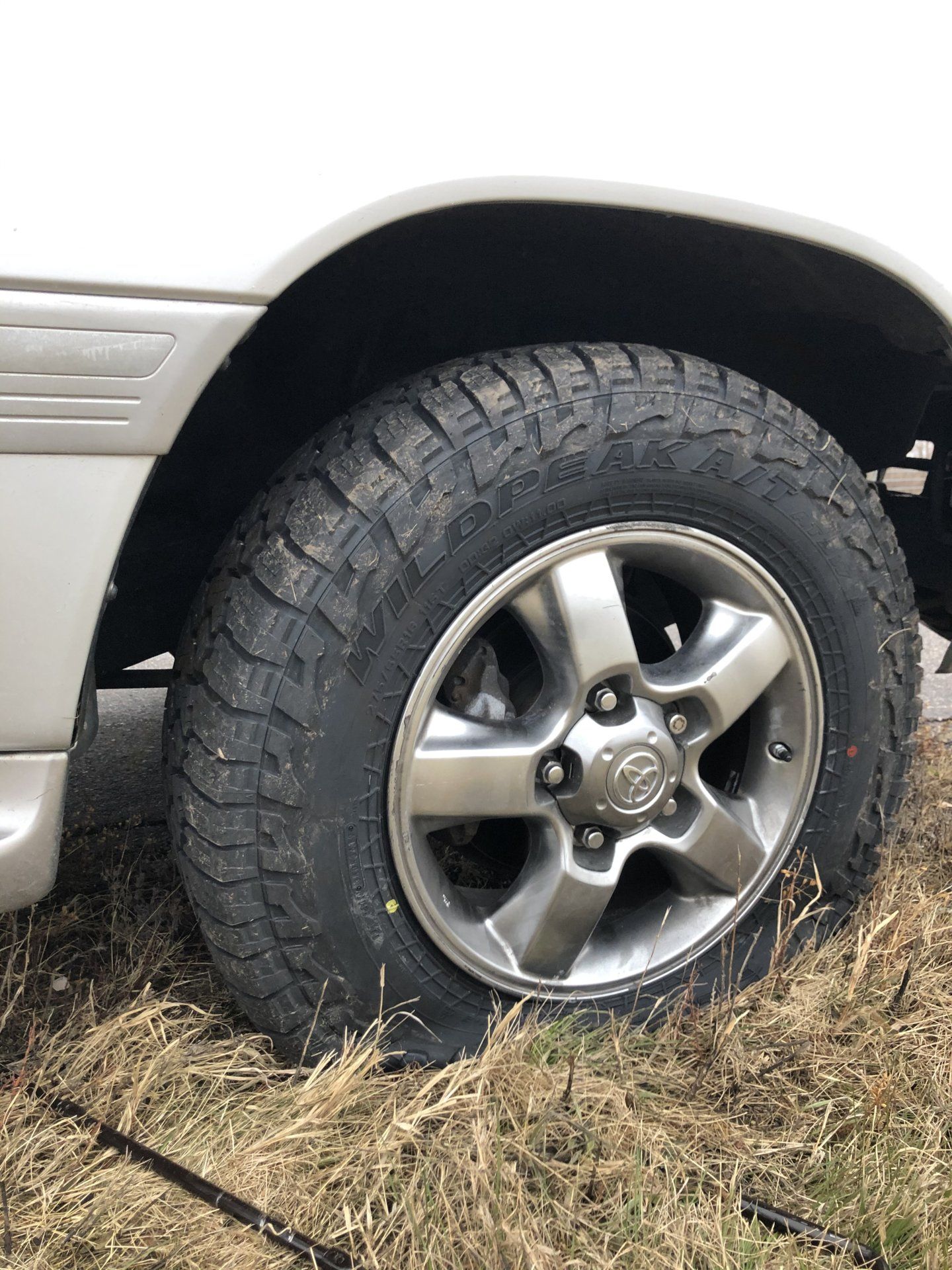

Falken WildPeak A/T3W 275/65R18 -- fianlly installed.
Those look good man. Did you go with P or E load rating?
I've been debating on which I should go with... I'm leaning toward P since my use will be mostly highway. But I'll also want to air down for soft beach driving.
