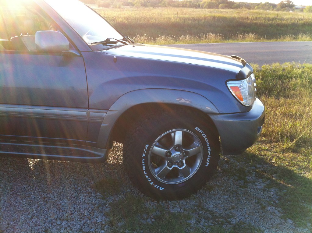

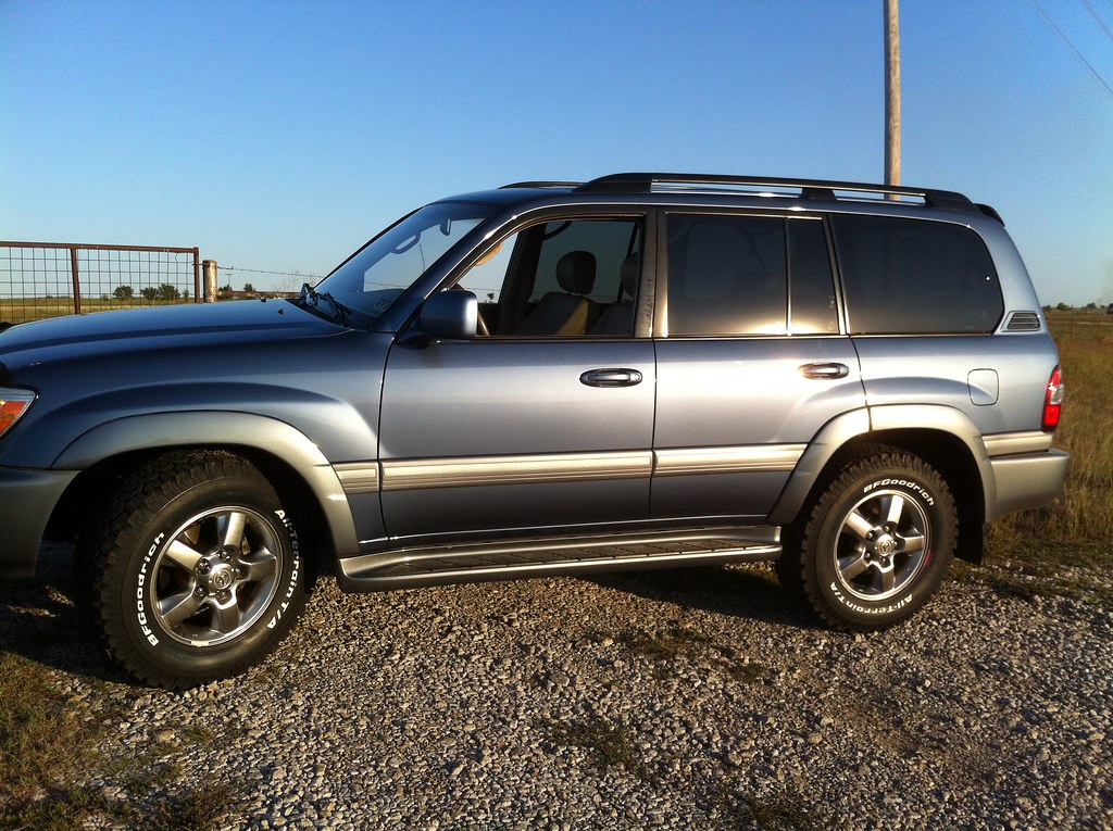

BFGoodrich just released the new KO2 AT in a 275 70R 18 this month. I mounted four of them today and even tested the spare tire location. There is a weird bracket that touches the tire, but does not affect the fit in the spare location. I have no idea what the purpose of that bracket is exactly.

I'm on my second set of 275/18/70 BFGs
