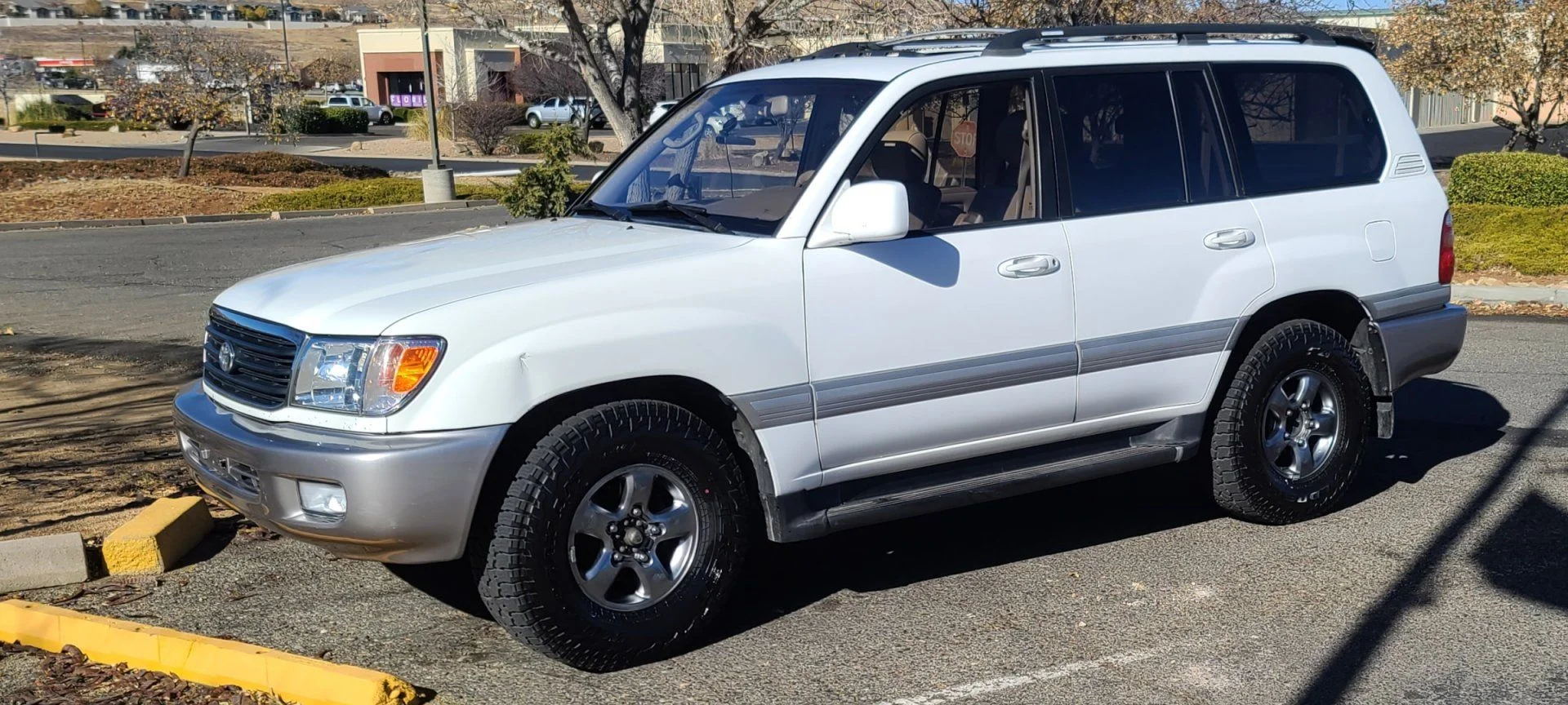

I ended up going with 17” Tundra Rock Warriors and having the bling rings deleted. 285/70’s suit my needs for now but I may go to 295’s in the future.
Dude those look so freaking good!
Wheel spacers?

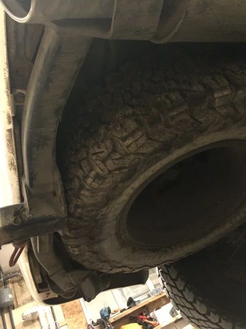

I was so dead set on 285s that I even have a 285 spare already under my truck (with the carrier mod) and then the wife and I go to Ocracoke a couple weeks ago and there was a guy with 295s and it just looked so nice, a little bit of a ballooning like a nice fat tire he said that was on the second set. He told me just get 865 OME springs, adjust your TBs and drive it!
Looks great. Any issue fitting a 285/70 spare in the factory location? Which 10 mm spacers did you use?
Spare is very close to the panhard rod but it fits. I have an aftermarket Draw Tite hitch, I’ve got a hunch that a factory hitch offers more clearance. Bora spacers.
