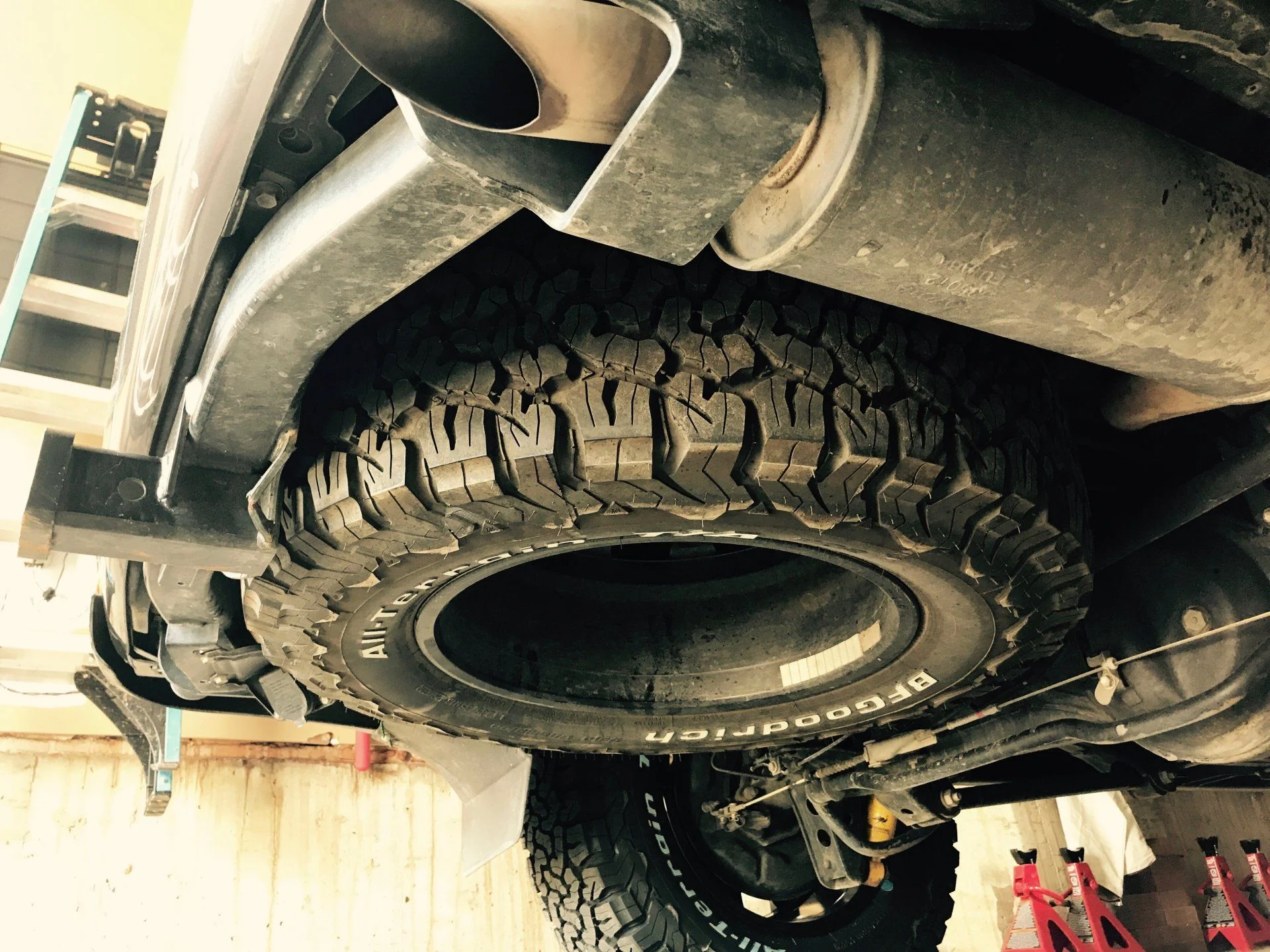

At work right now and dont have time to go out and measure, does anyone know if a 285 65 18 will fit underneath as a spare?
It'll fit. Running 285/65/r18 KO2's.

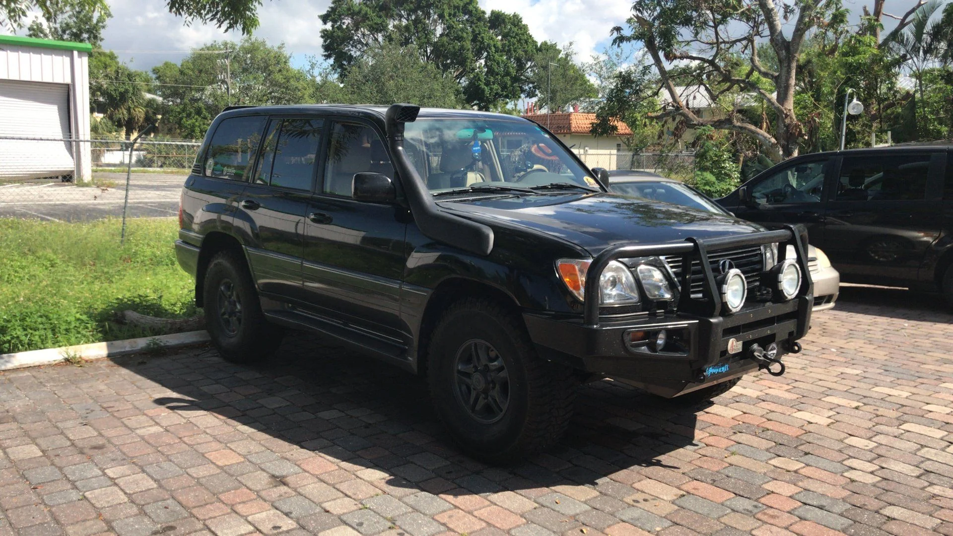

Well I have to say...315/75r16 , this pic is with the suspension in H position, but even in the N no rub, no nothing..View attachment 1556807

I want to get the Yokohama Geolander A/T GO15 tires in this size 275/70R18. I had the original rims sandblasted and painted black. But my worry would be if the spare tire would fit in the OEM place under the car.
Anybody has experience with this?

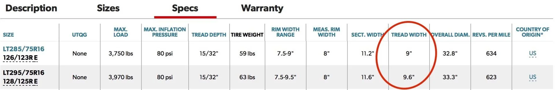

I've looked at the 285/75R16 and 295/75R16 KO2's, side by side and the difference in appearance is significant. The section width is 10mm wider at the sidewall but the tread width is 15mm wider... giving the tire, a more squared off look. 1/2" taller and 4 lbs heavier per tire as well. I like the idea of 295's and then running a 255/85R16 spare with the spare tire lift mod.
Is your truck lifted or any modification other than the tire?
