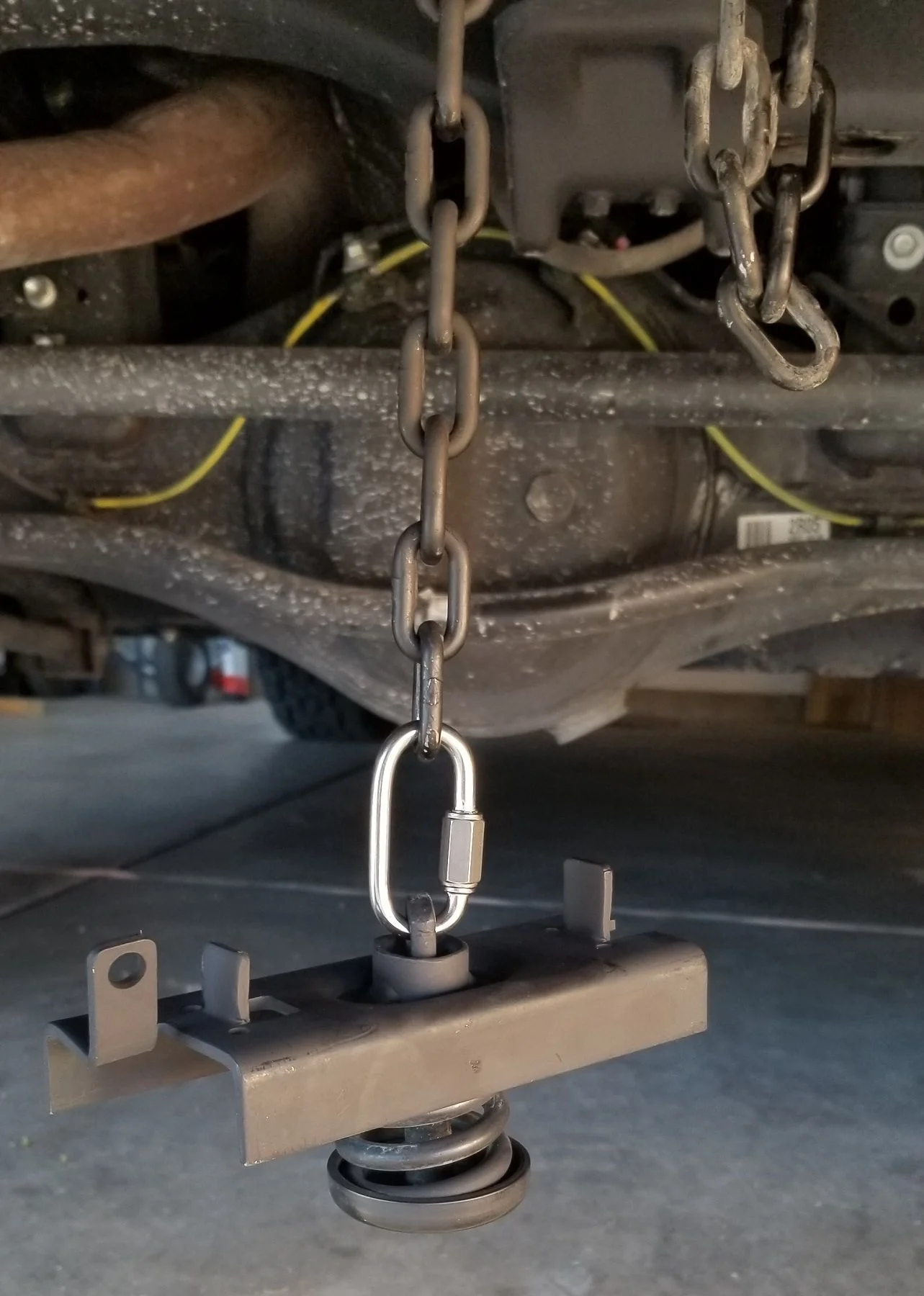

I was shortening the tube on the spare tire mount so it would fit through the Rock Warrior wheel.
In the process of cutting it I went through part of the chain link. Probably cut about half way into it.
How much will this compromise the strength of the chain?
I don't want the spare tire to drop down and bounce into someone's car.
Can that link be welded or is it a non issue for the weight of the tire even bouncing around on trails?
thanks for any advice.

I was thinking they would have to be the same size as the chain links (1 1/8 x 5/8) which anything in that size that I can find probably wouldn't bear the weight.
But I guess if I cut more of the tube off, I can actually reach the eye of the rod and use a larger one like the ones shown above.
Tomorrow I'll see if the alignment shop has a welder and if not, I will probably go this route.
Thanks.

I ended up cutting off that chain link, cutting more of the tube, then found a quick link at Home Depot that supports just under 1000. I had to drill out the eye on the rod going through the spring to get it to fit, but I think it should hold up fine.
Thanks for the ideas.

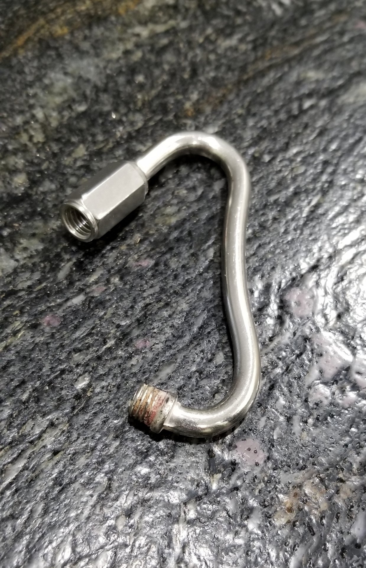

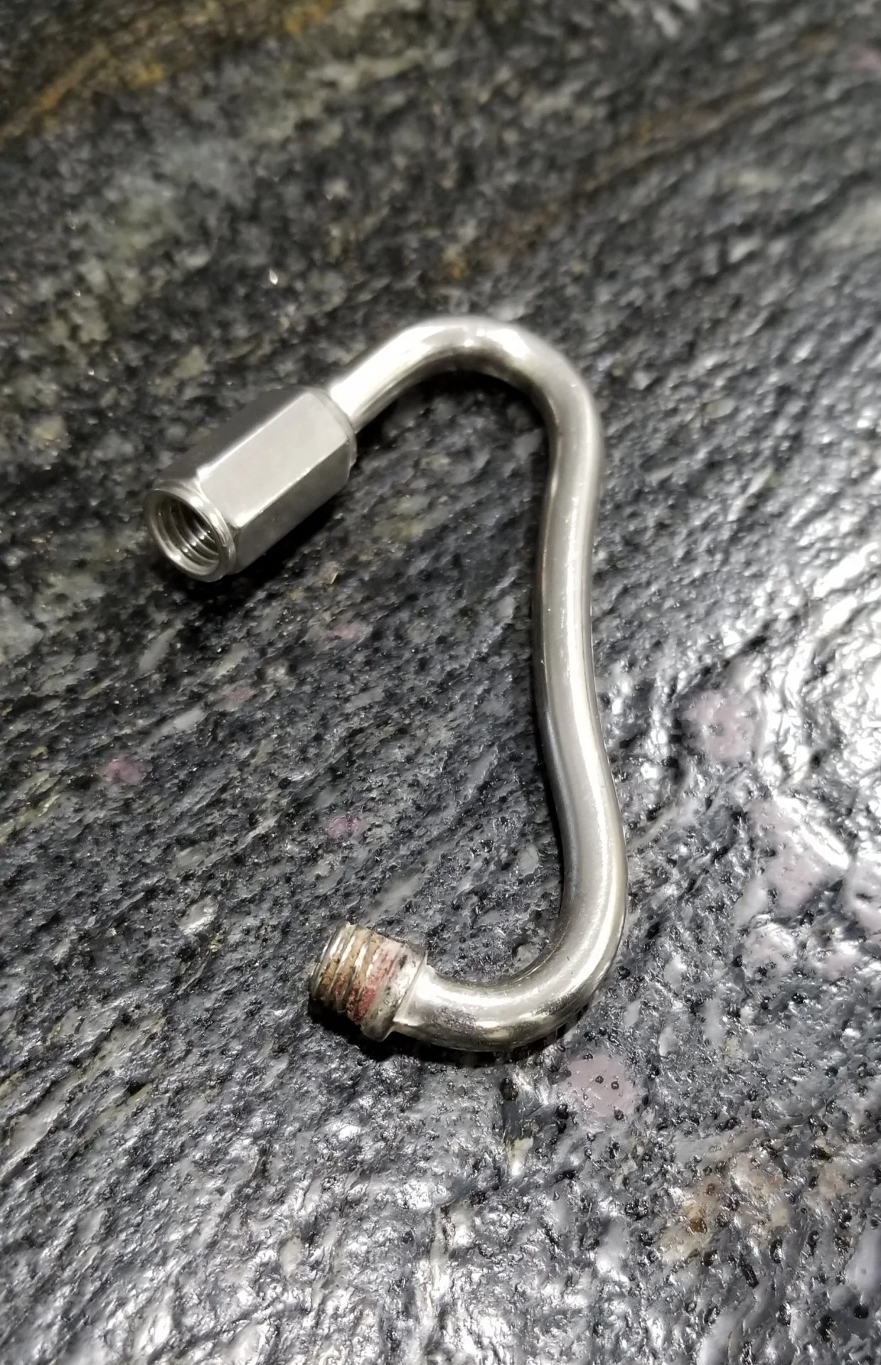

Thought I would update this. Although the quick link was rated for 900 lbs, it is not for overhead lifting. It will not support the weight of a wheel/tire combo.
This is what I found today when I dropped the spare tire down. I used red threadlock but it looks like it just stripped the threads right off. Not sure how long it has been this way but very glad my spare was still there.
I ended up bolting it to the chain. Hope that holds up better. Will have to check it more often.
Did you look into using a cold shut link to repair the chain?
A bolt is probably fine as long as it doesn't slip through the two links or comes unscrewed.
Did not know they existed.
The bolt attaches the chain to the eye of the holder. There are washers on both sides and it is a nyloc nut so hopefully it will hold. May add thread locker at some point.
