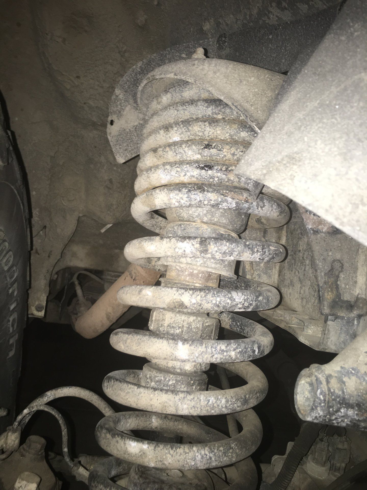

IIRC the FOR springs I saw in a photo of yours were a progressive style and the spring was wound using a wire of same diameter end to end.
The FOR are a dual rate coil, same diameter wind (not tapered). It was something like 170/260, but been too long for me to remember exactly.

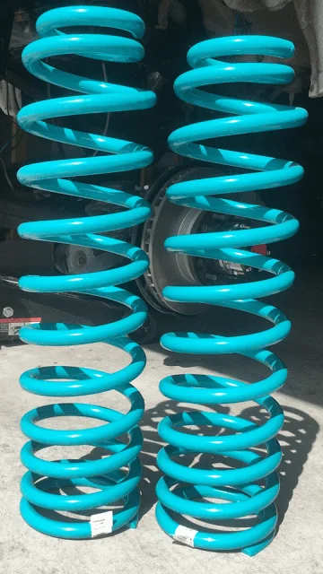

From GW’s initial post on this thread, the flexi look more like a progressive than dual rate looking at the bottom of the spring in this pic, these being the front springs.
I don’t know why Dobinson won’t publish their spring rates. I should know for the rear coils in a few days.

The flexi green coils appear to be of the same design as FOR in the photo above.

@Nay the green Dobinsons coil you pictured is going to be a dual rate. You have only two different pitches in the windings. It looks like the taller version of what I have on my truck.
That’s what I had thought in my first impressions, thanks for the confirmation.
