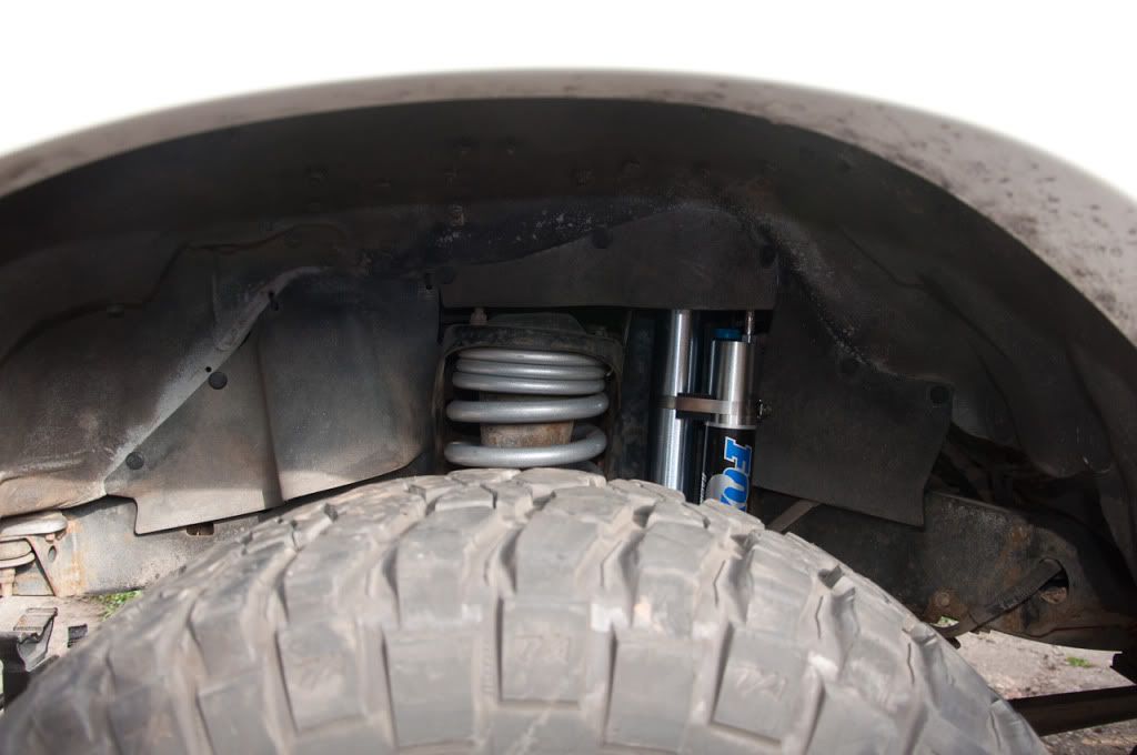

Anybody have free height length specs on the 4” rear flexi?
This coil looks to be very close to the FOR Gen II that I run that are about 20” free height in the rear.
I run eye adapters and use a 10” travel Fox 2.0 remote res shock that is 26.10 extended, so adding about an inch for the eye adapter (only the upper end gets converted) that’s about 27” total extended length, or more or less the Dobinson 4” lift shock.
I don’t need the tapered coil for more droop as my design is set up specifically to not add a lot of travel the front can’t use.
@baldilocks I’m not much concerned with the marketing - if the coil has a dead wind stack, it’s a dual rate coil. If the tail is tapered, the the tapered part is progressive as diameter decreases.
As to whether one does something the other does not outside of total free length, I’ve never seen a compelling argument. It’s just been that the taper by it’s progressive nature has a longer transition zone and the coil may be subjected to less stress and it may provide more of an unloaded to fully loaded sweet spot.
But 80’s are heavy and I’m not sure about the real world differences - as you noted above, you tried both without a meaningful distinction and it’s about netting out suspension height.
In my experience, the front is really easy to dial on a dual rate coil, but the rear less so. I’ve always felt my FOR Gen II could have been just a bit stiffer in the rear. It was really good and perhaps a price to pay for the design, but that’s why I’m going to do the swap on that end and see.

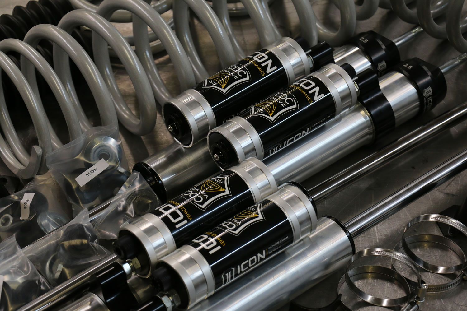

Some additional shock info on the Stage 1 Slinky shocks. As has been mentioned earlier, these are a 2.0 IFP shock. Full 12" travel and when paired with Slinky coils you can use every bit of the shock. Compared to the Slinky Stage 4 shocks which have 8 dampening settings, the Stage 1 shocks are the equivalent of a 4 setting on the Stage 4s.
Slinky Stage1 (front) vs OME L shock
Stage1 Slinky at full droop
Stage 1 Slinky (rear) vs OME L (old style)
Stage1 stone guards for rear shocks
Stage1 Slinky 75mm HD at ride height. On my truck this measured out very close to a true 3" lift.
Some info on the Stage4 Slinky shocks. The Stage4 shocks are a 2.5 with remote reservoir and CDC (compression dampening control) adjustment with 8 stiffness settings. 12" travel. Fronts have a true remote reservoir with bracket. Rears are a piggyback design reservoir. Rear shocks include shock boot and lower stone guards to protect shock shaft.
A number of things make the Stage 4 shocks unique and different from the Stage 1’s. First, it starts with a “flutter stack” in the valving to allow some movement of the shock shaft before full valving sets in. This provides a supple ride with a higher fast piston speed valving code.
Second, the Stage 4 shocks have adjustable Compression Dampening Control (“CDC”). The CDC secondary piston and valve stack stops the pintle style, restrictive “90 psi in the tires” feeling on sharp bumps when road driving and are typically less than half the line pressure of other adjustable shocks at fast piston speeds. There are 8 different adjustability settings. Changing the setting is a simple turn of a dial. Stage 1 shocks are the equivalent of a setting of 4 on the Stage 4 CDC adjustment dial. No tools are needed, so it’s easy to make changes and dial in your ride for different conditions or vehicle loads in a matter of seconds. Third, the Stage 4 Slinky shocks have a built in hydro bump zone at fast piston speed for when the piston goes past the top manifold.
