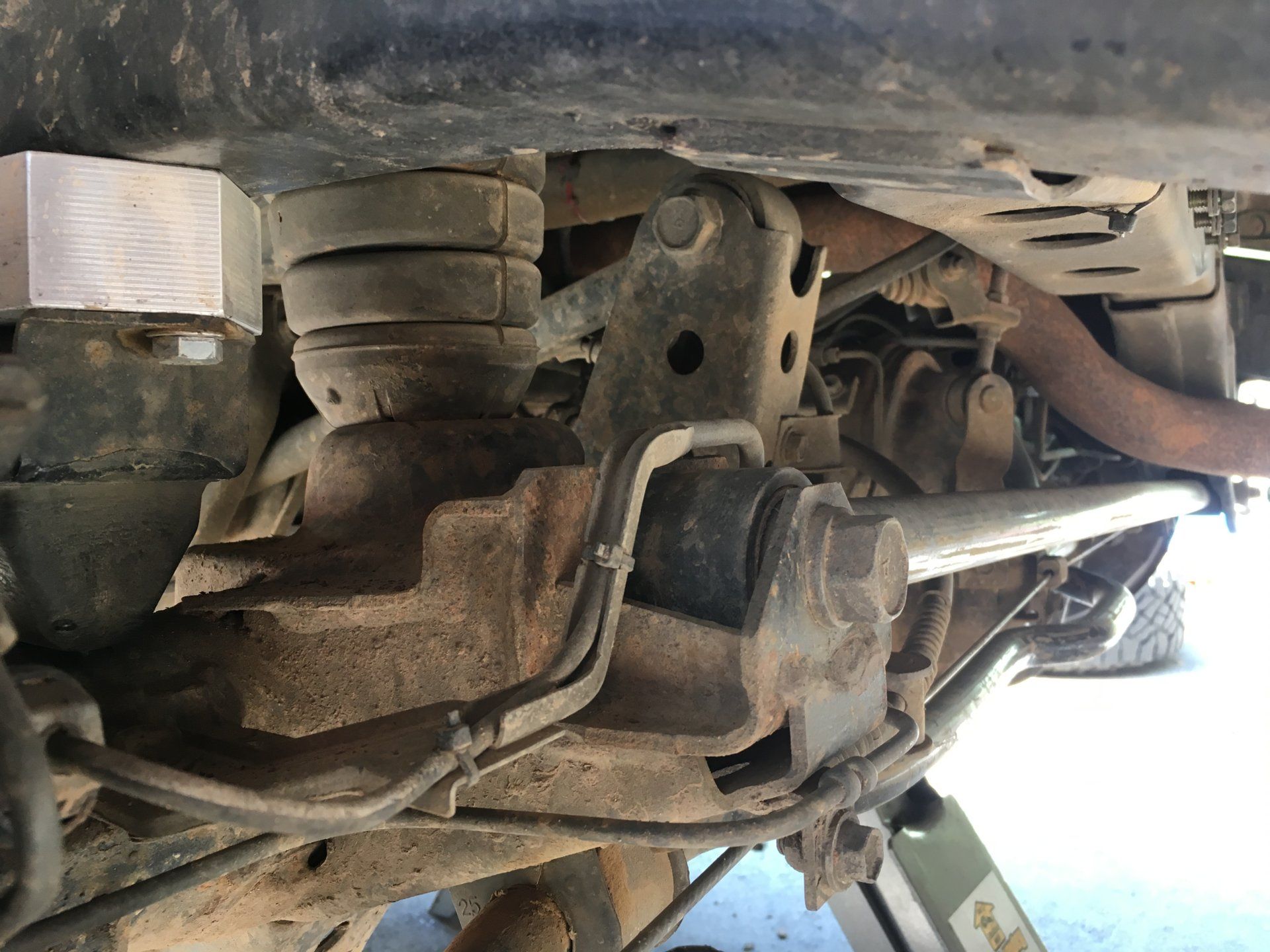

Also here’s the rear axle sitting on bumpstops +30mm (1.2”). Notice the coil bucket cushion touching at the same time. Take what you will from it. View attachment 1588359
The cone in the center of the coil acts as an overload or dual rate as well. With final stop being determined by the hard outer axle stop.
It wouldn't be a bad idea to move the center cone down the same as the outer stop.
I've rate tested just the center cone to see what kind of forces it makes, I don't remember the #'s off hand but it was a nice overload, acts as a spring more then a stop
I used a hole saw to make spacers from a cheap HDPE cutting board to drop my center cones. Been in there 100K.

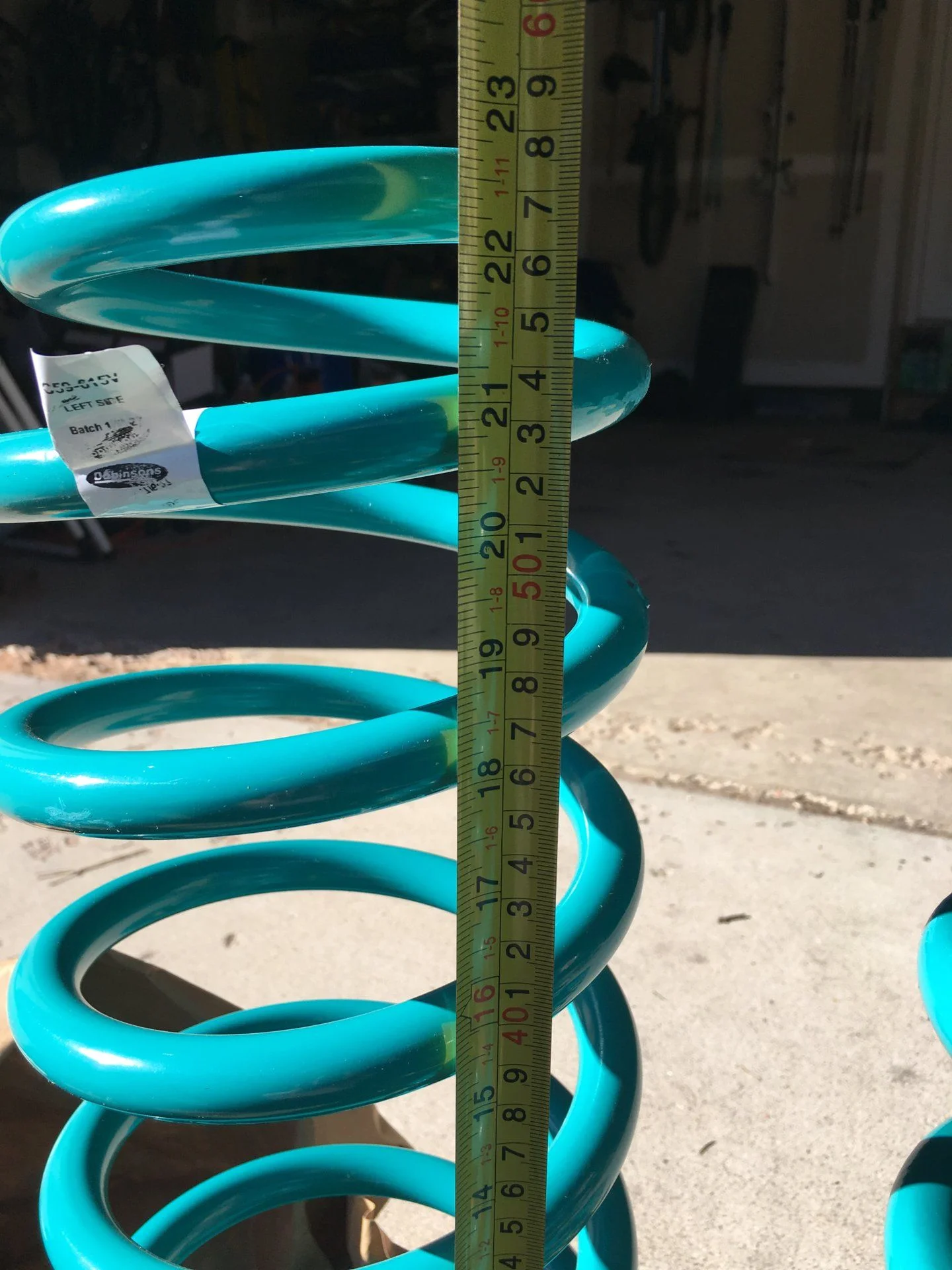

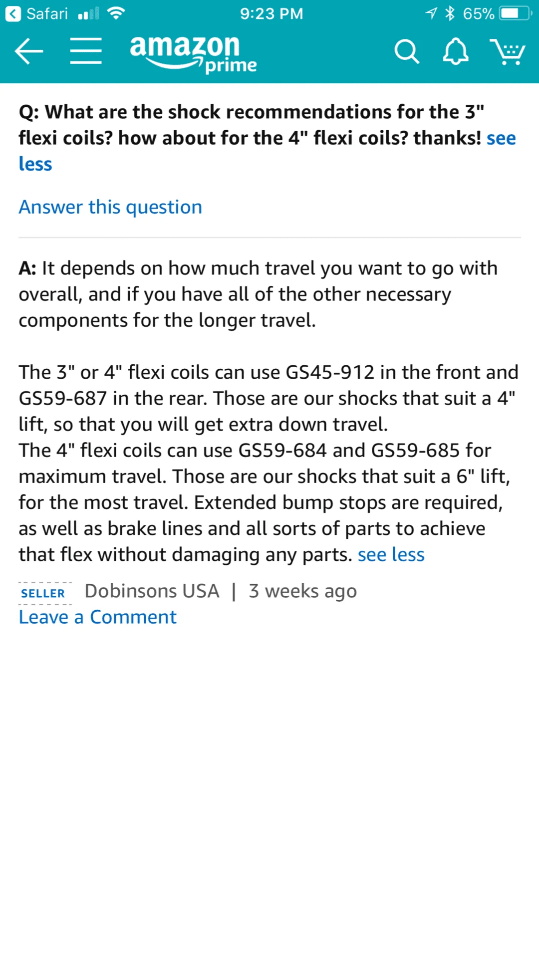

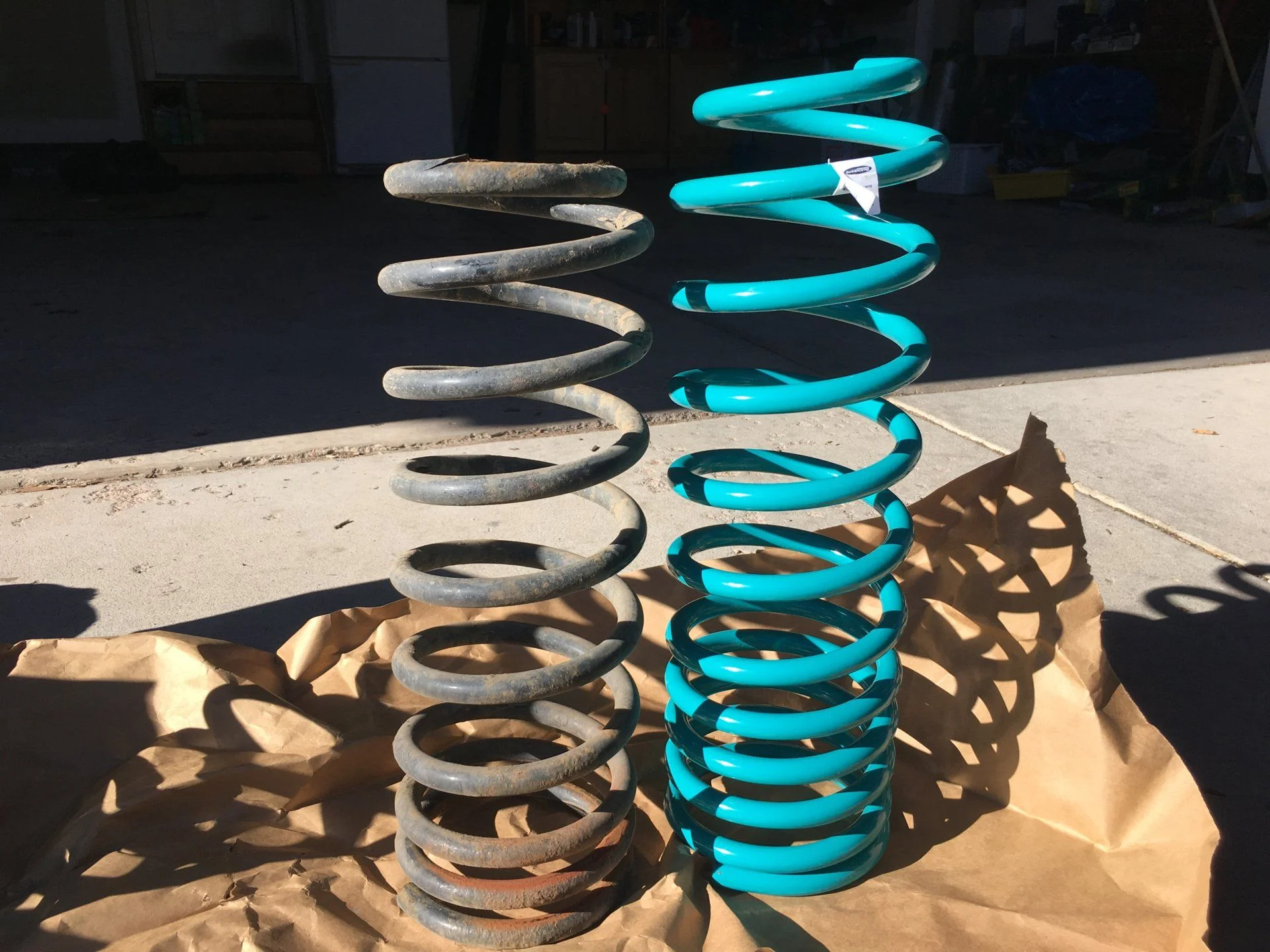

Second, the free height of the 4” Flexi rear coils is almost 23” - that spec was missing in the original post. Having seen the rears in person now I have also ordered the fronts.
Consistent with this, Dobinsons does say on Amazon that the 4” Flexi works with the longer 6” lift Dobinsons shock so that should be corrected in the original posts and my ranting can be mod deleted.
Also, if there is any remaining debate about what is left vs. right side, Dobinsons provides a handy little guide on the box. TLDR: left is left even in Australia.

I’ll post up about the fronts when they arrive. I’m suspicious that they are only 23” free coil length given the rear coil length.

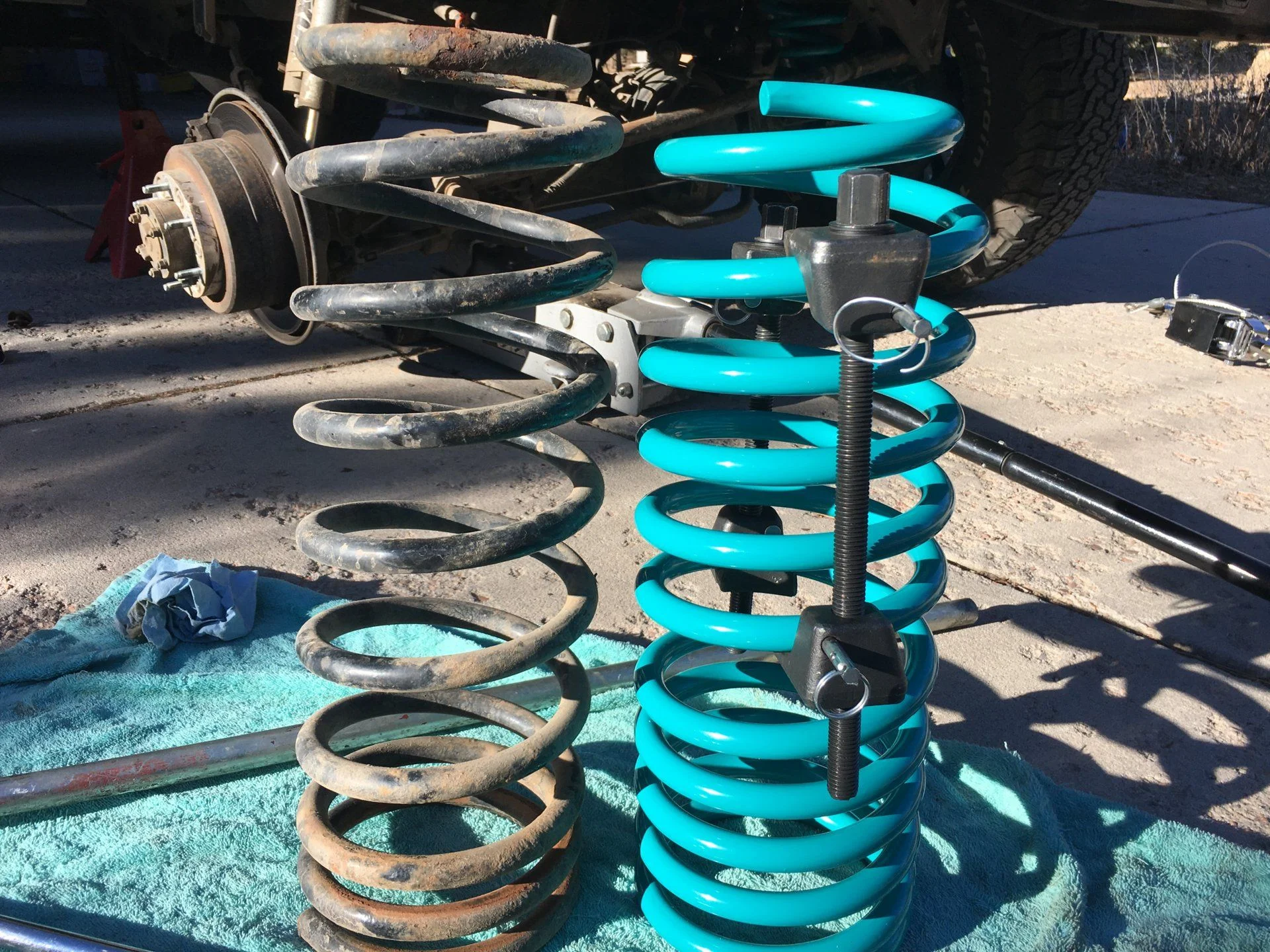

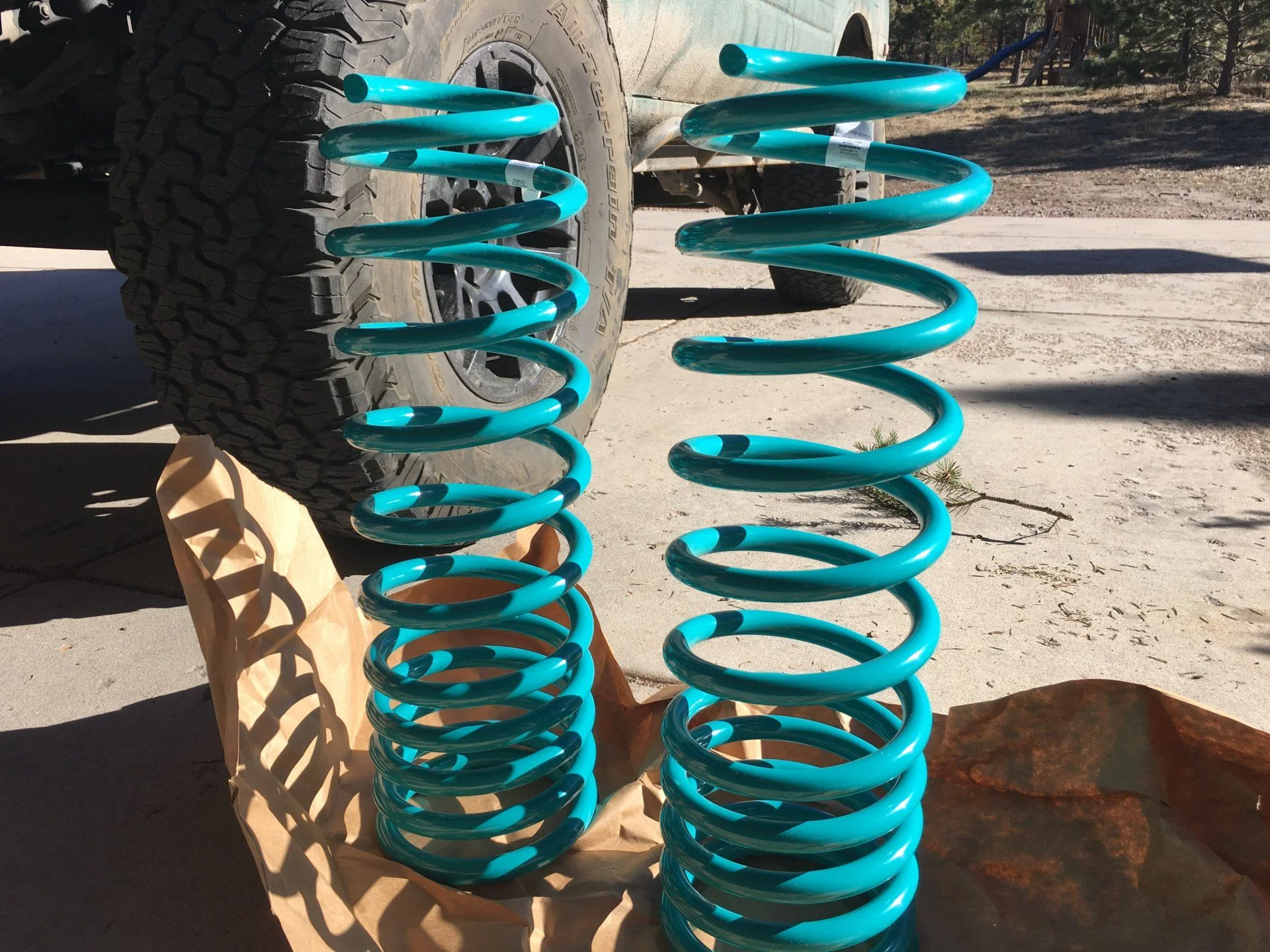

The rears are about 3” longer than the FOR Gen II dual rate coils they replace, and have two extra inactive winds.

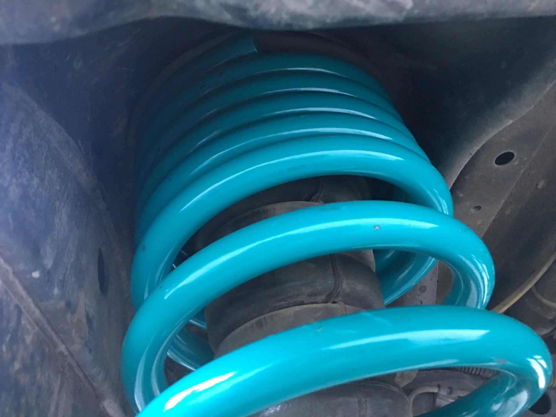

I run a 10” remote reservoir Fox shock that is 26.1” extended plus an upper mount pin to eye adapter, so total effective extended length of about 27.5”. The FOR coils didn’t unseat at full extension, so a typical 12” pin style shock would work easily with these coils as they would comfortably support a 30” total extended shock length. I think they would even work with an eye mount adapter and 12” eye to eye shock, which opens up a ton of shock choices.
They seem excellent spring rate wise with about 200 lbs of rear cargo (spare tire, spares, tools), and I picked up about 1/2” of lift @ ~25” hub to fender (no flares and tape measure wrapped around the tire) but I need to install the fronts to get a full impression and see how all four corners sit.
I run a 10” remote reservoir Fox shock that is 26.1” extended plus an upper mount pin to eye adapter, so total effective extended length of about 27.5”. The FOR coils didn’t unseat at full extension, so a typical 12” pin style shock would work easily with these coils as they would comfortably support a 30” total extended shock length. I think they would even work with an eye mount adapter and 12” eye to eye shock, which opens up a ton of shock choices.]
Yes at almost 23" free height it's a seriously tall coil for 4" of lift.
The GS69-685 rear @ 28.74" is the suggested shock for this coil..

Yes, it is. This coil is ironically exactly what I’ve been harping about not being on the market, based on a simple idea that a coil can be lengthened with inactive winds to the extent you want to keep doing it.
There’s a limitation to keeping the shock travel in the sweet spot of the coil flex, though, which is precisely why I use eye adapters to space down travel rather than a proportionate increase in shock length to lift height.
That’s a different set of suspension theory that goes beyond coil specs, but at first blush and drive, with just rears installed, this feels dialed for how I prefer to tune my suspension.

Oh, and I hate coil compressors, which I now own for IFS strut work, but you’ll be doing plenty of extra unbolting to avoid them.
If you keep adding dead coils you will, at some point, get to a coil bind problem and need to limit bump travel. Also if you are taking the same travel shock and spacing it down you will need to add bump spacer. This is fine if that's the height you want and you are limiting bump to run 37's. However you often get to a point where total travel is the same but now CG is higher.
If I ever go to 37's I will do body work to make them fit and not limit bump travel.
I hate using them too. When I do, I also have ratchet straps that I tighten as I tighten the compressors. That way if the compressor(s) slip off, the straps keep the recoil under control. 2 man job but it's much safer. If the spring comes out without the straps you better hope it goes the opposite direction! That damn thing will kill somebody.
