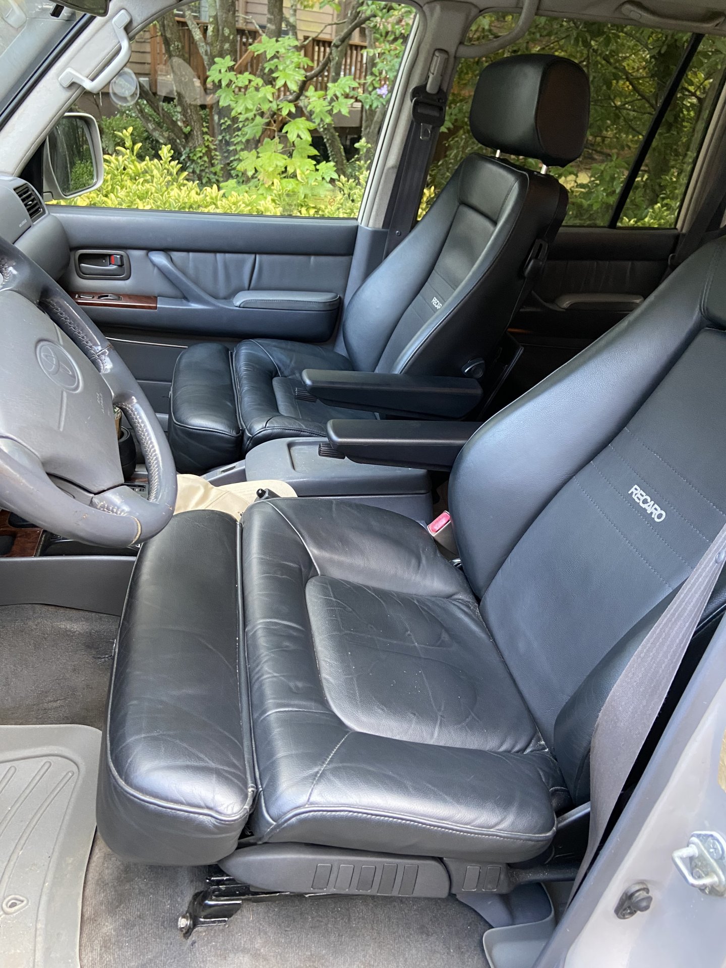

I did Recaros and my back has been super happy.

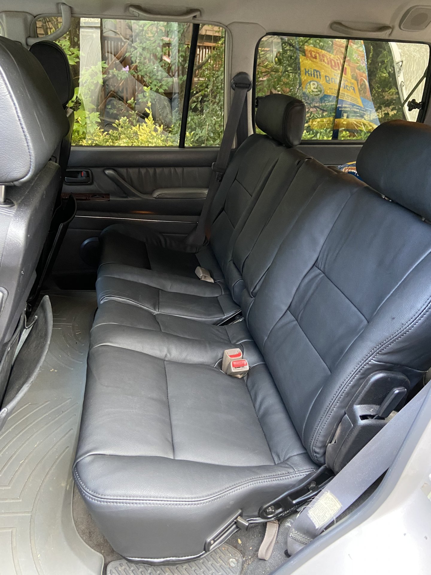

Finished recovering the back using a set of LX450 rear seats, matched the pattern better on the front seats. Turned out really nice!
