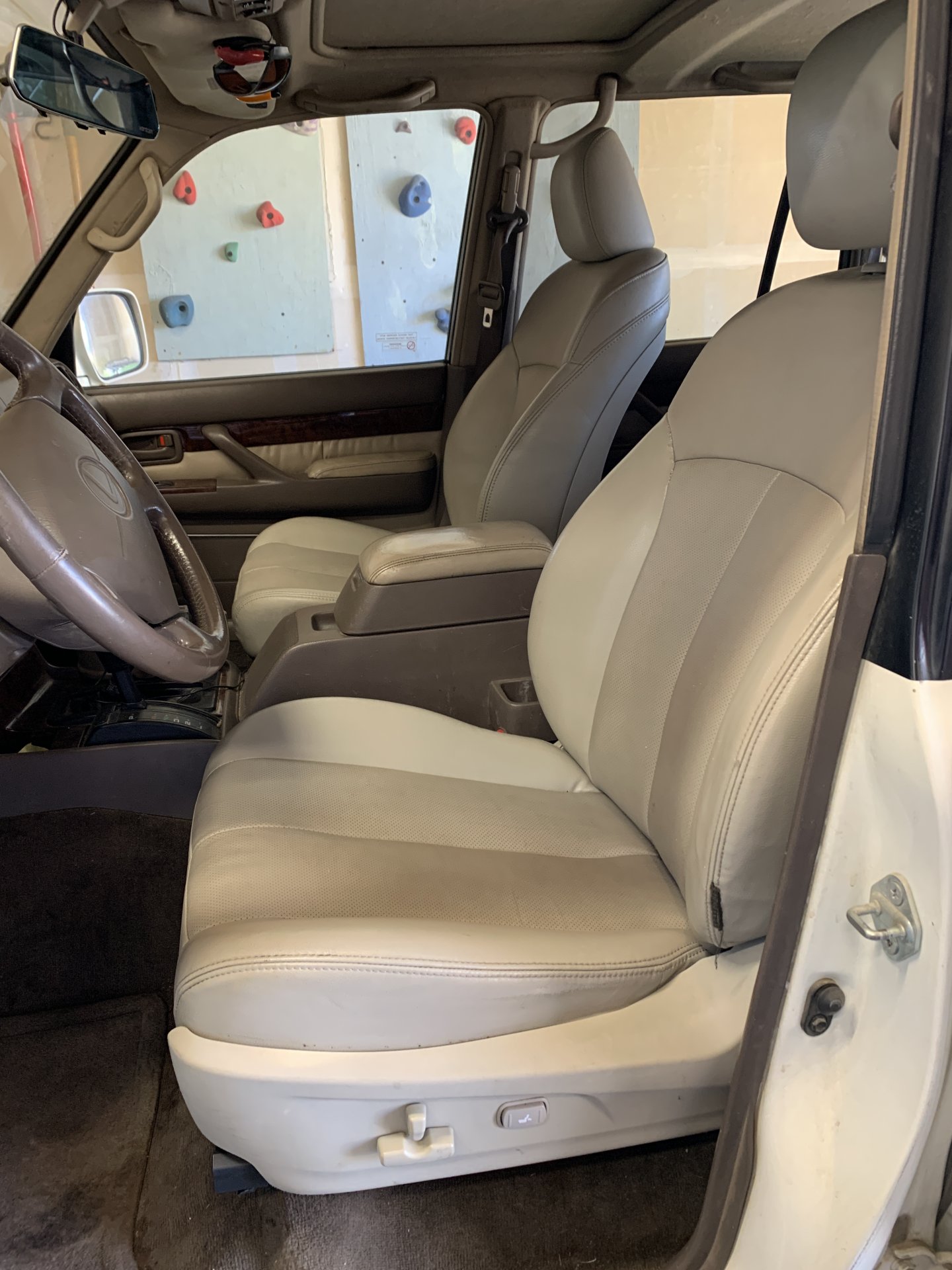

Has anyone ever installed any Infinity's GX56 captain chairs ?
Seats are very comfortable, electrical working properly and I can get both front seats for a very reasonable price. Seems like it would be a nice upgrade for a relatively low price used seats (~$200 pair).

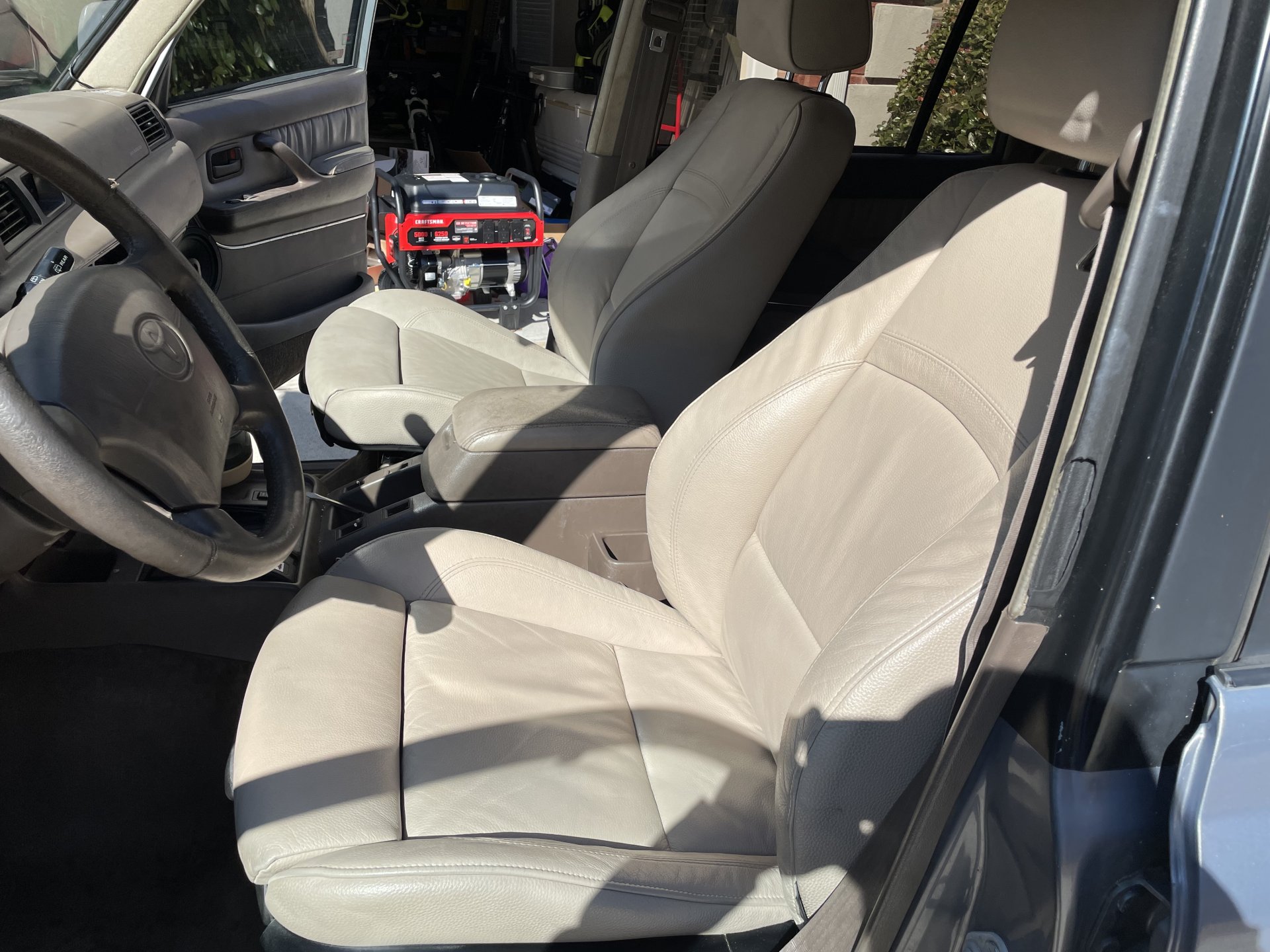

BMW E90 sport seats on modified Planted brackets. Had a buddy’s shop tech wire them in for functioning power and heat, I still need to add the heater switches to the dash.
Had to do a little hinky wiring trick to get the power to work. The circuit bus in the seat is looking for a signal that the Cruiser doesn’t send. Without an extra switch, the power seat would power off after 10 seconds.
So he added a toggle for each seat that “powers it on” for adjustment. Not the most ideal situation, but I didn’t want to spend an extra $200-300 for them to build me a proper circuit board (neither did he), and I really don’t move my seats that much so it’s not a big deal. Toggle switch for each seat is in the forward coin slot. Ejector switch, baby!!!
The rear mounting point of the BMW seat did not match up perfectly with the Planted bracket, so they did some material manipulation. These seats feel like they sit about an inch higher than stock. I’m 6’2” and only barely brush the ceiling on occasion.
90-minute ride home from the shop and I’m very happy. Supportive but still comfy, and tons of adjustment.

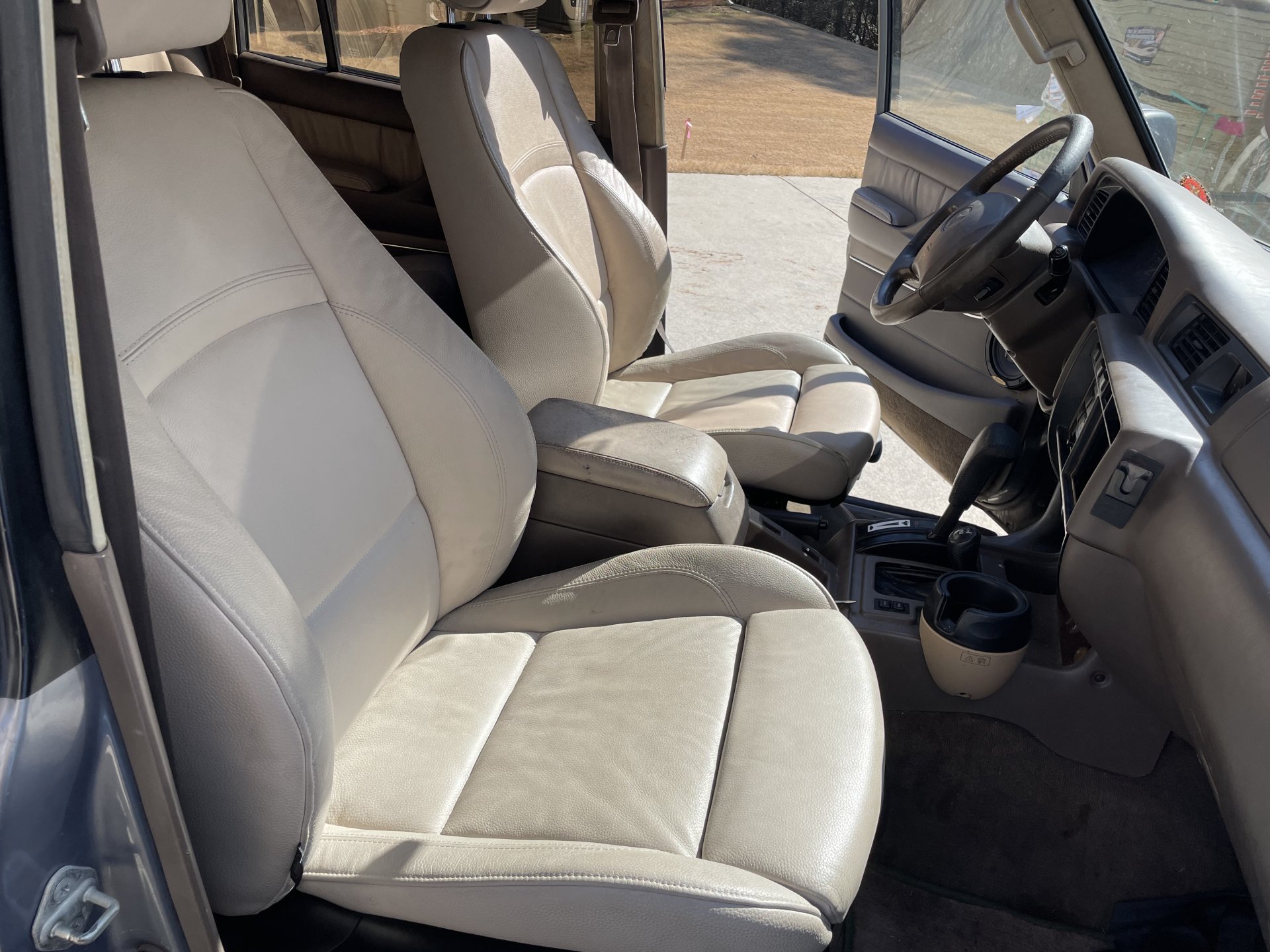

From 2010 Outback. I cut the brackets off both sets of seats, modified the front lc brackets to get the seat as low as possible, made an extender for the front-outer and welded them up.
Power seats are just 12v feed. About 10 hours and $150 for seats and consumables. The seats sit about 1” higher. Very comfy and I’m really happy with the outcome!

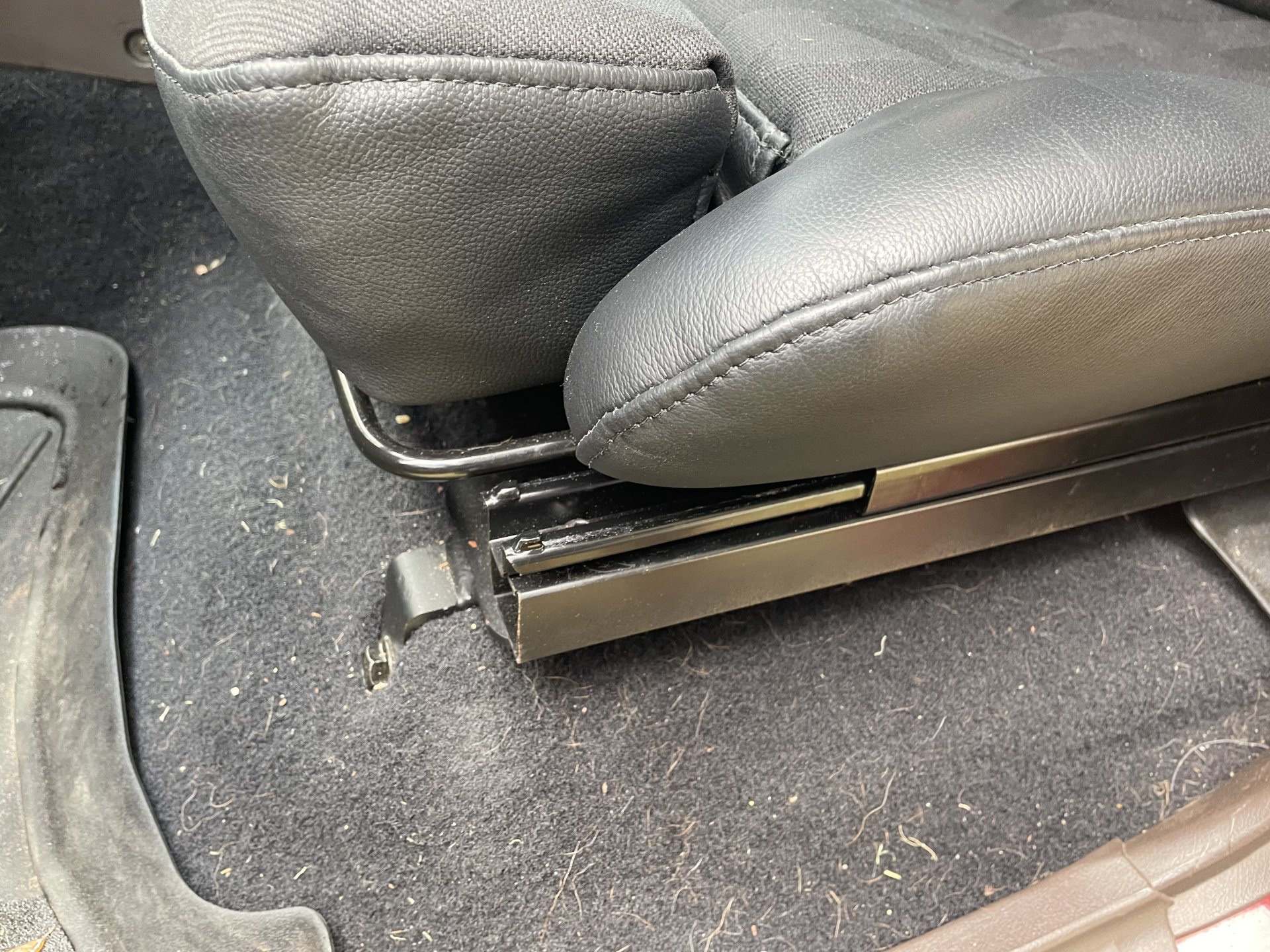

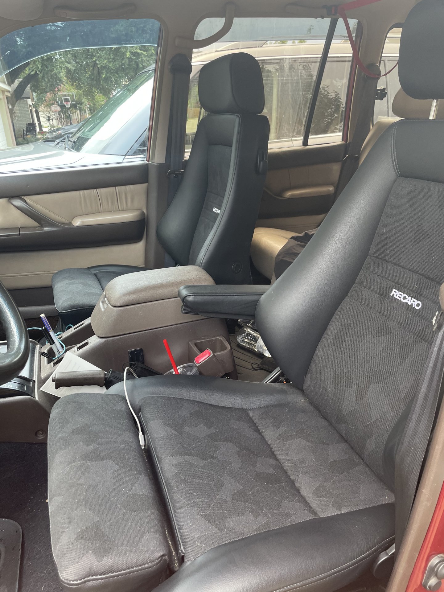

Just as a FYI, if anyone is going to source a seat from a different vehicle, I'd look at the ones that come with an arm rest on the driver side. It's a game changer!!! Mine came from a 2006 LR3 and those long drives are more pleasant now.
I can attest to this. I went from having the arm rest in my 100 series factory seat to not having it with the Recaros. I wouldn't go back, but the arm rest is about the only feature I miss.
I was wondering if anyone has swapped in seats from LR4? Are they that much different that the LR3's?
I did that from a '06 LR3, not LR4. I'm sure the LR4 is even fancier but the overall size /should/ be the same but I don't really know for sure.
You're correct. I haven't seen any that are a direct bolt in swap, so all will require some level of modification, mainly the seat mounts. The most critical thing to look for IMO is the width of the seat rails. IIRC the factory seats have a width of 21" between the rails (someone can correct that if I'm mistaken). Finding seats that have rails that are close to that can simplify things when making new mounting brackets.
The Jetta seats I have in my cruiser have about the widest rails that will still work. I still needed to modify the floorboard near the trans hump for clearance on the inner rail and the door pocket makes light contact with the outer rail.
