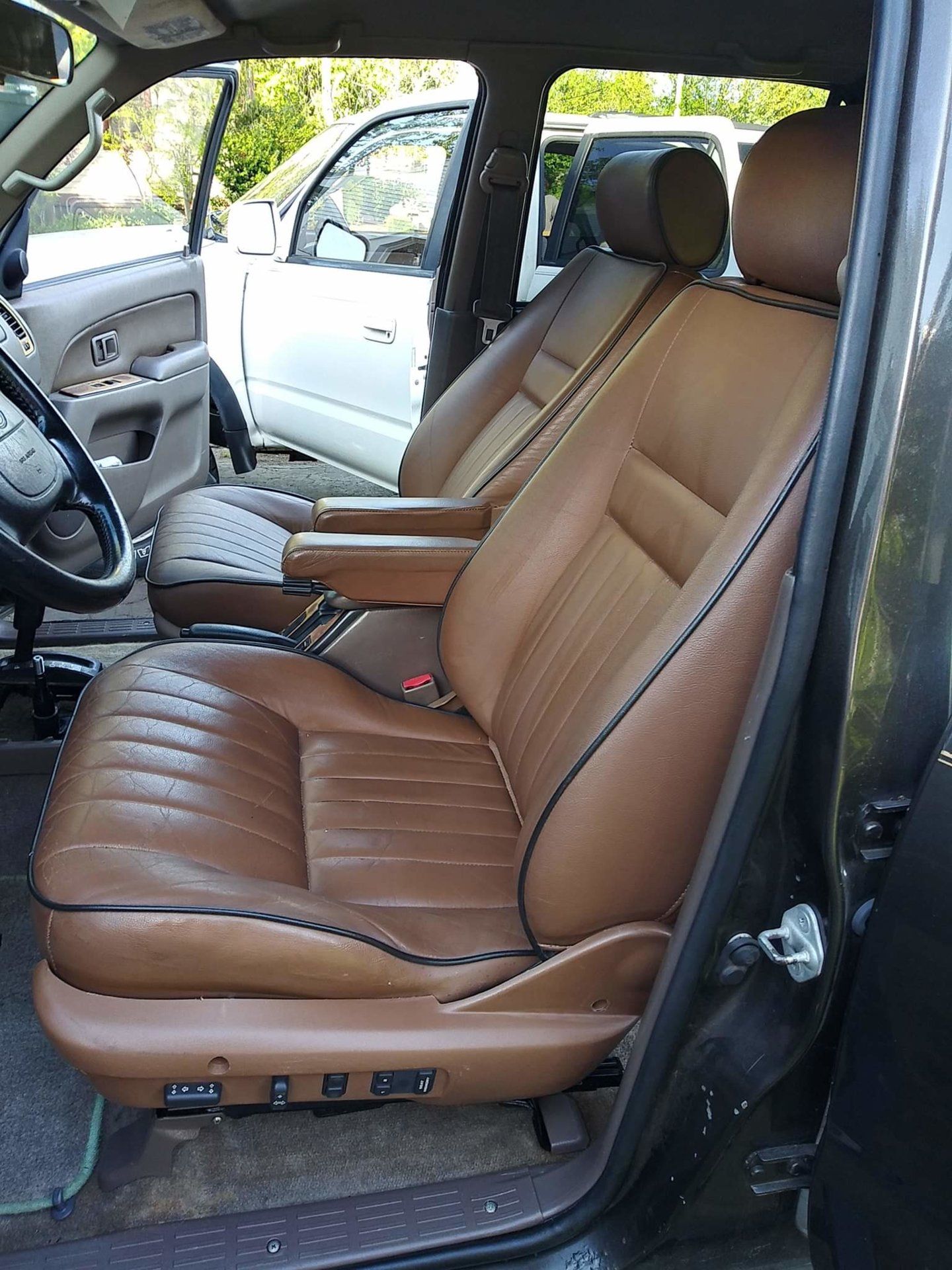

I installed a set from 2006 lr3. I did make up my own brackets and did have to modify the part of the floor that is impacted by the front seat brackets but other than that it was pretty straightforward. I opted to go with these seats because they have the seat controls built into the sides of them.

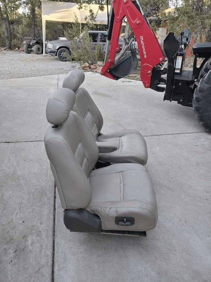

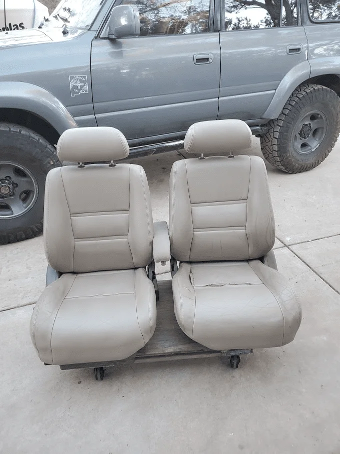

I'd like to get rid of my 80 seats, if anyone wants them. Driver cushion is less than seven years old but the stitching is coming apart while the leather is in good shape. Mine comes with an adj armrest!
For sale ad here: For Sale @ High Desert Cruisers
