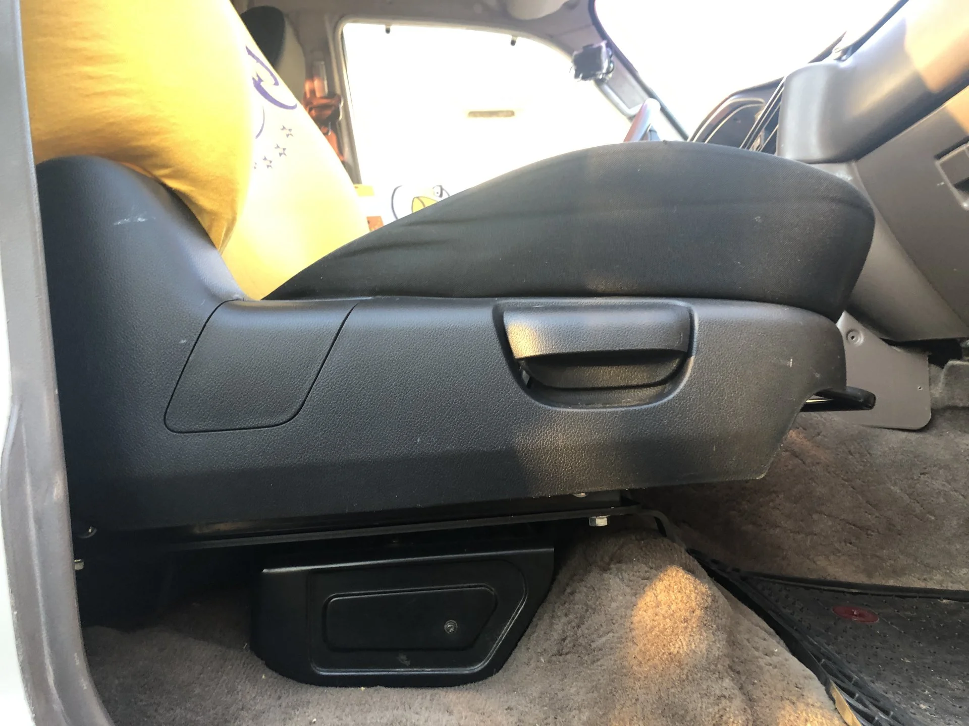

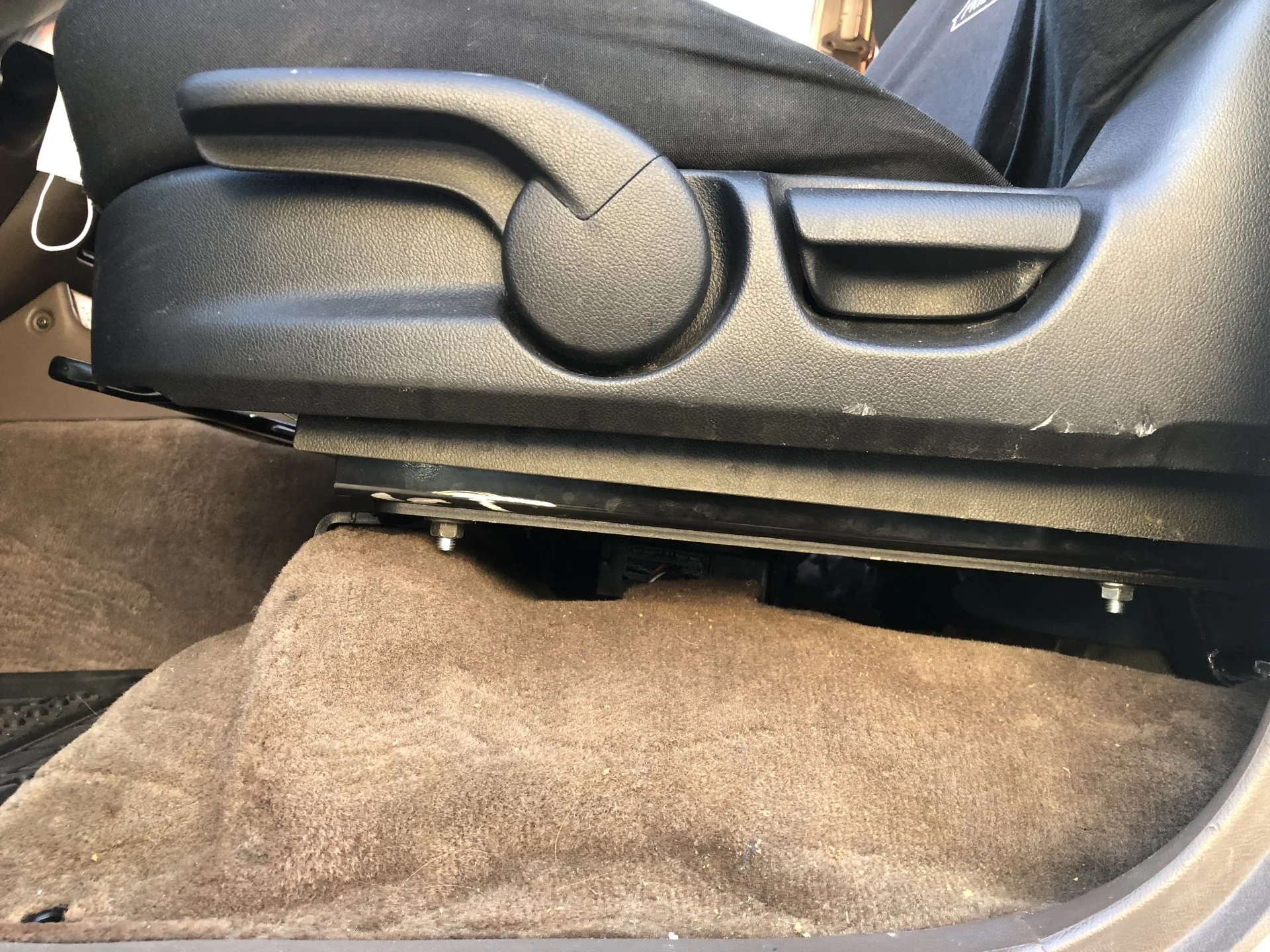

I'm going to tackle fitting some power/heated RX-8 seats with Planted brackets in the near-ish future.

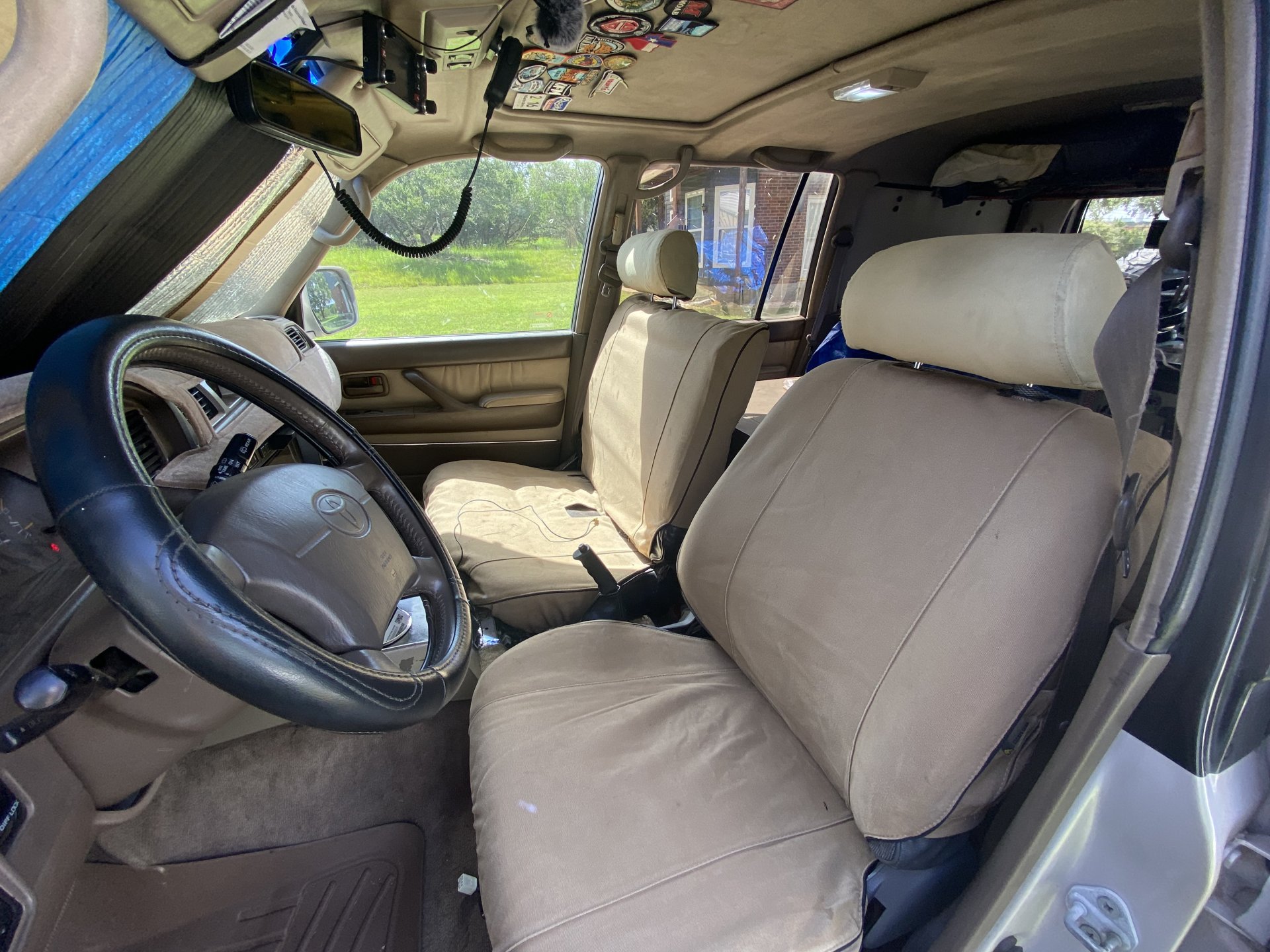

Great info thank you, I think the tan in the S4 seats matches well and I have sat in them I know they are comfy, or at the very least much comfier than my rock hard 97 LC seats. Did they by any chance sit lower to the ground than the stock seats? I'm 6'1 and I like to sit lower, the LC seats are high for me which is odd because I don't remember it being as much of an issue in my old LX.....but that was a few years ago and maybe I just got used to my GX.
I managed to fit them so the seat is a little lower than standard. I'm 6'6" so every bit counts.
It took some careful measuring and alteration of the original seat legs to get it a low a possible
