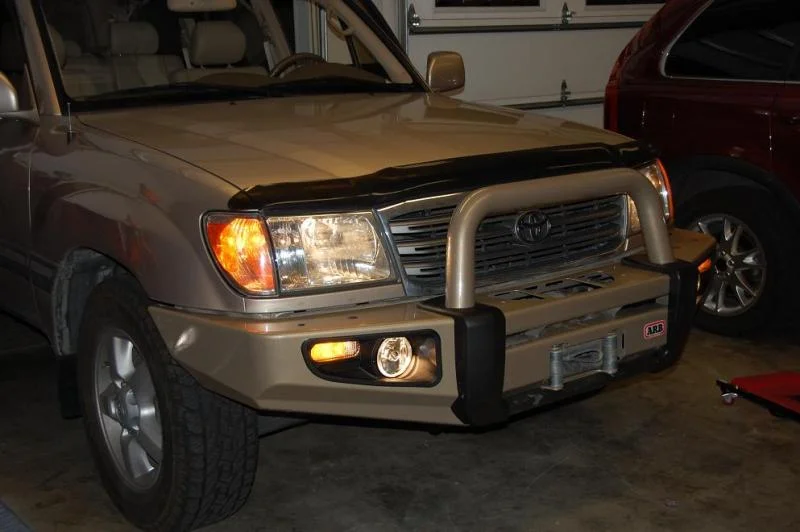

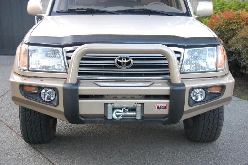

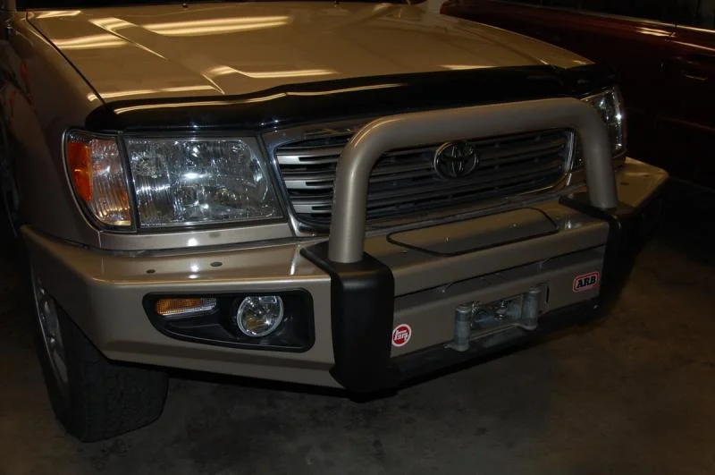

So I stayed up lateTuesday night putting on the front Sahara with lights and the Warn M12,000. Not nearly as bad as the rear ARB... I love the way the front turned out with the matching powder coat - including no more chrome on the hoop. Well, not quite matching, but close, and while it's not the perfect match I have a plan to tie it into the truck. I was originally planning on painting the side trim to match the color of truck but now I think I'll paint it to match the "one shade off" ARB front and rear bumpers. This ought to give it a very slight two-tone look, similar to OEM but no where near as much contrast.

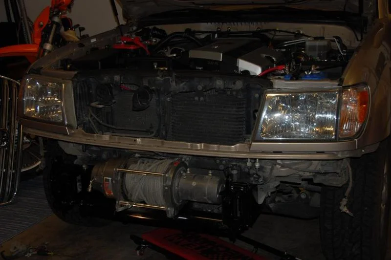

The install was pretty simple and the Warn dropped right in. The previous Warn owner already clocked the motor to get the handle in the right position. All I needed to do was cut out a small 1" x 3" of the inside of the Sahara bar to clear the movement of the winch handle from free spool to engaged. I think that is because the M12,000 has a larger diameter gear housing, took all of 3 min to cure that problem.
The Sahara IPF lights hooked right into the factory wiring for the OEM fogs, as did the ARB marker and blinker, lovin' it. A few quick cuts, some connectors and shrink tube and it's all good.

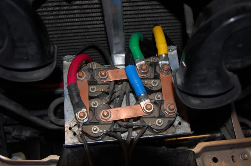

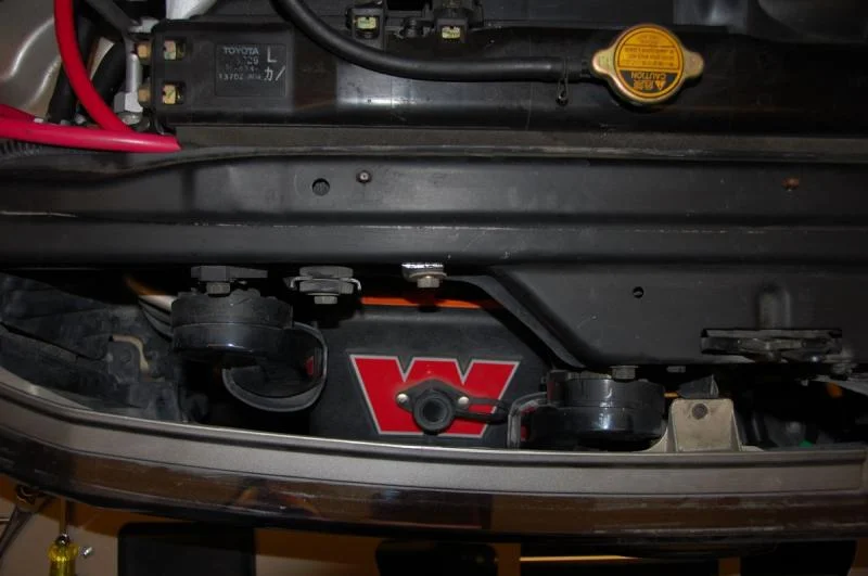

The warn control box isn't on yet. I am going to mount it inside the grill for a cleaner look. The Warn remote plug will just barely fit between the bottom 2 grill slats, so as long as I can get it mounted securely we should be set. I am going to make new 2AWG leads to the motor as well as to the new battery.

If you clock it to the top (which I tried in an attempt to not have to slightly cut the bumper) it won't work without more of a major mod/cutting etc. I have it clocked to stright ahead and had a cut that small peice. The benefit might be that I can actually move from free to engaged with OUT taking off that winch top cover plate. If that get's to be a pain I'll put hinges on that top cover.
By the way, you can't clock it in between straight up and straight foward, at least I couldn't get the gears to mesh.

I think ARB calls for you to clock it to the back, towards the truck. I'm trying to figure out a good place to put it that you don't have to crawl under the truck or squeeze your hand in to throw the lever. I like that the wiring connections sit on top, makes it easy to get to them. I plan to relocate the solenoid box under the hood.
Oh- one thing I forgot to mention - braking is about 15% decreased with the added weight of all the gear - 2 bumpers, a winch, extra battery - pushing close to 500#
Not sure if clocking it to the back would work or not... all the clocking is done while the bumper is off so I didn't check that scenario..

Also installed the winch control box behind the grill and ran all new 2AWG wires - I like the clean look. Ran out the cable and rewound it tight and all works great.
