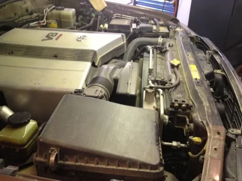

Does anybody know if the cross member at the top front of the engine compartment in a 2005 Land Cruiser is normally painted to match the color of the vehicle?
I am looking at the 2005 shown in the picture below and it struck me as odd that the crossmember immediately in front of the top of the radiator is color matched. Is this normal?
I know that part was black on my 2000 LC in Champagne Pearl, but maybe they changed it in subsequent years.
The vehicle does not appear to have been repainted ever, -but I thought the part immediately in front of the top of the radiator was supposed to be black, not color-keyed.
Can somebody with a 2005 let me know if you think anything in the picture below has been repainted, or if you see anything else fishy in the picture.
Any advice is appreciated.
yep, new cross member. Get under there and look at the frame, also look under the hood at the front fenders for rippling or signs of new spray.
If the frame is good and fenders look good i wouldnt worry

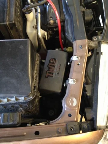

Flat color at the side, black in the center.
Looks like its also missing the factory sticker. Definite repaint.
Not even my '06 LX470 in white is colored keyed there. It's black from the factory just like OregonLC posted.
Edit: Though that sole white sticker, if it's guidance for coolant, makes it look very factory legit. I just looked under my hood and that sticker placement matches perfectly. That rub line from the seal also looks very factory. If it was a respray, I would expect to see black under some parts. I'm starting to chalk it up to some factory variance.
Edit: Though that sole white sticker, if it's guidance for coolant, makes it look very factory legit. I just looked under my hood and that sticker placement matches perfectly. That rub line from the seal also looks very factory as if it was a respray, I would expect to see black under some parts. I'm starting to chalk it up to some factory variance.

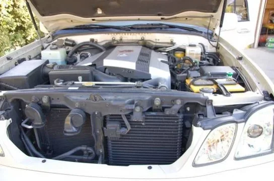

Here is mine from my '99. I'm guessing the question of "why black" is so that you don't see the radiator and surrounds through the grill.
