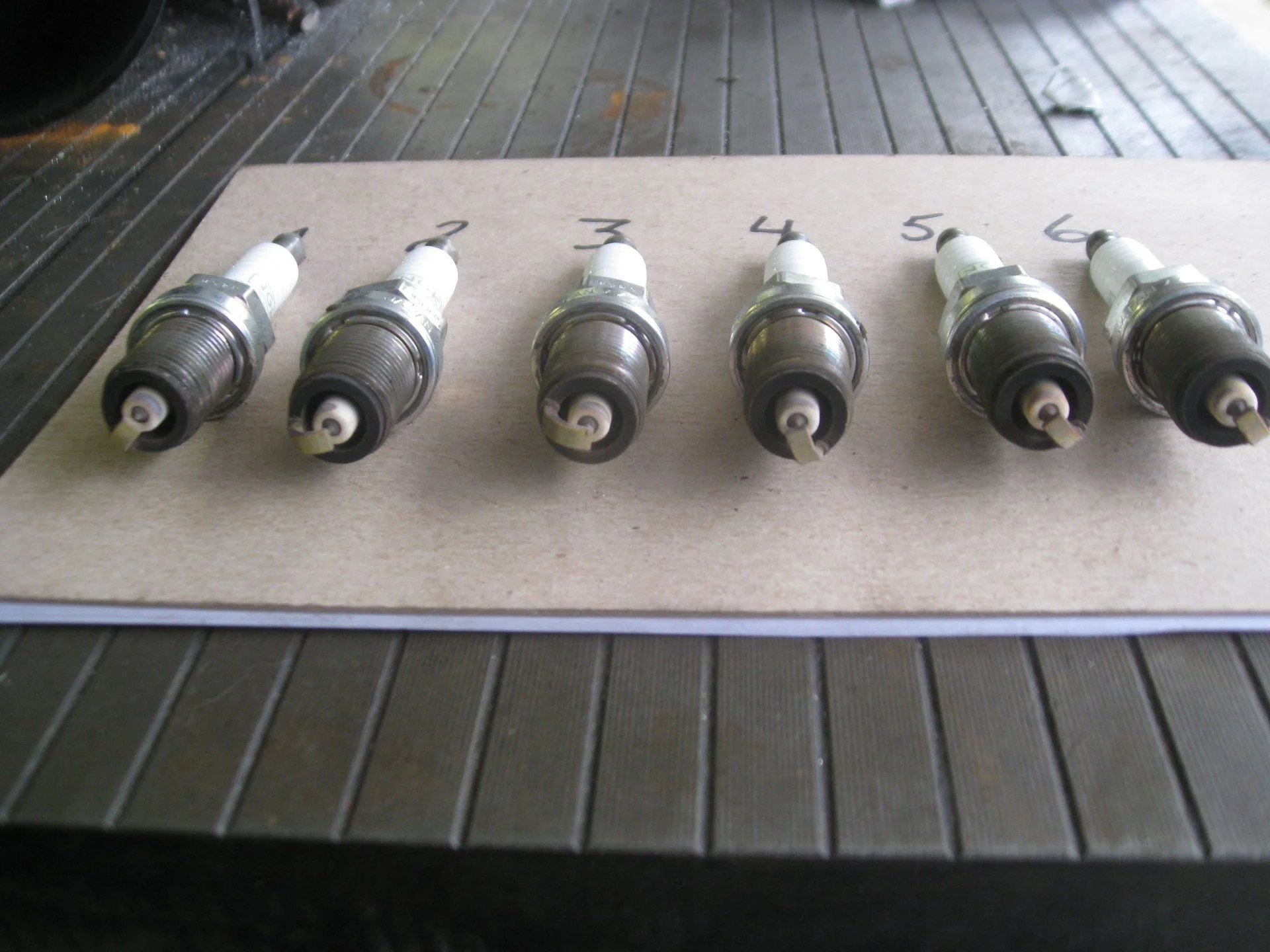

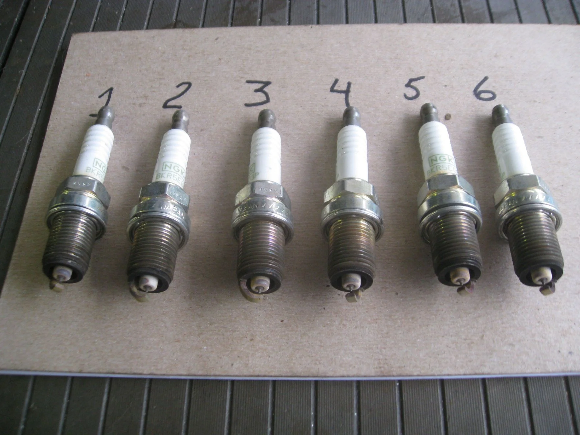

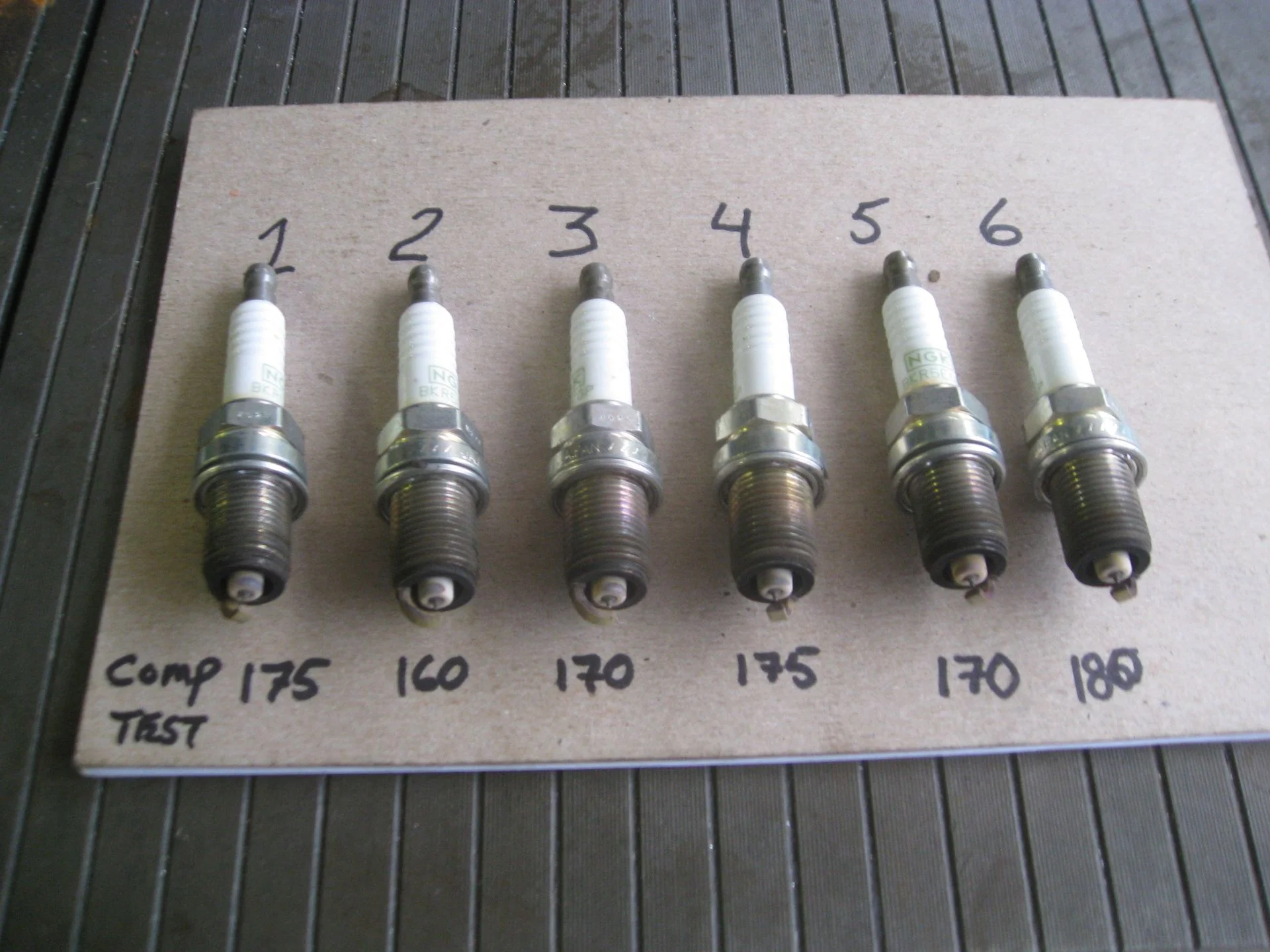

So i started out my day today by doing a water pump, Dex Cool coolant flush, and fan belt change on my daughters car, let me tell you transverse mounted engines SUCK!. After getting that fun job done i jumped over to my Cruiser, the first thing i decided to do was pull all the plugs to check their condition, plus i took this opportunity to do a compression test too.
Below are a few photos of the plugs along with the compression test results. My factory service manual says that the compression should be 171 PSI with an allowable spread of 14 PSI. Looks like cylinder 2 is the only one i should be concerned with, but per the manual it's still within spec.
