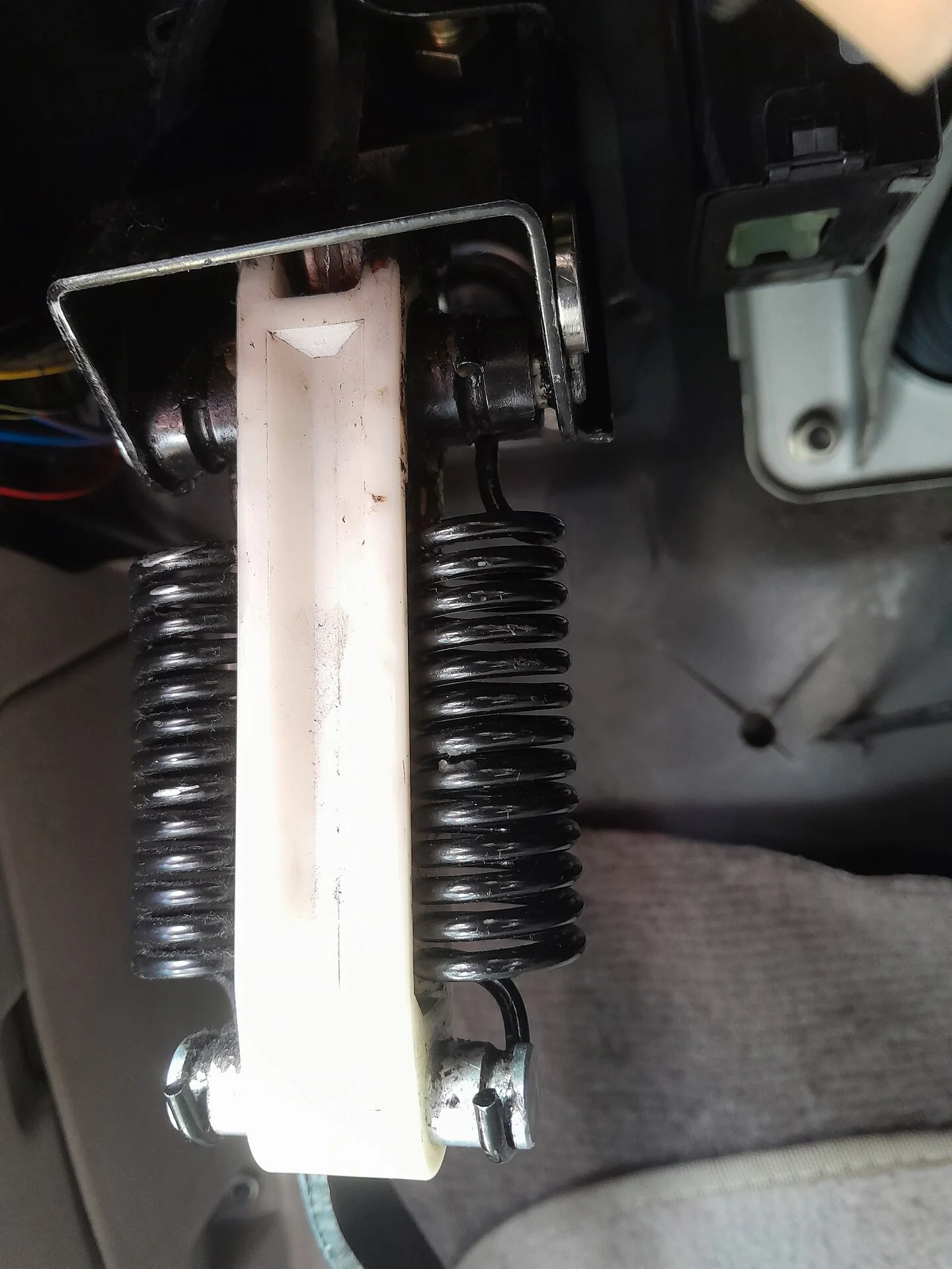

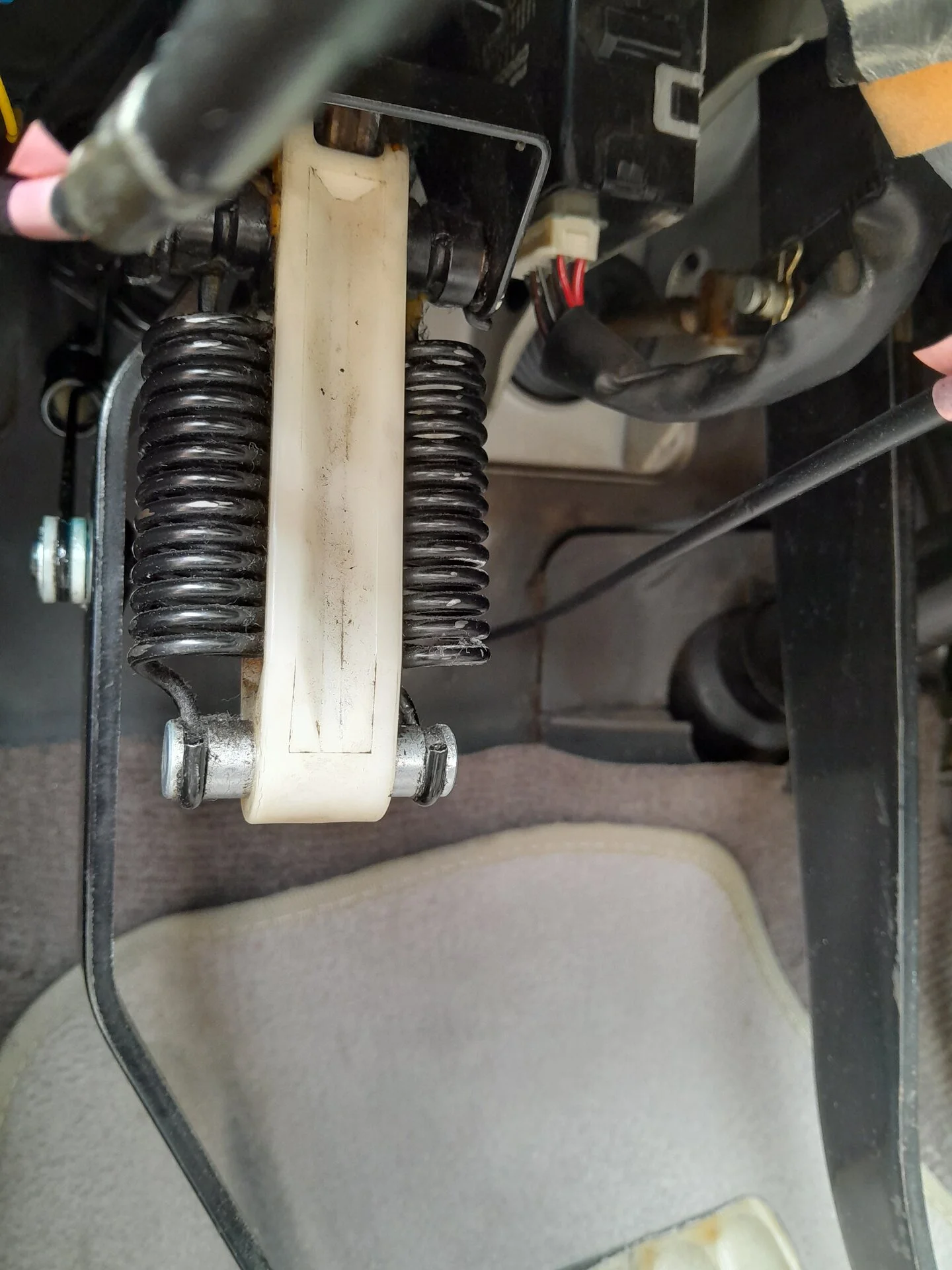

A closer look showed three springs in the pedal mechanism. At old age, after many tension/compression cycles, springs fatigue. I wondered if the pedal's springs were fatigued.
There are two compression springs in the pedal. Here they are.

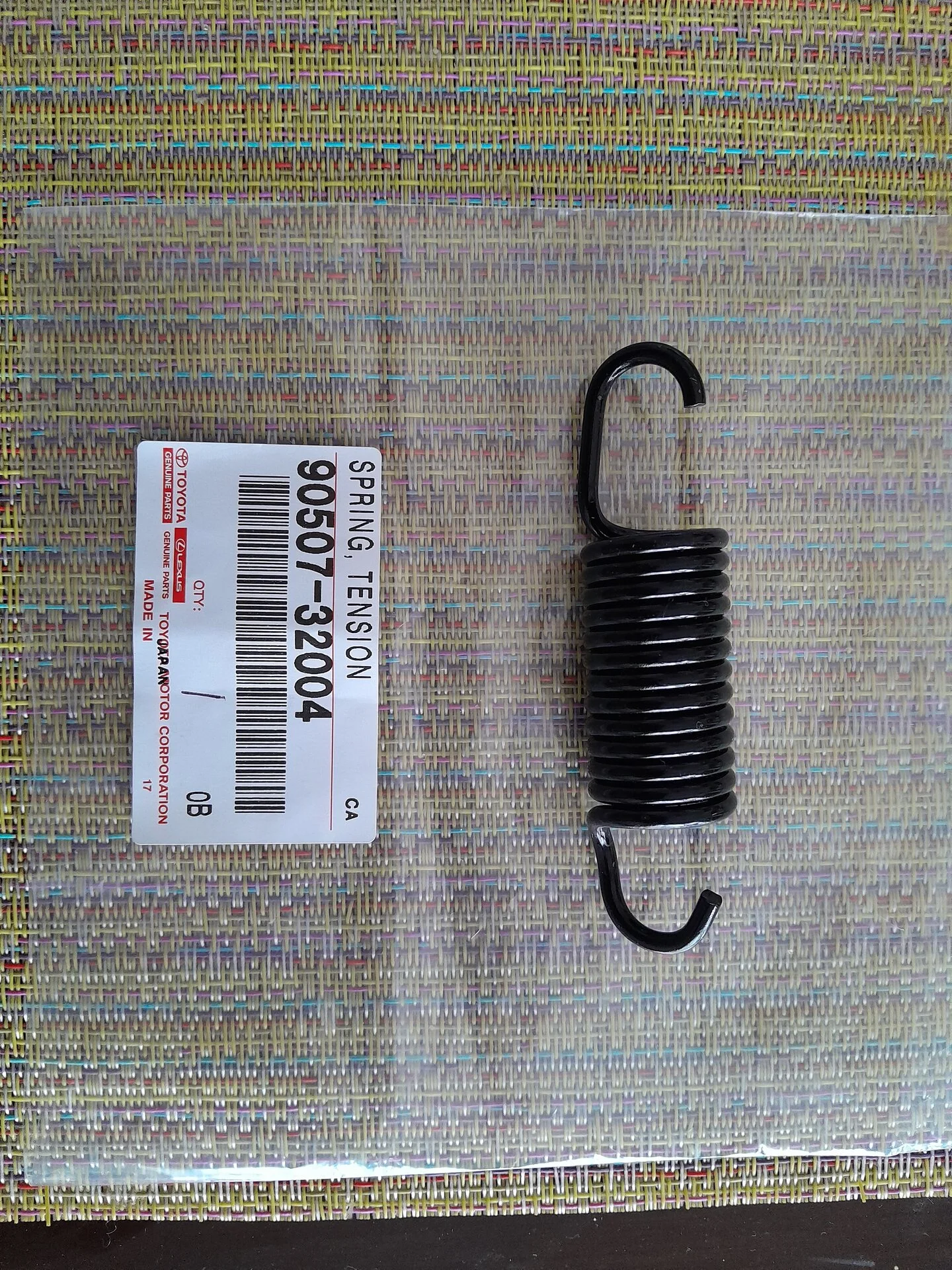

This is the compression spring. You need two of them. Part number is 90507-32004. Oddly enough, its label says Tension Spring.

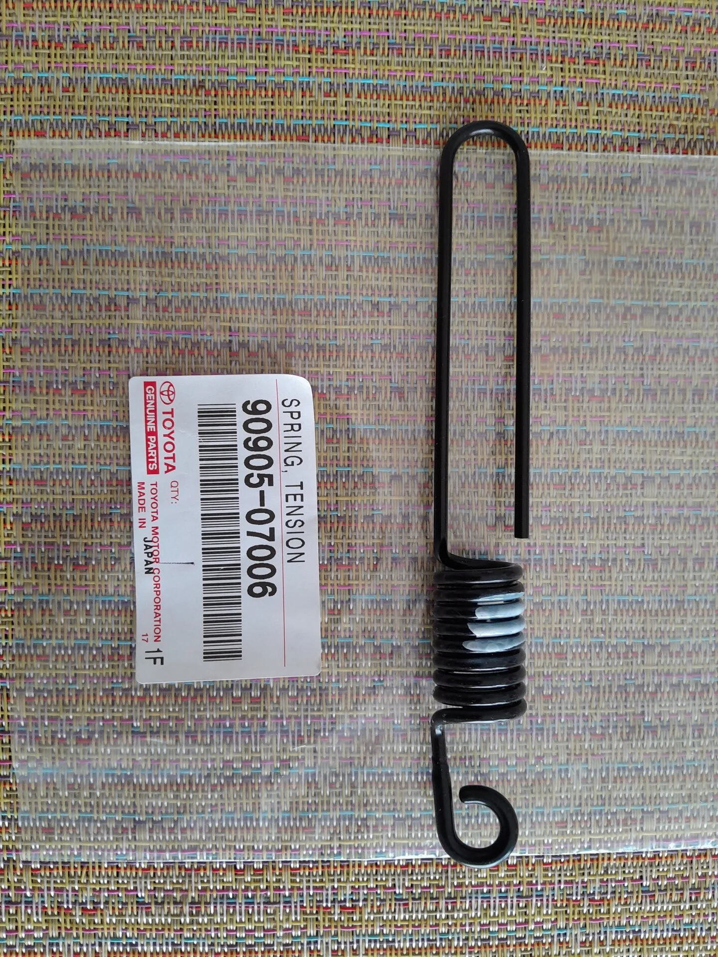

This is the tension spring. You need one. The part number is 90905-07006. The long hook attaches to the pedal arm with the help of a plastic pulley. The short hook attaches to the body.
The tension spring is held in place with two c-clips, one on each end. In the previous post I showed the pedal end. Remove the c-clip and each end comes loose.
Make sure the tension spring's long hook is pointing down when installing the plastic pulley.

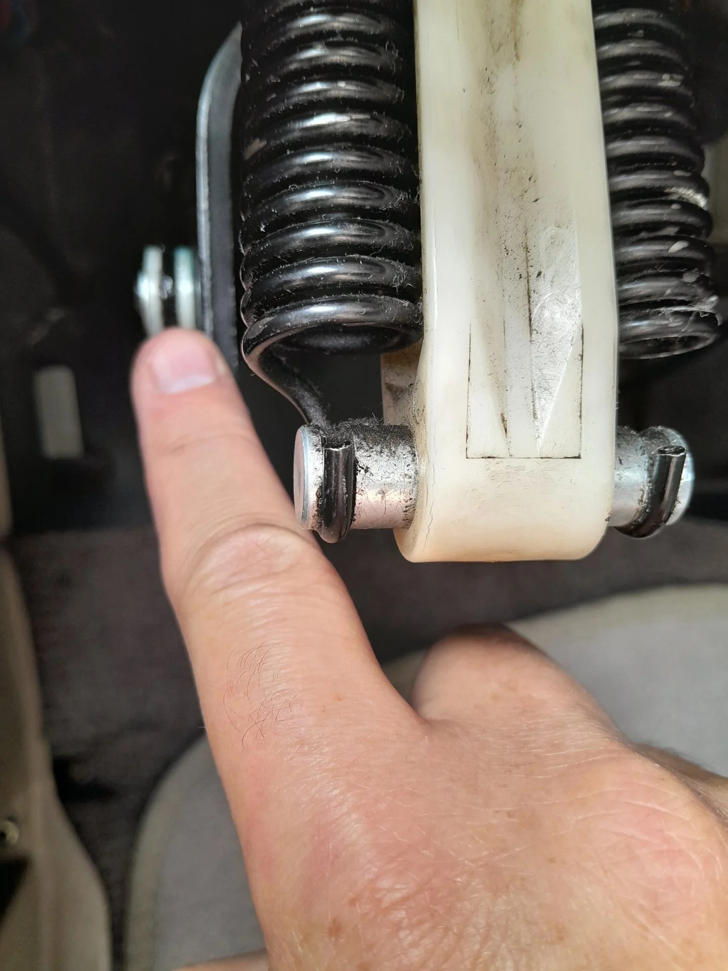

The compression springs require a gentle pull for removal and installation. There is no need to touch the pins.
New compression springs on.
Now the pedal has no play and it feels normal.
