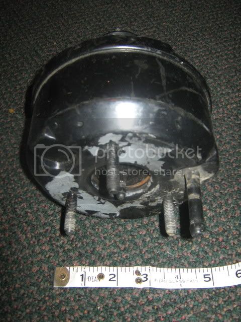

hi guys i'm having heaps of trouble getting a replacment clutch booster for my Bj74 with a 13bt.
I am hoping some of you might know what other models have the same booster. as mine is mounted on the inside of the firewall behind the dash none of the wreakers even know it exsists.

can you retro fit a regular style one?
any pics possible?

yes i got one from a small truck (dyna). took the guts out and put them in my housing. put it all back in the cruiser over the wekend. so all go now
