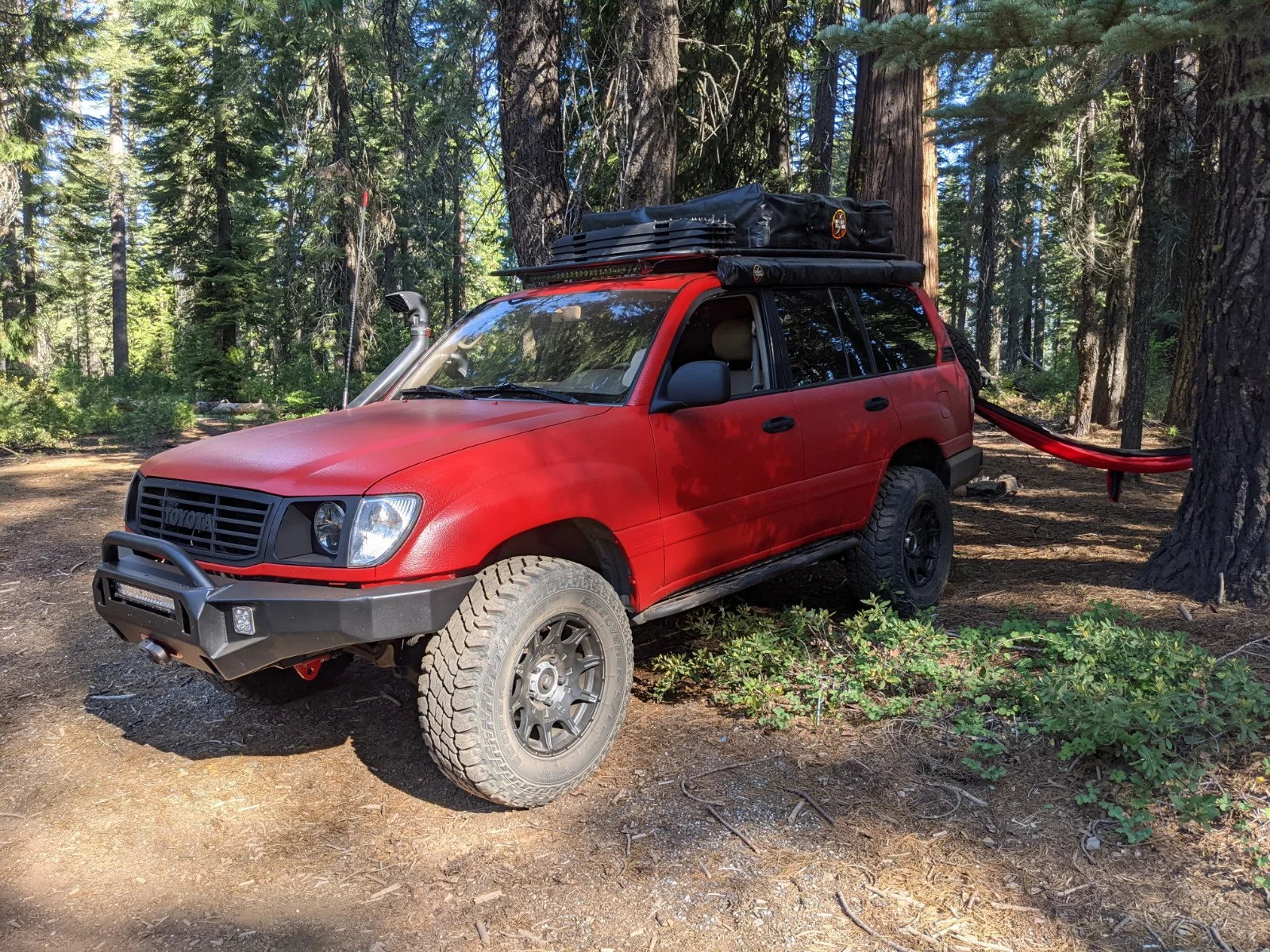

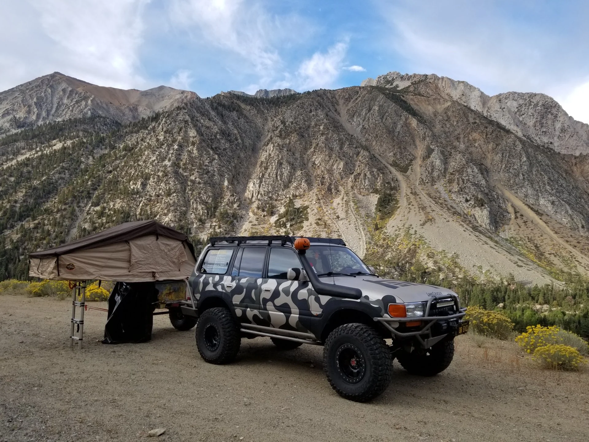

Loving my tough dog suspension, it has gotten really comfortable with the addition of the rear bumper and roof top tent.

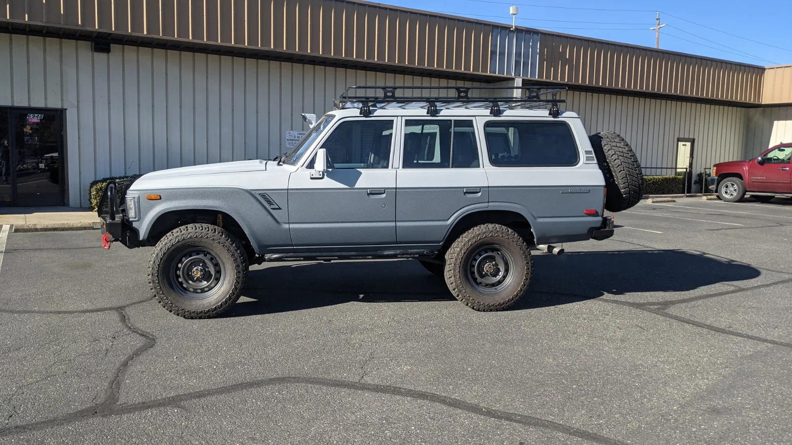

My Tough Dog equipped 80, in the wild.

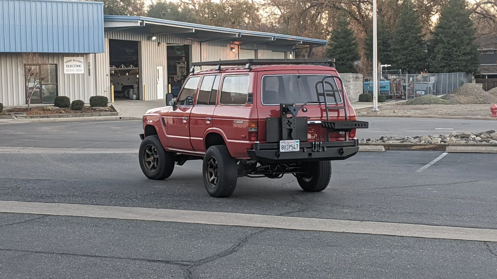

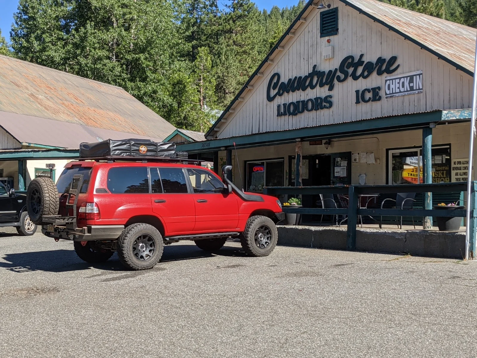

This thread needs more pics!😎

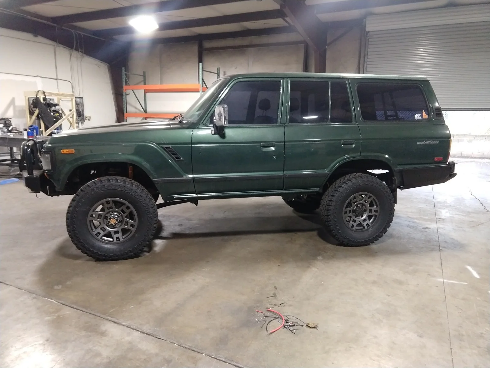

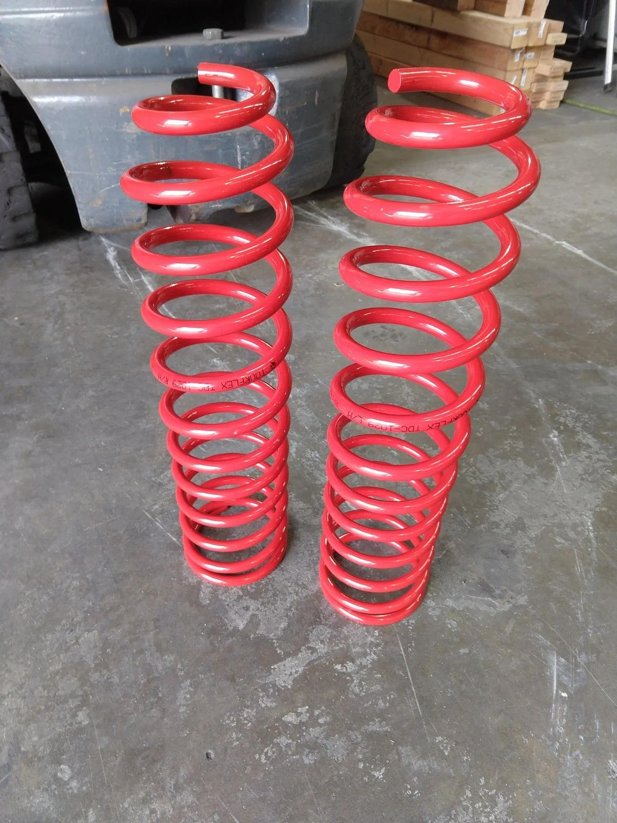

Any older vehicle applications, just installed 3" Alcan lift on my 69 55 series and the shocks are maxed out. I had planned on replacing em anyway with some Bilstein's till I was told about the foam shocks.
Have any ext/compressed measurements?
