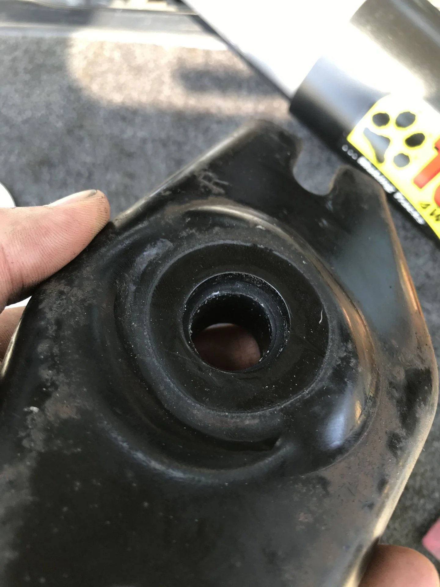

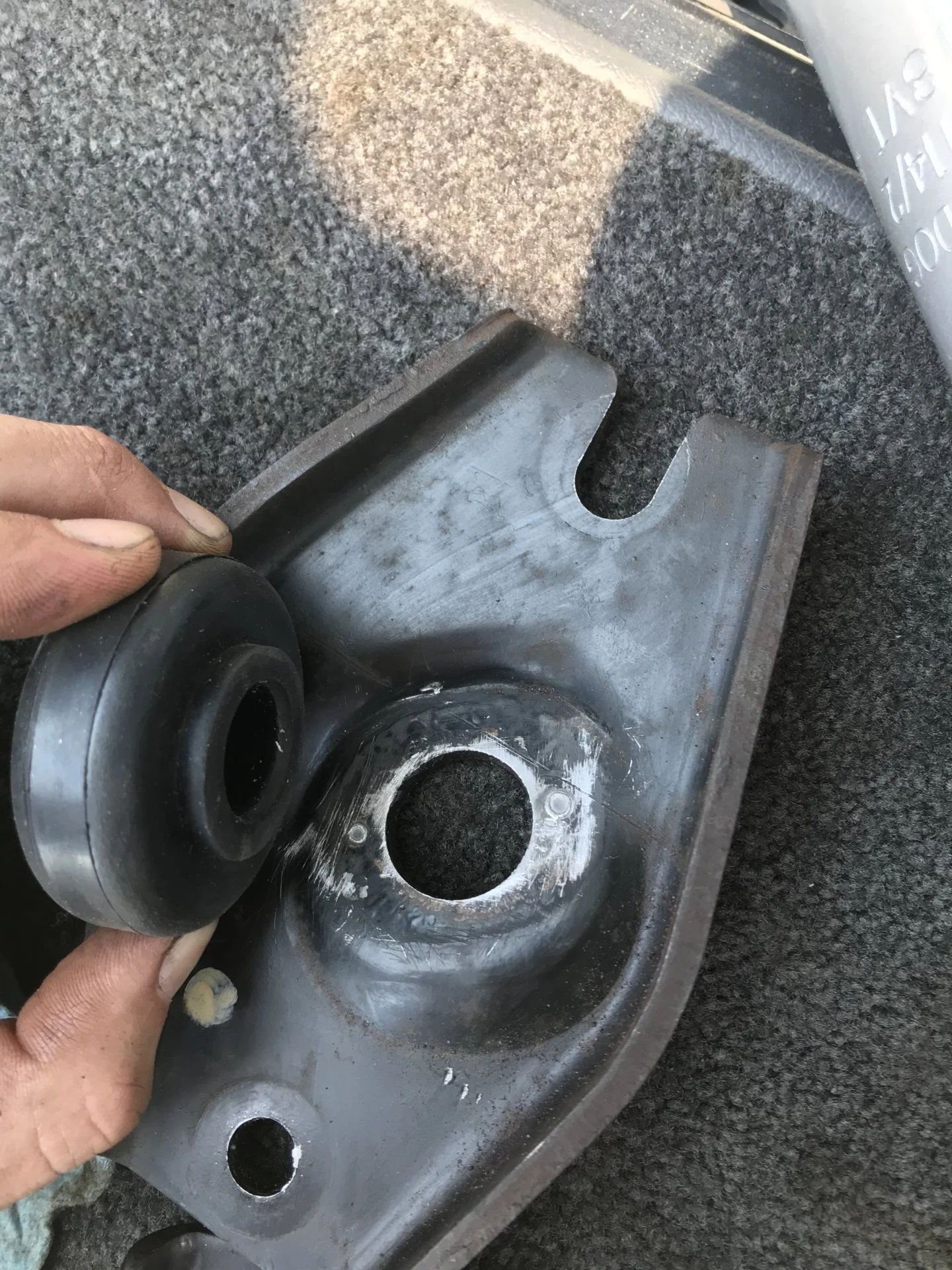

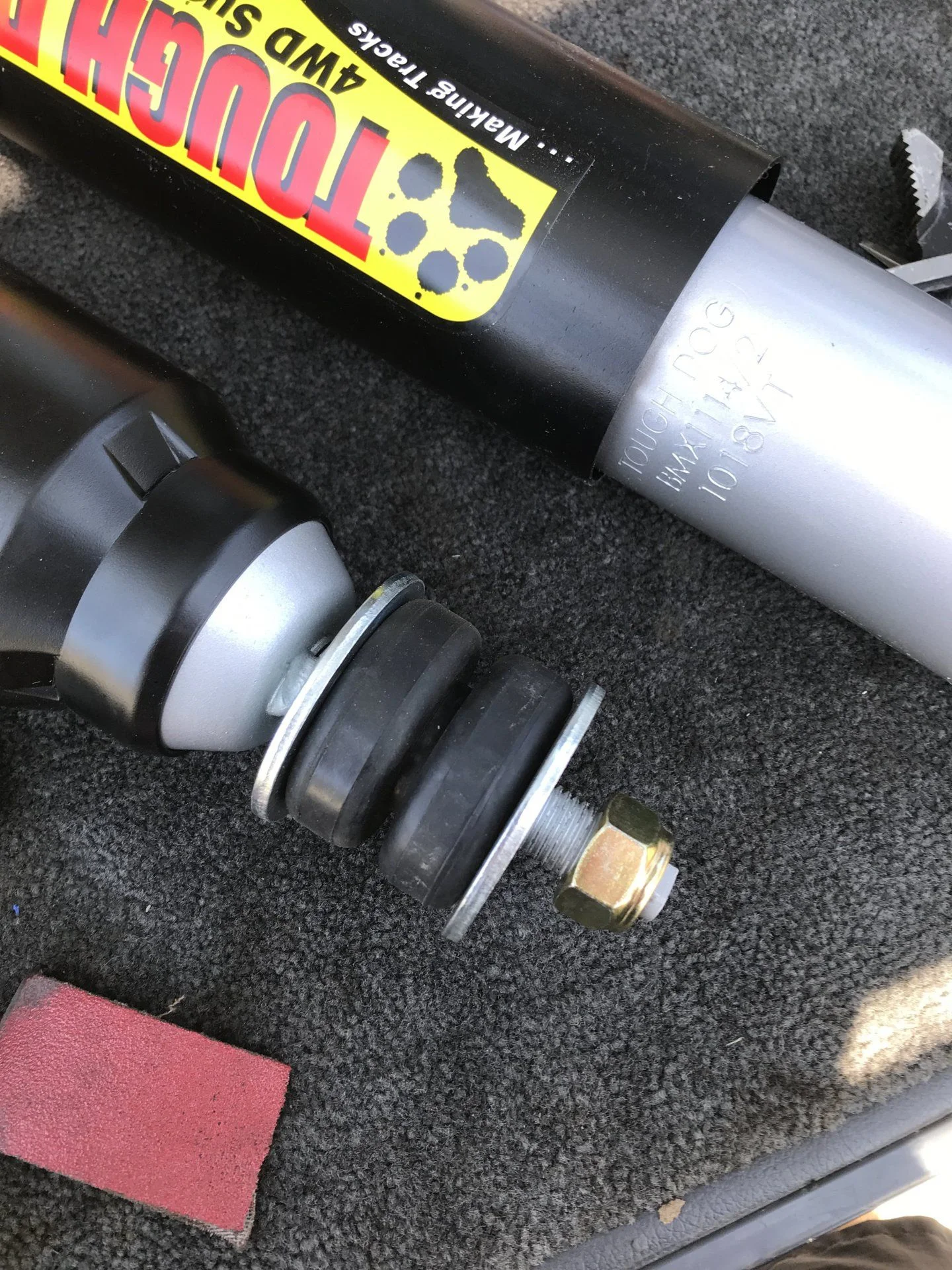

I finally got around to installing these and wondering if this is on any issue... pics below. For it’s worth I had the sport and comfort shocks on this 1991 HDJ81. It appears that the bushing from tough dog will not index into the upper shock mount plate. Is this even a issue?
2025184
2025187

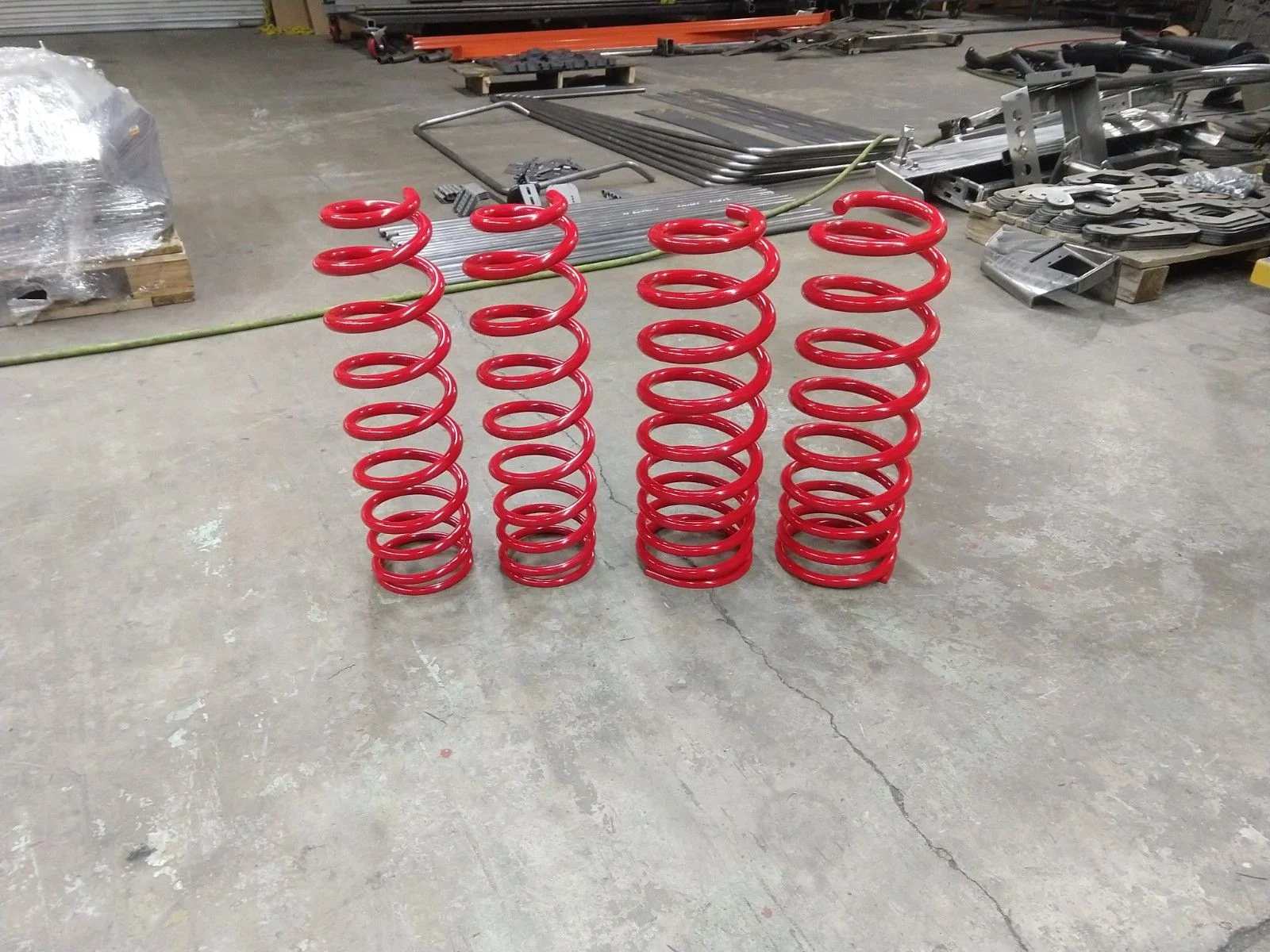

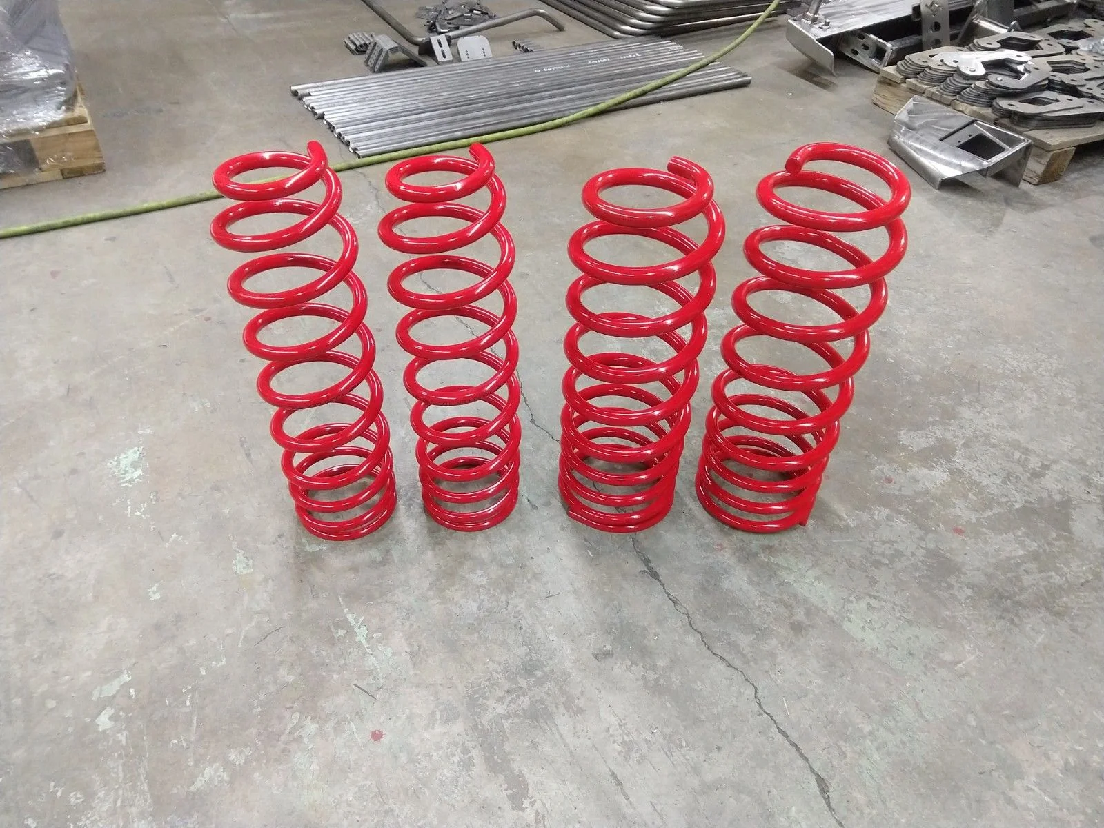

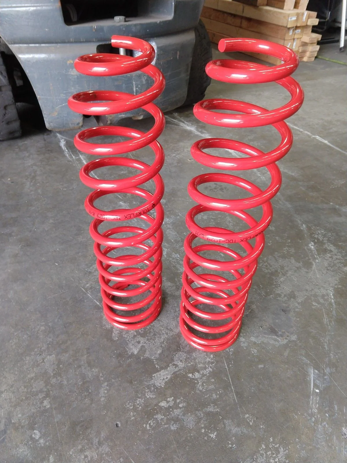

@TRAIL TAILOR can you post the specs for the different rate coil options for the 200?
REARS
TourFlex Coils (tapered pigtail wire)
*200 Medium Coil 560/545mm free height, tapered wire 13-18.5mm, 9.7 wraps 250/170#
*200 Heavy Coil 525/515mm free height, tapered wire 14mm to 19.5mm, 9.7 wraps 320/180#
Standard Tough Dog Coils
*931L-- 475/445mm, 7.2 wraps 18mm wire 240#
*931HL-- 455/425mm 7.2 wraps, 19mm wire 275#
***931AV--470/460mm 8.3 wraps, 21mm wire 420/330# (not stocked- special order)
***931AVHD--470/460mm, 8.3 wraps 22.4mm wire 650/350# (not stocked- special order)

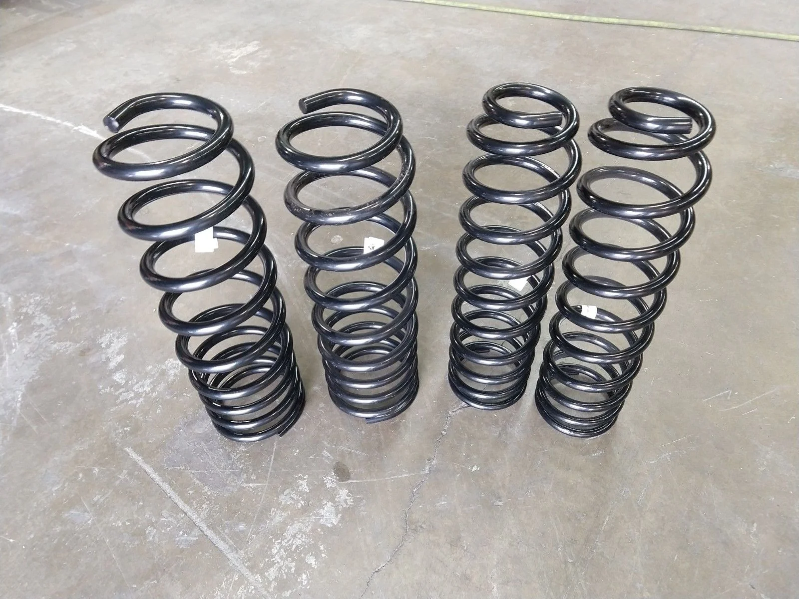

J what are the rates of theses coils?
1" Coils
FRONT:
TDC948SL LH-490 RH-480 (16.5 wire) 10 wraps
REAR:
TDC949SL LH-490 RH-470 (17mm wire) 8.8 wraps

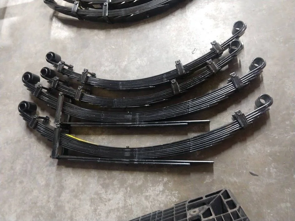

We'll see where it goes. Cruisers are my main focus for fab, etc.. But if it's throw it on the shelf item like the suspensions with a little tech I'm good with it.
Tacos are not an Aussie model. So we had to do some testing to get the front struts and rear shocks were we wanted them. I'm working with TD now on a rear leaf pack, but most of the newer Tacos can simply buy an AAL and get to 2" in the rear pretty quickly.
