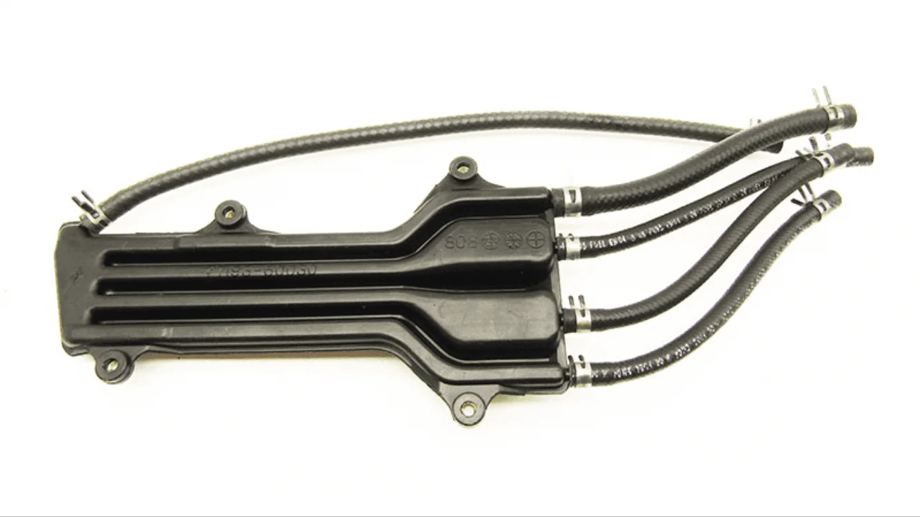

The tank itself has several vent tubes in it so the tank isn't the issue. Tank won't vent if gas gap is screwed on. There's a contraption behind the right rear side panel called the vapor separator .
Thanks. Gas cap is out (it was AM anyway). Does the vent hardline go to the vapor separator? Maybe they plugged it back there.
Probably a problem here. It’s located near the fuel filler. There’s a protective panel under the truck you can remove to access it.
I'm glad you mentioned that panel, Thanks.
I know where it is but I was about to disassemble my interior to get to it.

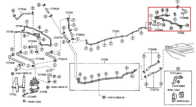

evap-system-jpg.346327
Mine had several cloggs from some insect. I used some bailing wire on my cordless drill and then was able to blow them clear with an air compressor. Before I did that, my tank would whoosh opening the gas cap because of vacuum.
I wanna know how the bugs got in there. The clogs were made of plant material and sticky resin like substance.
Anybody have an idea what this part is intended for? It appears to just be a loop of hard line that goes across the body and back.
I am able to blow air from the junction under the vapor separator forward.
I am not able to blow air from the firewall backwards.

To OP, maybe try using moabyte's method of baling wire - from the firewall vent tube rearward?
After several unsuccessful attempts to push compressed air and bailing wire from both ends, I ended up removing the hard line.
As I was cleaning it, it split in two. Looks like there was a hairline crack about half way down, and over time gunk had accumulated something fierce.
