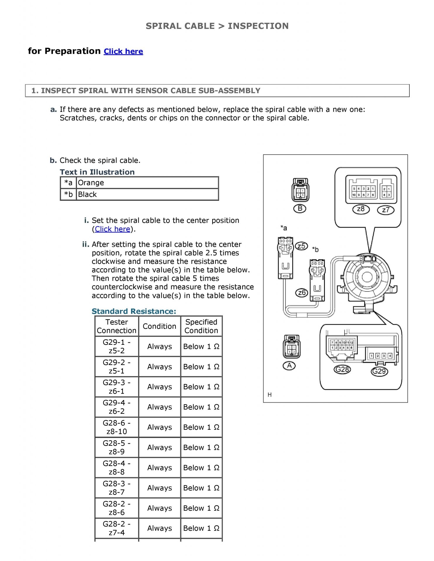

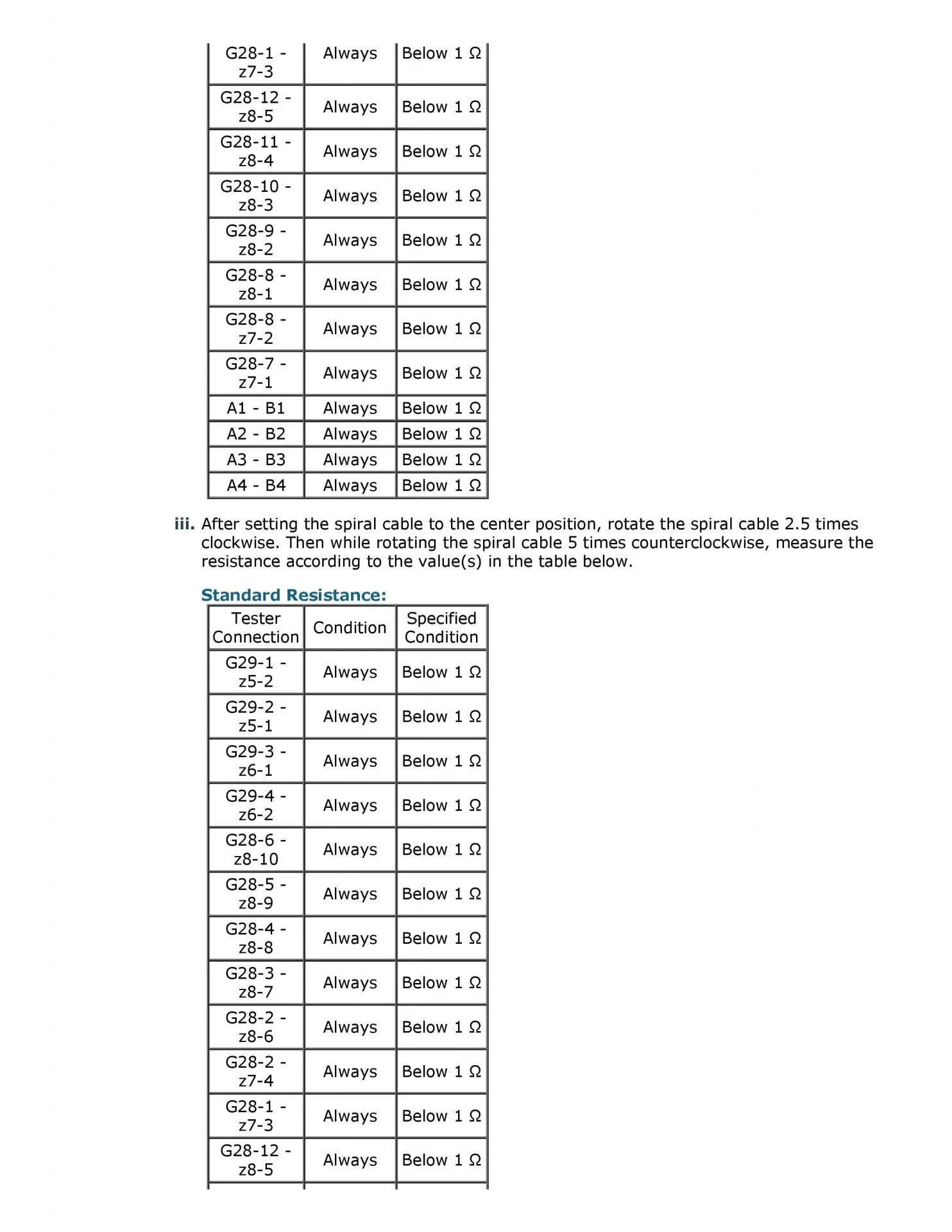

Has anyone replaced their clock spring. I’m Surprised mine went out at 41k miles (2015 GX). I haven’t taken it to get looked at yet but I’m pretty sure I’m diagnosing it right.
Here are the symptoms:
1. None of the steering wheel buttons work
2. Horn is INOP
3. Cruise control INOP
***No ABS or traction control lights are on.
