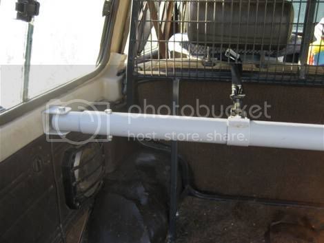

For the earlier 60's we have to install a 'Crab Bar'. I have one in mine;
