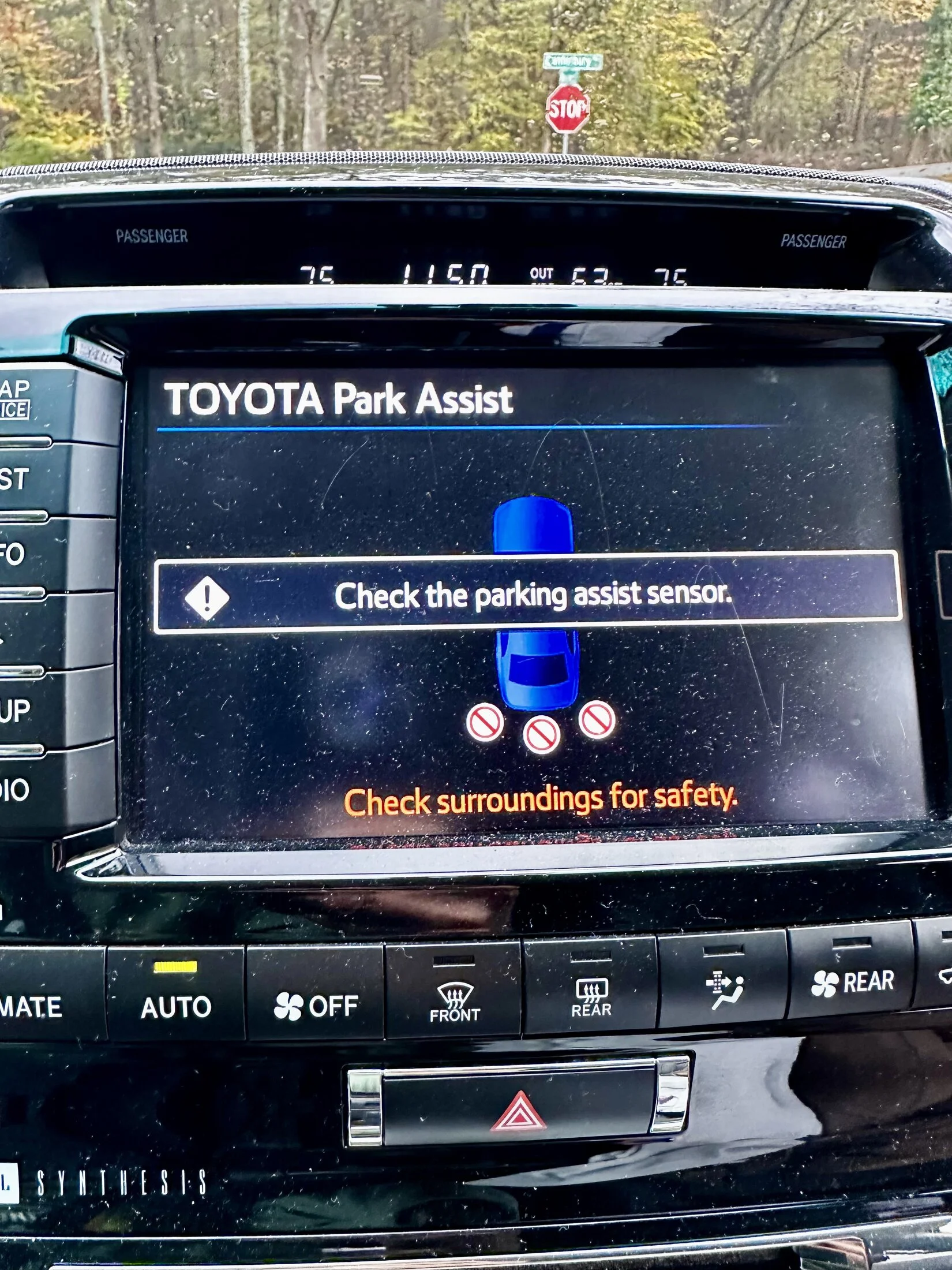

2014 beeps and shows the message to check sonar system when I press the park assist button. Shows to check the rear? Is it as simple as the sensors going bad or is there anything else I need to check? Thanks in advance.
all 3 going bad at once is odd, but not impossible IMO. Is your rear bumper filthy? Did your anything affect your sensor wiring? I don't have an idea how to troubleshoot that last question though.

Thanks for the reply. I have tried disabling the dash button and that didn’t work. I’m going to try and clean the sensors? My next step is to be very careful checking the cable that daisies them together. Is this cable located in the center? Thank you.
