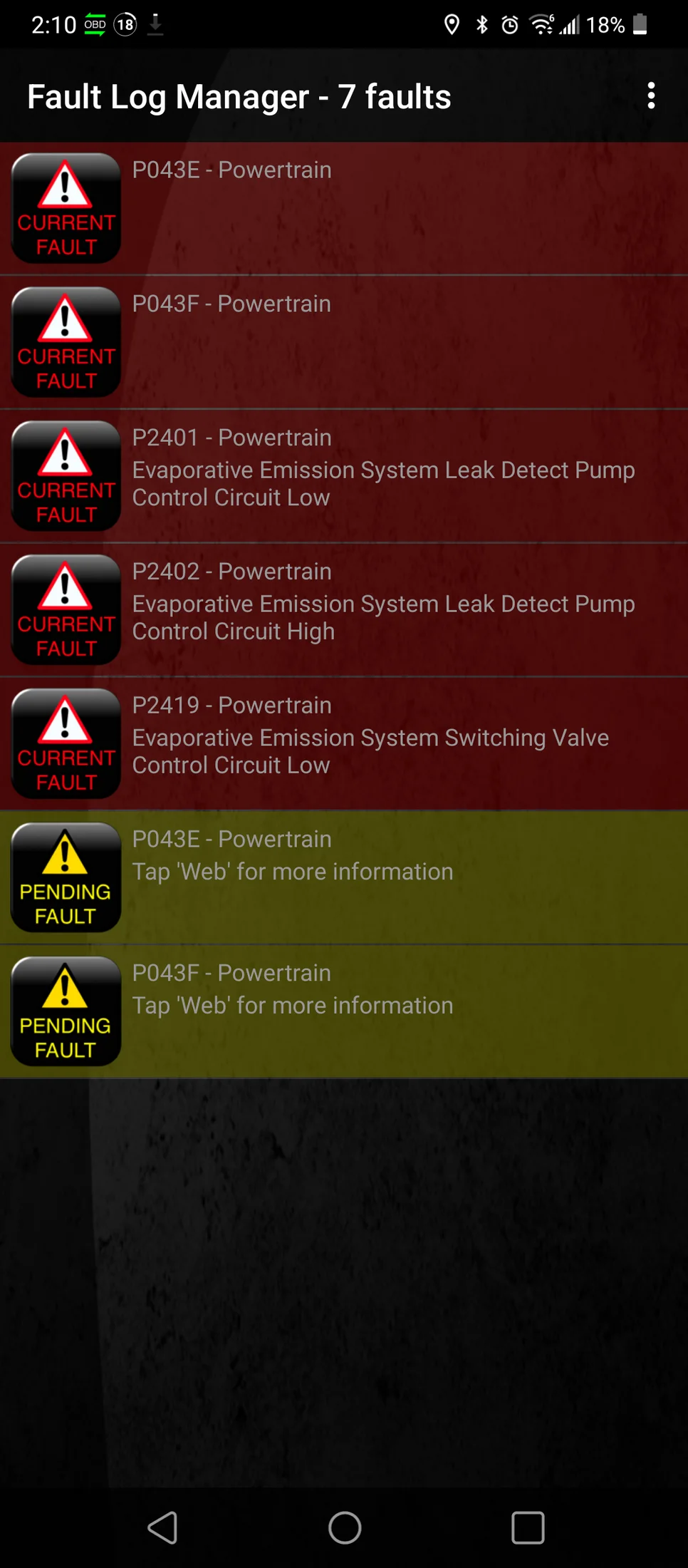

Got the dash lights on and the following codes: p043e p043f p2401 p2402 p2419
I can reset the codes and they stay off while im driving, but they come back the next morning after the car sits overnight.
Found a toyota service bulletin that this means i need to replace the charcoal vapor cannister. For 03-07 the part number is 77740-35530

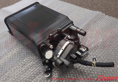

Im also seeing the 08-09 part is different (77740-35531) and more expensive than the 03-07. Lucky me!
Holy smokes these things are pricey, anyone have any advice on a decent affordable aftermarket?.
Amayama has your 77740-35531 for 297.72 and approximately 100 bucks shipping. Might be as long as a month to receive it though. The good news is they’re reputable. That’s directly from Japan.
