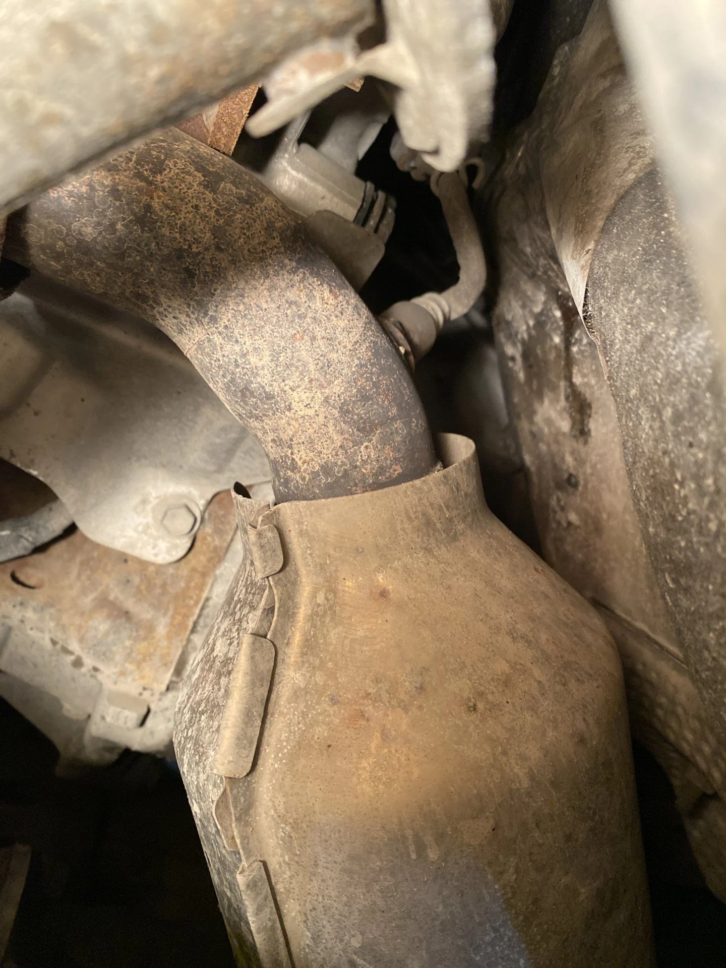

So I’m changing (or trying to) my DS upstream sensor. 2005 Gx.
Check out this photo. The sensor is 160 degrees hidden in the back side of the exhaust pipe.
Take a look at the picture.
How did you guys access the sensor to take it out??
Also - how critical is it if I only want to replace bank 1 without the coresponding bank2 sensor? Can I get away with it and save $305 bucks?

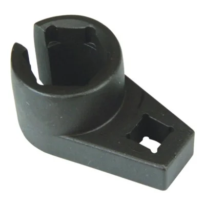

I used a tool similar to this and positioned the "ear" where the ratchet extension goes to the side of the pipe. Then placed an extension into the tool from the bottom. Once it moved a few degrees I was able to remove it by hand.

I went through the D/S fenderwell with a similar tool @CarolinaGX posted above and a flex head ratchet. Took about 10 minutes to change. Piece of cake.

1. Absolutely a requirement to use the tool pictured
