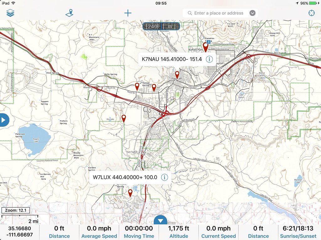

Does your Gaia waypoint file include the freq for the noted repeater?

Yep, see the screenshot below. There is a free RepeaterBook app. All of the data comes from that website. This is just a nice visual representation. The better radios will automatically set the required offsets. That app shows you repeaters near you by distance but not on a map. Really that is should be good enough and the data is stored offline in the app which is nice.
I can't answer your Baofeng question. I don't own one of those radios.
and now for the screenshot....
A couple around Flagstaff.

Keep in mind the Baofeng is a commercial radio and as such it doesn't have some of the amateur radio features, such as automatic repeater shift (ARS). So it will require some extra effort when programming, whereas the amateur radios will make assumptions based on frequency coordinations, band plans, etc. For example the repeater shown above, 145.410 mhz, has a negative offset. The amateur radio will assume this, the commercial radio will not.
