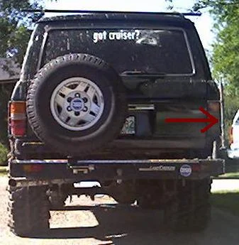

Mine is mounted on the Driver side behind the rear wheel. I would imagine it being a problem if you like to squeeze through tight places.
Edit: updated picture - I went the ham radio rout and now use the CB mount for my 2 meter radio antenna
