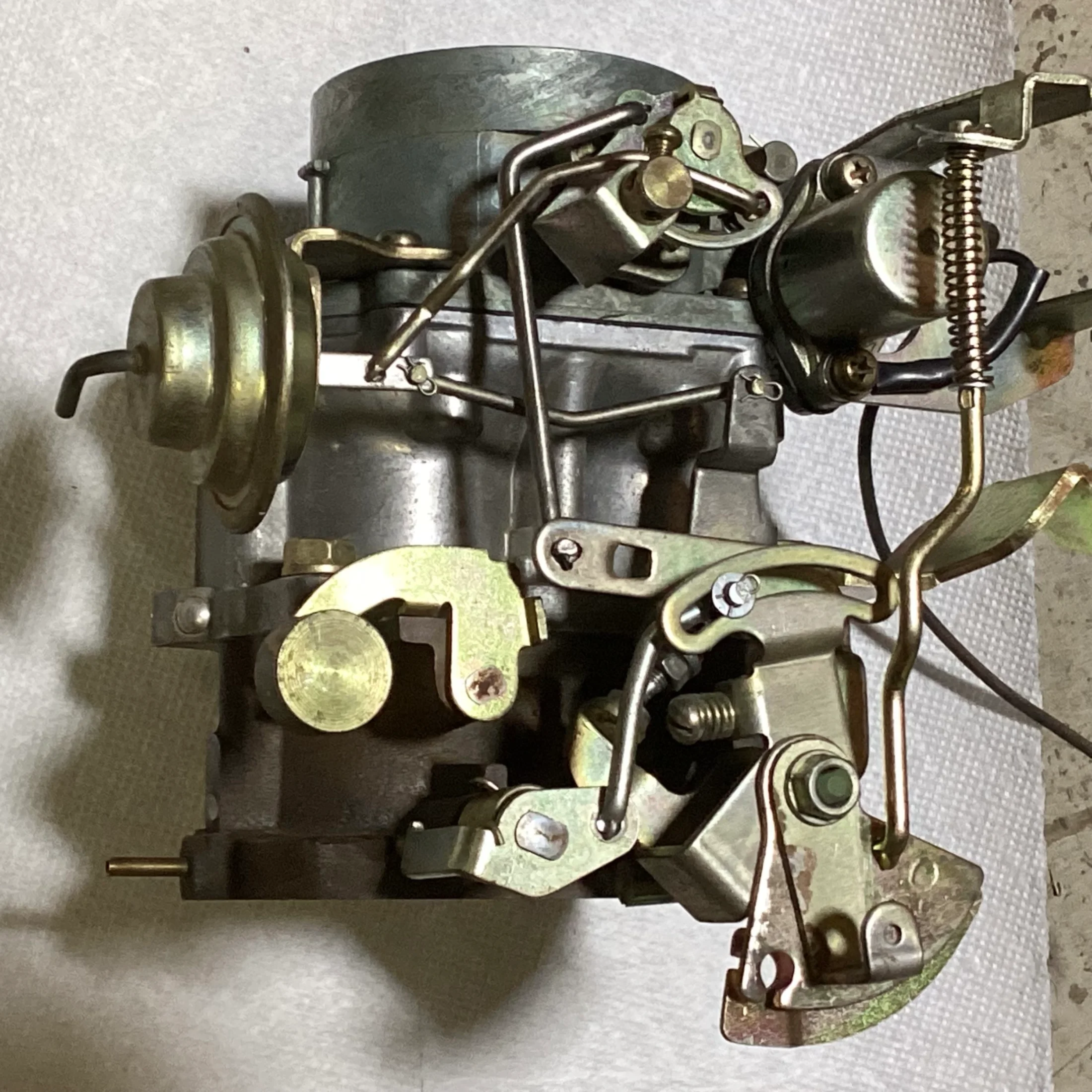

I thought about returning it to Cali-spec, as I have all the parts on hand to do so. But there isn't a lot of call for 1974 Cali-spec carbs. So I decided to finish the retrofit, in a way only I can. I opened the unobtainium vault.

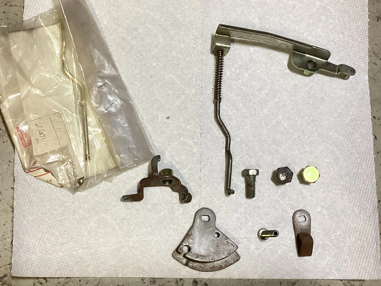

Locating the fuel bowl hardware was easy. Same for the Throttle Positioner. I looked in the box of cap screws and found that I still had a couple of NOS ones. I got a little stash of NOS belllcranks from the middle east recently, and I knew for sure that I had an NOS lift rod in the vault. So it was time to have some fun.
