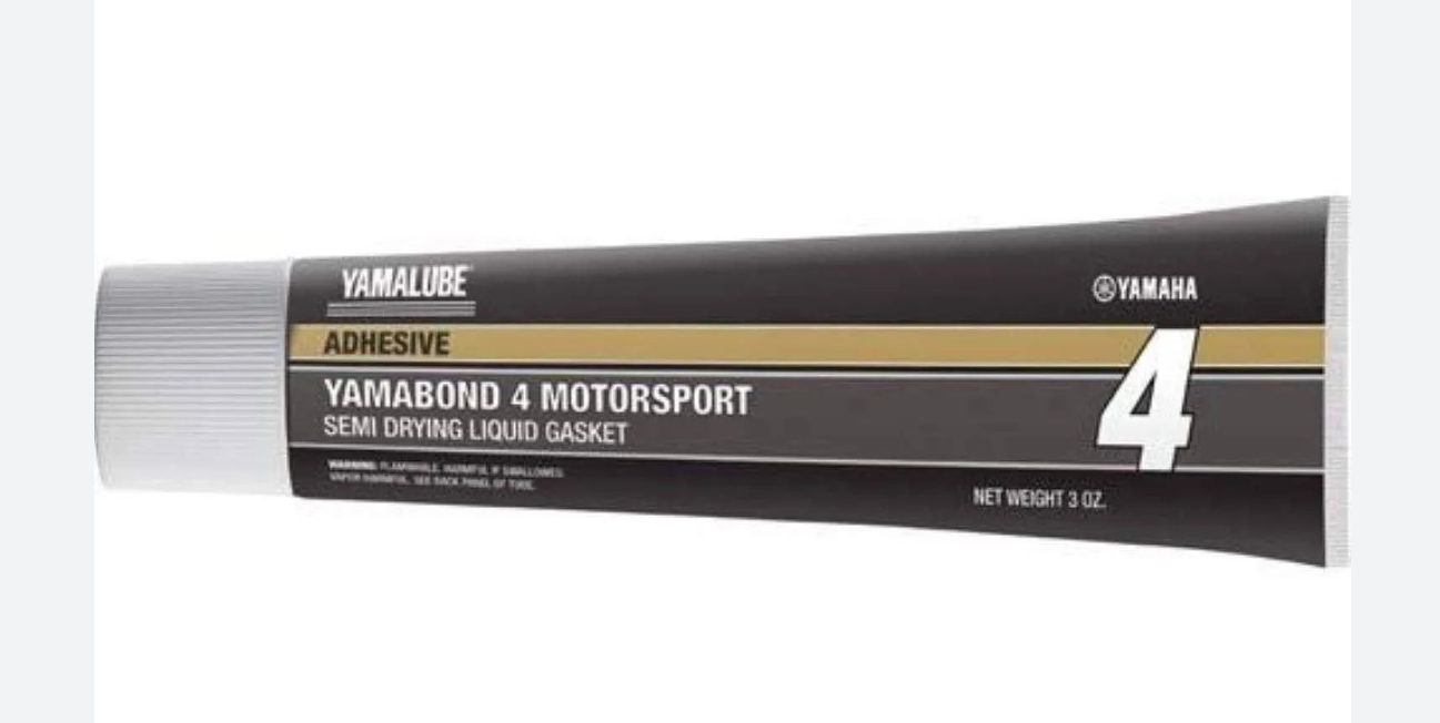

A proper liquid gasket could last a long time. I wouldn’t suggest an rvt type.
Or you could cut one out from gasket material.

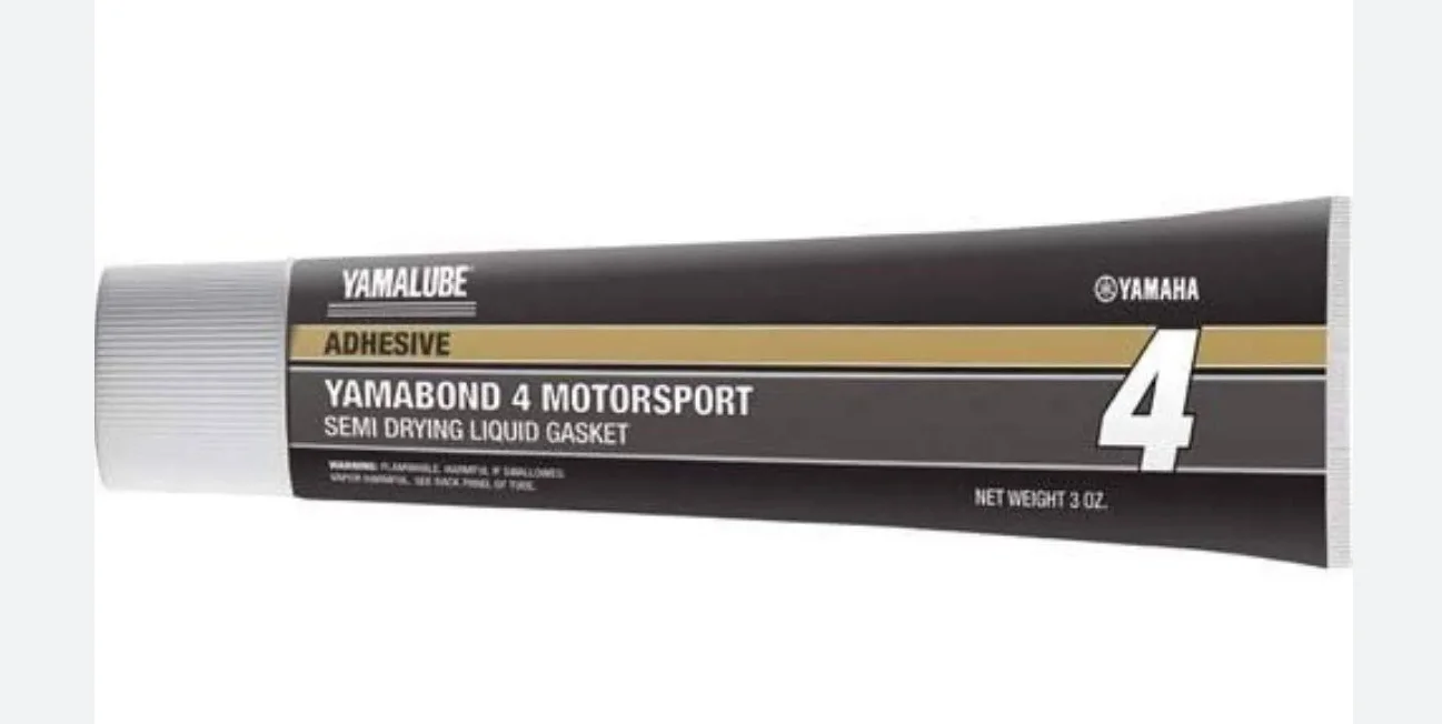

What liquid gasket do you recommend? I need to have it done in the next few days for a car show
Will this cause a big issue?
Probably not. If it's a small tear I'd just approximate the edges and screw the top on.
Get the correct gasket with a rebuild kit soon.
This would work well until you get the correct rebuild kit.
