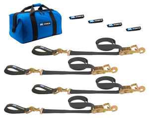

When it comes time to buy straps / I really like the ones that just go around the axle tube and then you put the rachet part on. This is a nice kit...
The reason I mention that is to make sure the trailer has the hoops/tie downs to match the straps / system you want to use!! (Mine just have the square boxes for putting in the wooden walls. I make it work, but hoops are nice!)

I like the strap kit you pictured...looks like all I would ever need - got a link?
