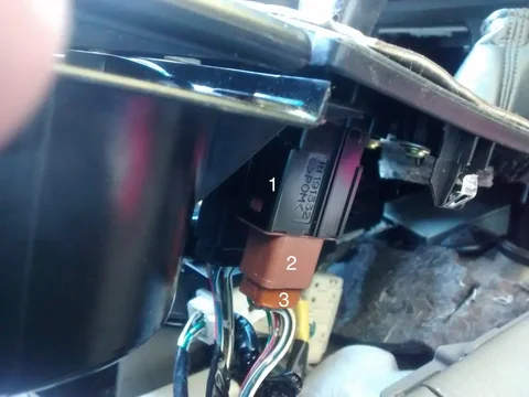

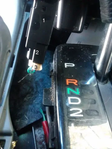

I'm a visual person, so I took pictures of the plugs and labeled three zones where I could potentially pull. i believe it is point 3 based on the FAQ language, but I can't budge it even though I'm pulling hard. I'm afraid I'm going to crack this 13 yr plastic. Can someone verify?

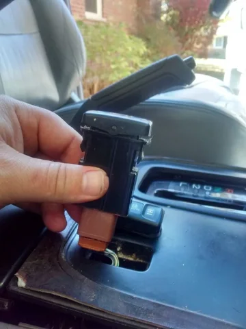

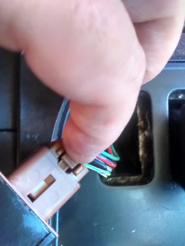

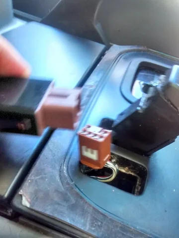

Ok, after posting pics I starting playing around more. If you push up on the switch it will come up through the top. Then you can pull it and see the whole assembly. That is when you'll see the push tab. Here are pics for those visual learners.
