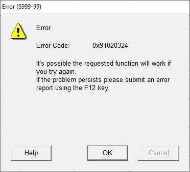

I have just setup techstreem, every thing is working fine except reading AHC DTCs. I am even able to see Hight and AHC pressure readings. exactly like the issue (same error code) in below thread.
forum.ih8mud.com
OP is saying (I’ve read (blinked) out the DTC’s as per the FSM. Then I’ve cleared them as per the FSM manually. Now Ts works fine.) any idea how to do that?
