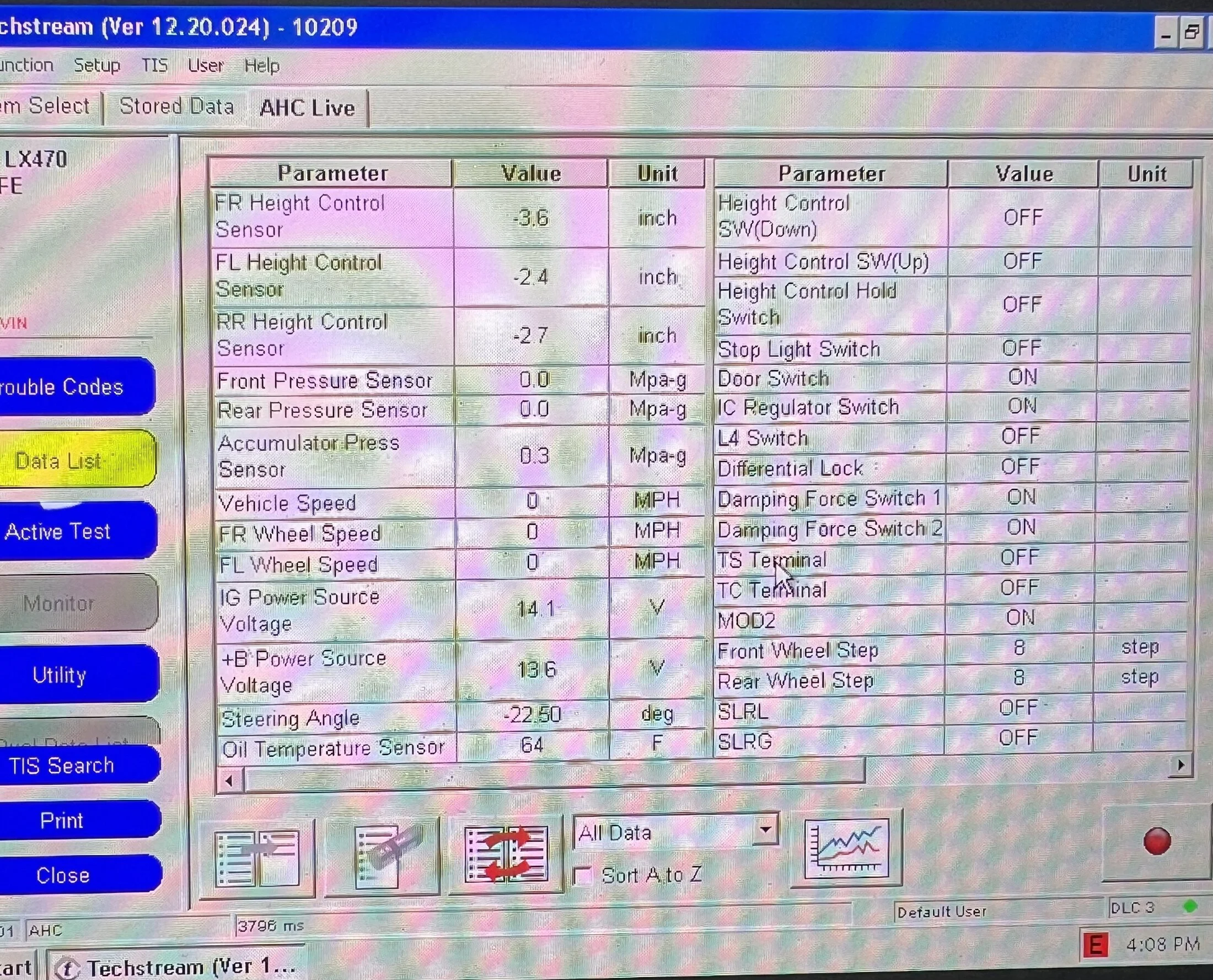

I thought I may have blown a globe last winter but the car stayed at N and I kept riding it. About a month ago, I got the blinking off and set to L.
Last night, at about 0 degrees Fahrenheit, the truck suddenly went way down in the back.
I swapped my globes out with new ones from Impex a couple years ago, and promoted the price here. Has anyone else had any issues with blown Impex globes?
How dangerous is it to continue to drive in this condition?
Have you replaced the pump? My guess is the pump went out, not the globes.
