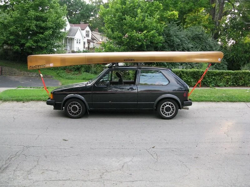

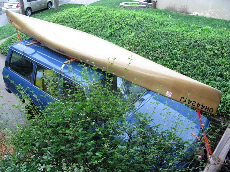

2 cam straps...that's it. I've used the little "bookends" but found out they were unnecessary. BUT, the tag end of the cam straps have to loop around the cross bar over the canoe and loop around the crossbar on the other side then back to the buckle. I always liked the buckle located near the chine so it wouldn't wobble around in the wind. No bow or stern lines needed.
before a rack I just used two blocks of foam and tied it down...with rack I just put the padded sleeves on front and rear bar of rack....tied two straps over body of canoe...then did a line from bow to bushbar...and one on rear from stern to hitch receiver....never a problem.

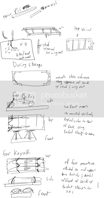

I have a brilliant idea i made up the other night in bed, just need to write it up and then build it. I will post pics of the desighn.
HEre is a super super rough idea i put together in paint.
its made out of 5 peices of 8' x 1" angle iron
and 4 pieces of 4' x 1" flat bar.
the rack and universal mounts for bikes and kayaks are all made from that material.
the mounts for the bikes or kayaks will mount in the rack and out of the way when not in use. They will mount via a bolt and wing nut and the yaks, and bikes are attached via rachet straps. the rack bolts to the rook cause i think rain gutter mounts are sissy.

brilliant! You could call that invention 'roof rack' :D

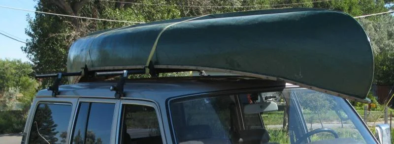

This might not apply, depends on how your roof rack is configured, I guess. Yakima makes these soft rubber gunwale brackets to fit their bar system. I use 'em to haul my canoe and they are ideal. These, and a set of ratchet straps, and we're off to the lake!
HTH

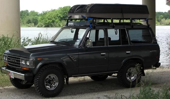

I am in agreement with Yakima load bars... although not 'clever' or unique they fit the bill and functional for various applications.
I initially mounted the high-rise towers (below) but have since cut them down and converted them to normal towers... no laughing at my platform please :o, I like to stand when fishing.

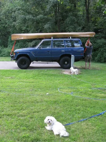

On the LC, I am using quick mounts along with wood load bars. For longer trips I use some rubber pieces to keep it from sliding around.
If you're worried about scuffing the bottom of the canoe, you can tie the straps around the thwarts, like in this picture:
