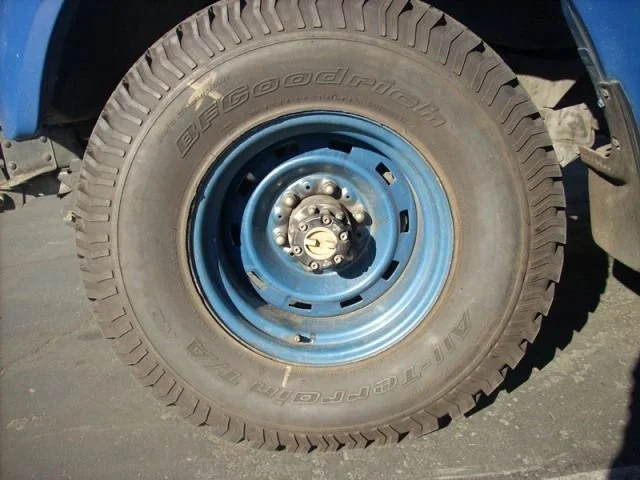

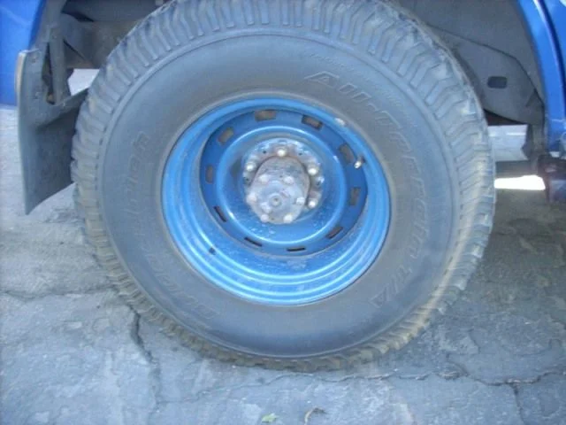

I’m putting this out there because when I bought my 60, the rims that you see in the photos were already on the rig. I need to find, or have made, an identical rim for my spare, so I want to know if this is some sort of OEM Toyota rim, or (more likely) a custom made rim. Here are the specifics:
Rim size: 15 inch
Rim Width: 8 ½ inches
Rear Offset: 3 inches
Front offset: 5 inches
If it helps in identifying these rims they are steel rims, standard Toyota bolt pattern, and 32 X 11.5 X 15 BFG All Terrain tires are mounted on each rim. What do you think? :hhmm:
i believe those are a generic gm or other company's steel wheel or something similar. I see many like this at the local tire store being thrown away. I am guessing they have been painted blue
your spare will only be used in emergency situation, so i dont think it doesnt really matter what your spare is since you are likely to only ever use it in that emergency case...my spare is a stock toyota rim with tsl tire and i dont even think its the same size a what i run on my truck
gl
Local tire stores actually have to pay to get rid of them. check around and you might get one for free
Late 60's early 70's Chevy Slotted Rallye rims, stock they came with a chrome "beauty ring" around the edge and a chrome center cap
Yep. I had some on my Scout (5 on 5.5" obviously).
I think the "proper" name is Chevrolet "Rallye" or "Rallye II" wheels. Depending on who you get info Rallye is spelled a few different ways. IIRC there are two different Rallye wheels - one has the holes like you've shown, the other has less, larger holes. Can't remember if they are the same slot style hole or not.
HTH
Jeep had 6 on 5.5 bolt rally style rims on their pickups back in the late 70s to early 80s, could be Jeep also. But they do look like Chevy rally rims.
