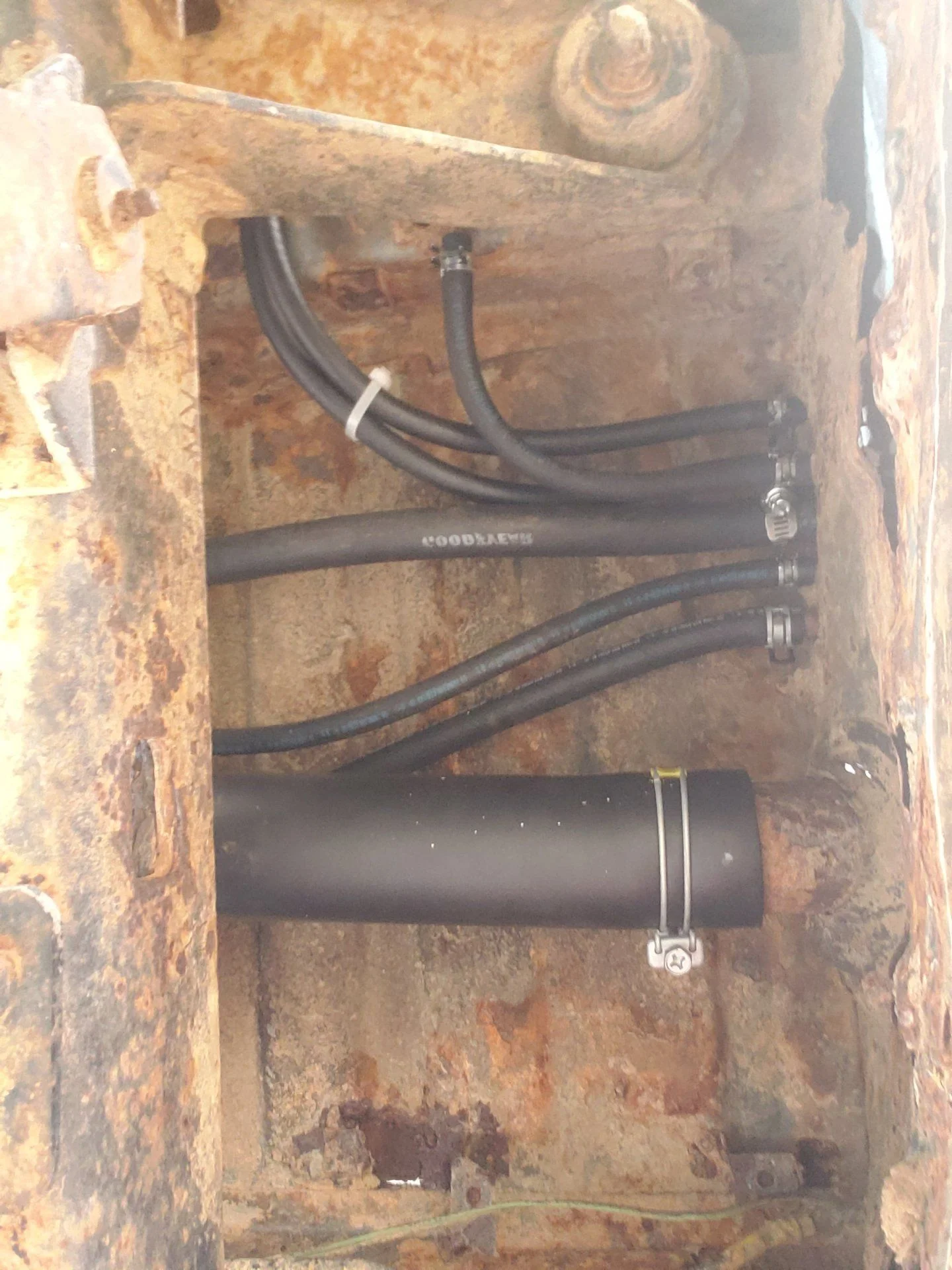

Rather than blow up Onur's tank thread any further, I'll bring the tank saga into this one. In summary, the tank "is ordered", but there's some red tape that needs cutting. The project is at a standstill until the tank recall is completed.

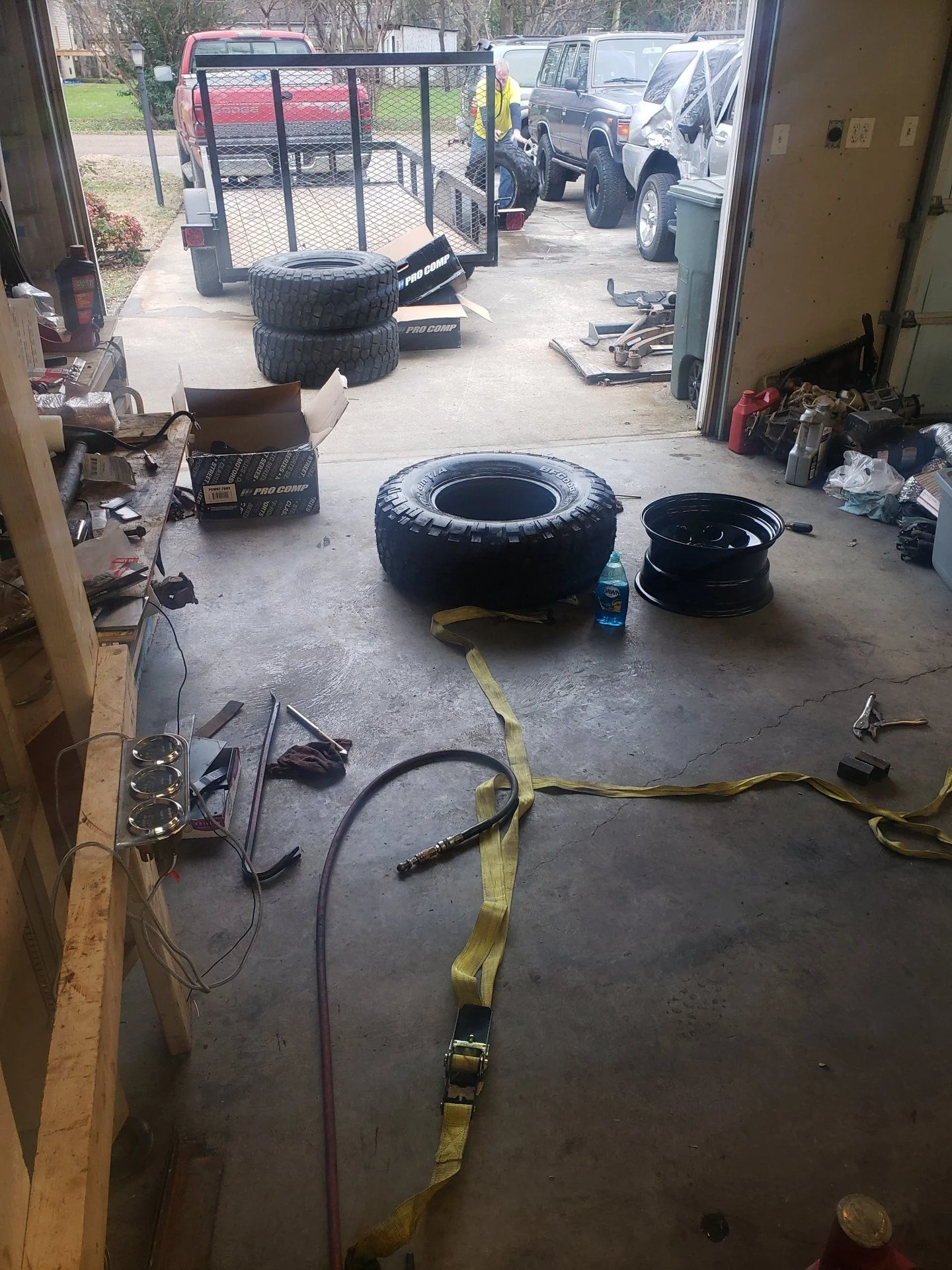

The old tires had advanced from may-pop to will-pop-at-any-time status thanks to the miles I'd put on 'em. Marketplace provided a set of 35" KM2s with ~40% left that will do the job until the budget supports the jump to 37s. Tire shop was closed, and dad was around so we mounted the KMs up the old way. I'm glad I did it, but it's not worth the savings.
No after pics?
Here ya go, Cole. I much prefer the black sidewall. For the record, 4.25 backspacing is too much to wheel with. It'll street ok, but the inner sidewall is gonna get all into the body when it flexes out. I've got plans to mitigate that problem.

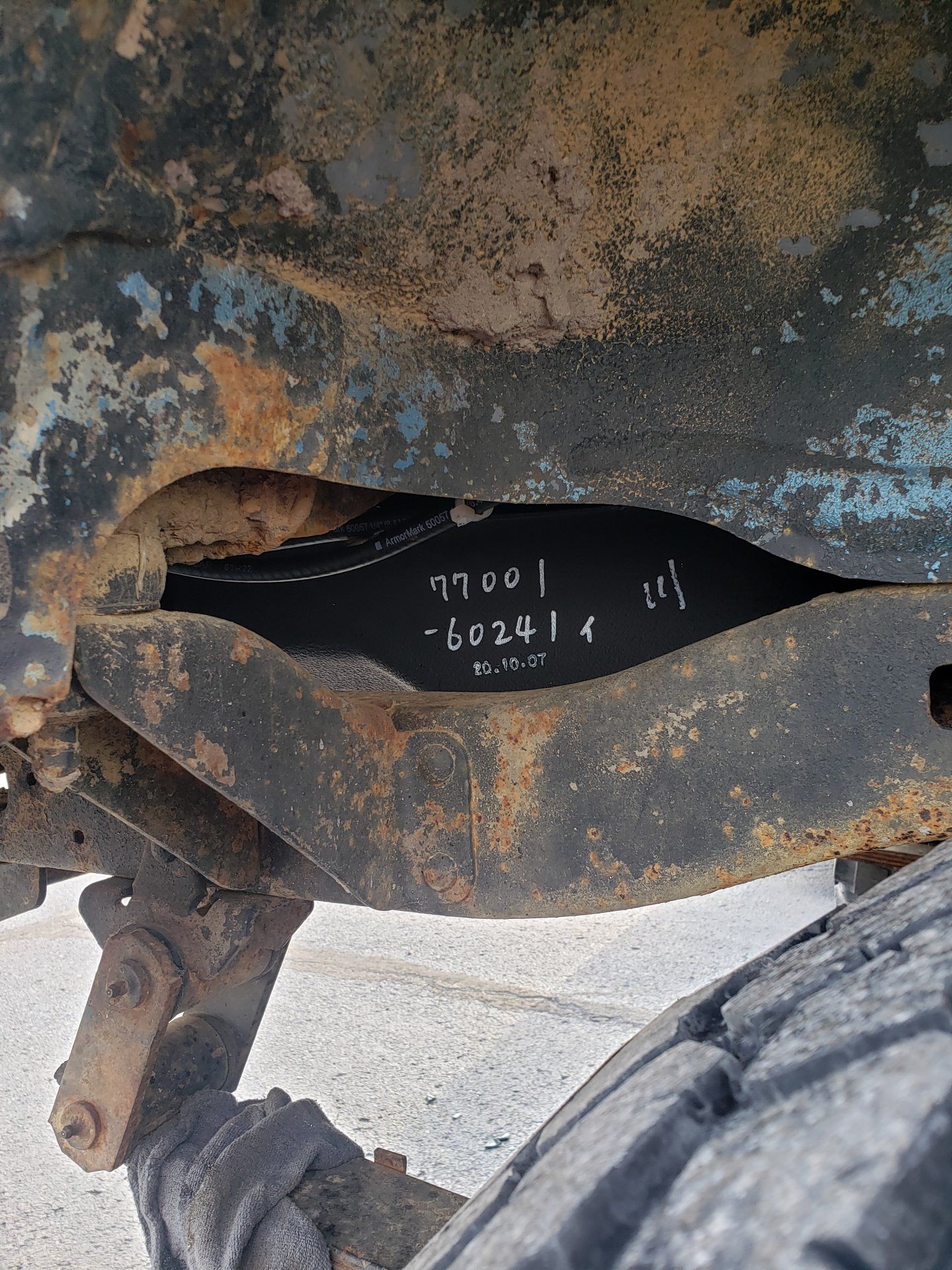

It took three dealers, but the truck goes under Mr. T's knife next week. Tank replacement service scheduled for Monday/Tuesday. We'll see how it goes. We're lucky to have so many dealers within a reasonable distance. I feel for you folks who are stuck with one awful dealer that you have to travel to reach.
Hot damn, ladies, we're in business! Three business days from the first call and it's complete. Thank you, High Country Toyota in Scottsboro, AL!
Invoice attached for posterity's sake.

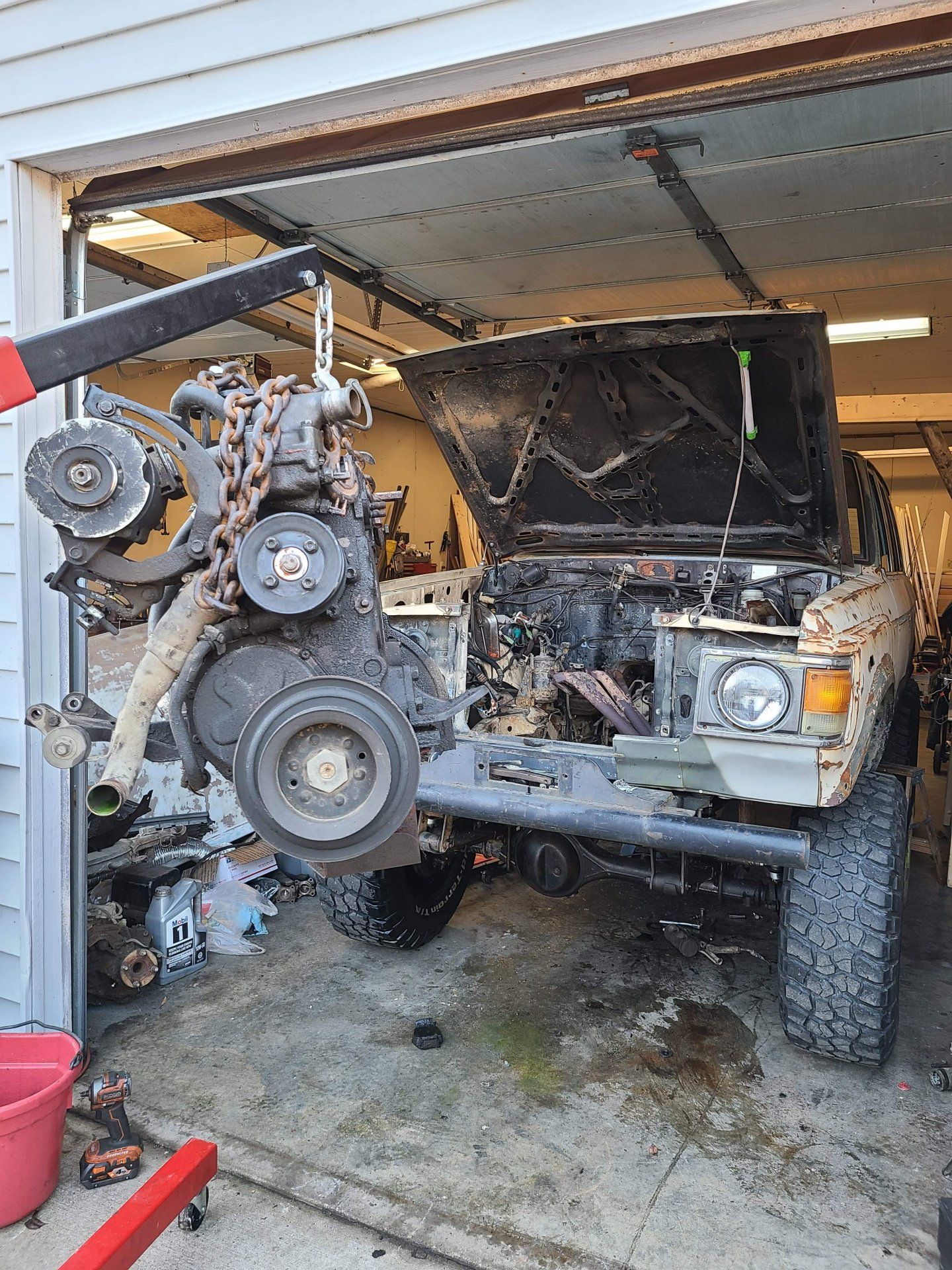

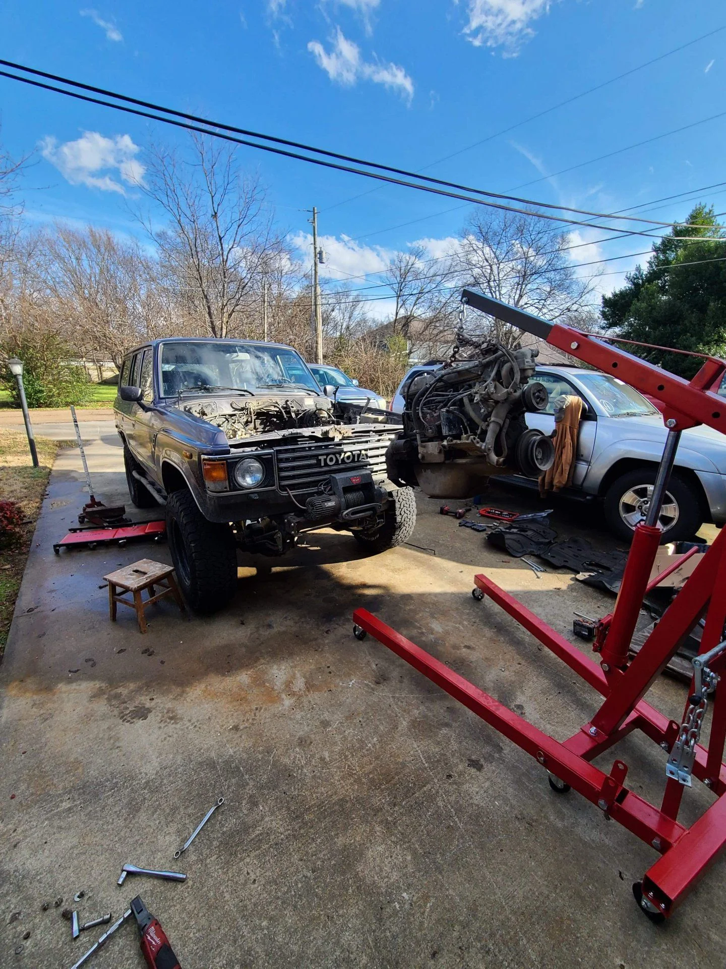

More progress. One engine out. Old girl was tired...pre-removal compression numbers showed 100psi as the highest, 70psi at the lowest. I'm amazed she drove as well as she did.
Football has interrupted the other pull. Roll tide.
Donor donation complete.

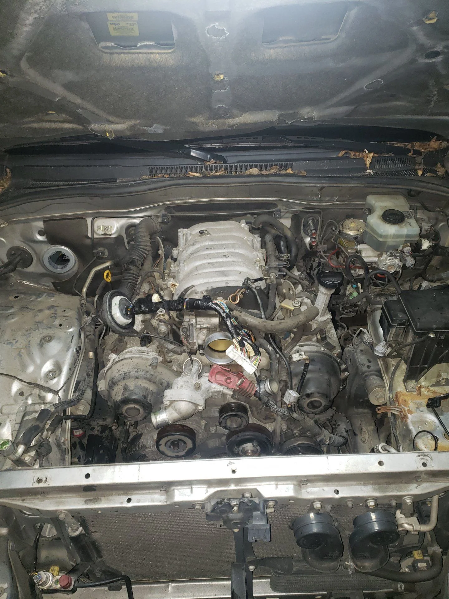

-Yank the donor UZ this weekend and mock it up
My project cup over floweth. Wish me luck.
Prep is done. Donor is a few bolts shy of giving up the goods.

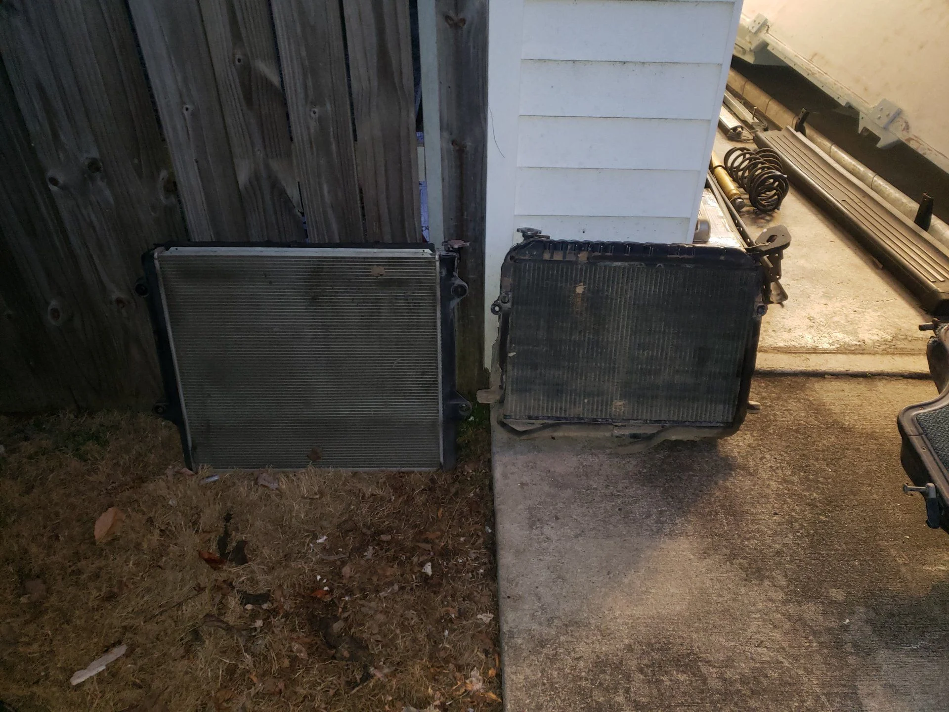

Couple things I noticed in tearing this 4runner apart.. these rigs seem like they're begging to be truggy'd, and holy crap at the radiators in these things...
