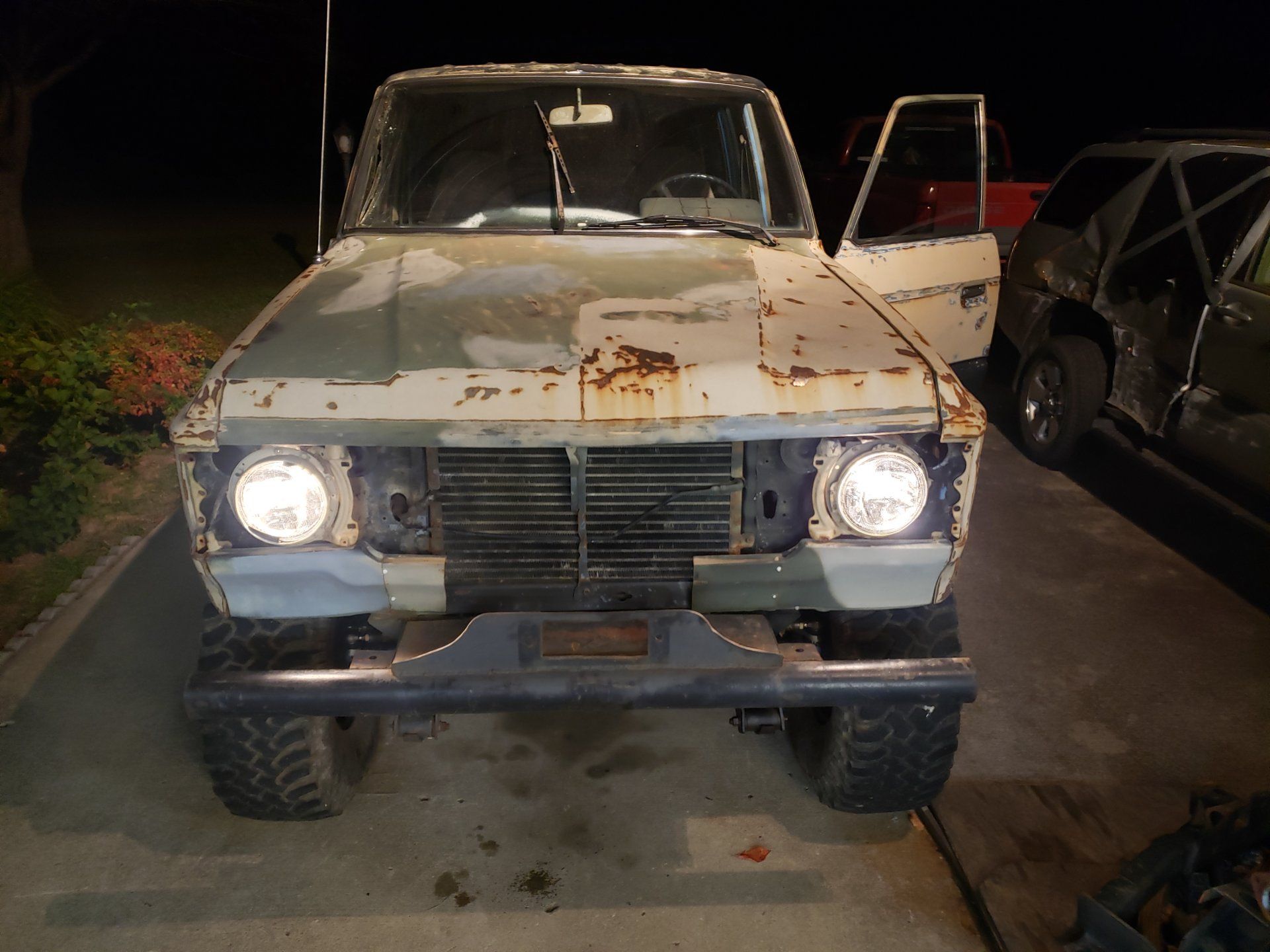

All the lights were DOA. Got that fixed.
Found a fair bit of burned wiring thatll need replacing to get other circuits back. 30 amp in a 7.5 radio? Thatll work... no copper left in that burned supply.
Thanks, @Bama4door, I might be interested. I'll see how this 8274 fits my cut up one first. I'm probably going to have to start from scratch up there, and if so, that grille may come in handy.

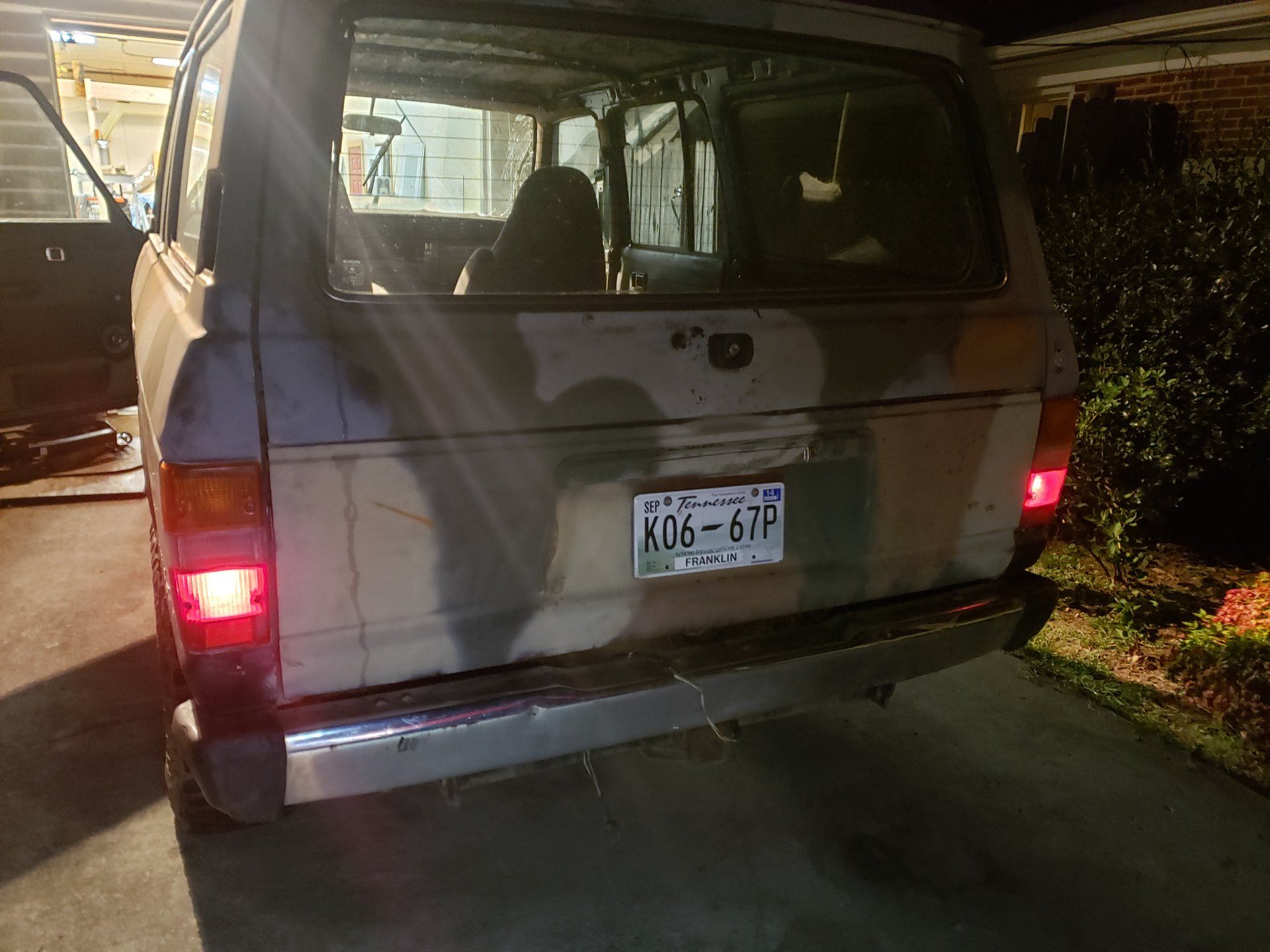

Small battles... now it has all reqd lights and a slight face-lift.
Might get it tagged next week... we'll see. I'll need 7 smart-ass digits to put on the tag, or else its getting the el cheapo antique plate.
